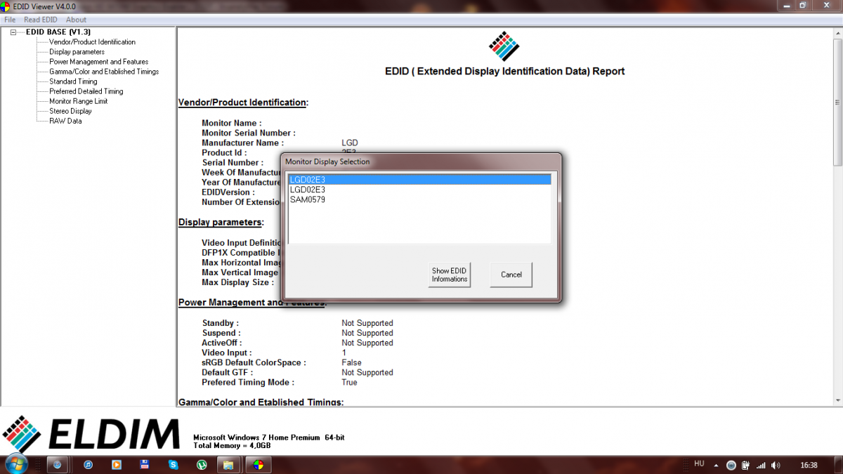

Hmm, injected property name is "AAPL00,override-no-connect".. Judging from this name, I suspect it might inject EDID only in case system can not automatically get one. In your case it gets it without a problem.
Have you tried Clover bootloader and InjectEDID=Yes + CustomEDID keys? I don't know how this injection works in Clover, but surely not through DisplayProductID. Maybe it will overwrite your original EDID this way. However, screen didn't work for me, even with the same wrong EDID injected through Clover.
I tried Clover, but i haeven't figure it out yet, i need to read some documentation for it, anyways it didn't even booted with it so i quit. Any suggestions?
Edit. I also tried naming the package "AAPL01,EDID" and "@0,EDID"
Edit 2. I just found this in other page "@0,override-no-edid", i will give it a try.

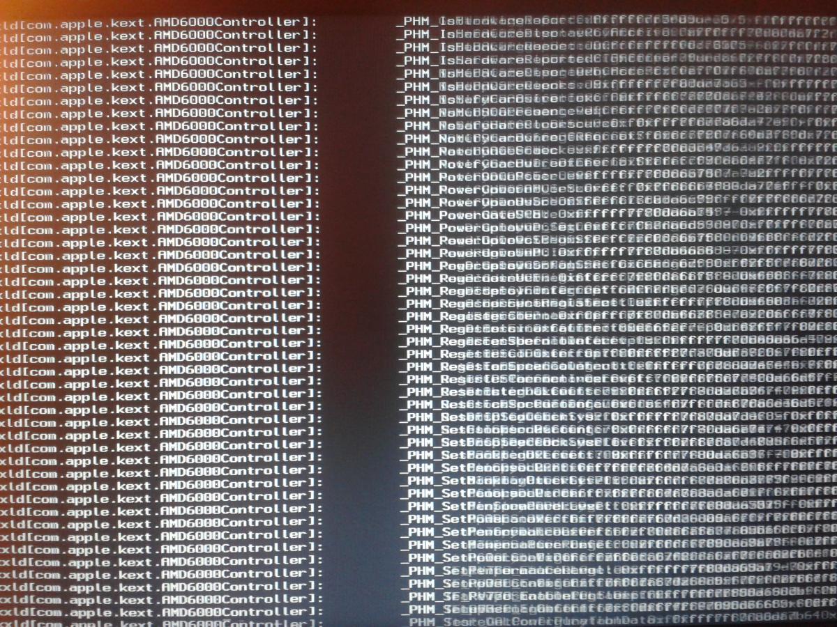

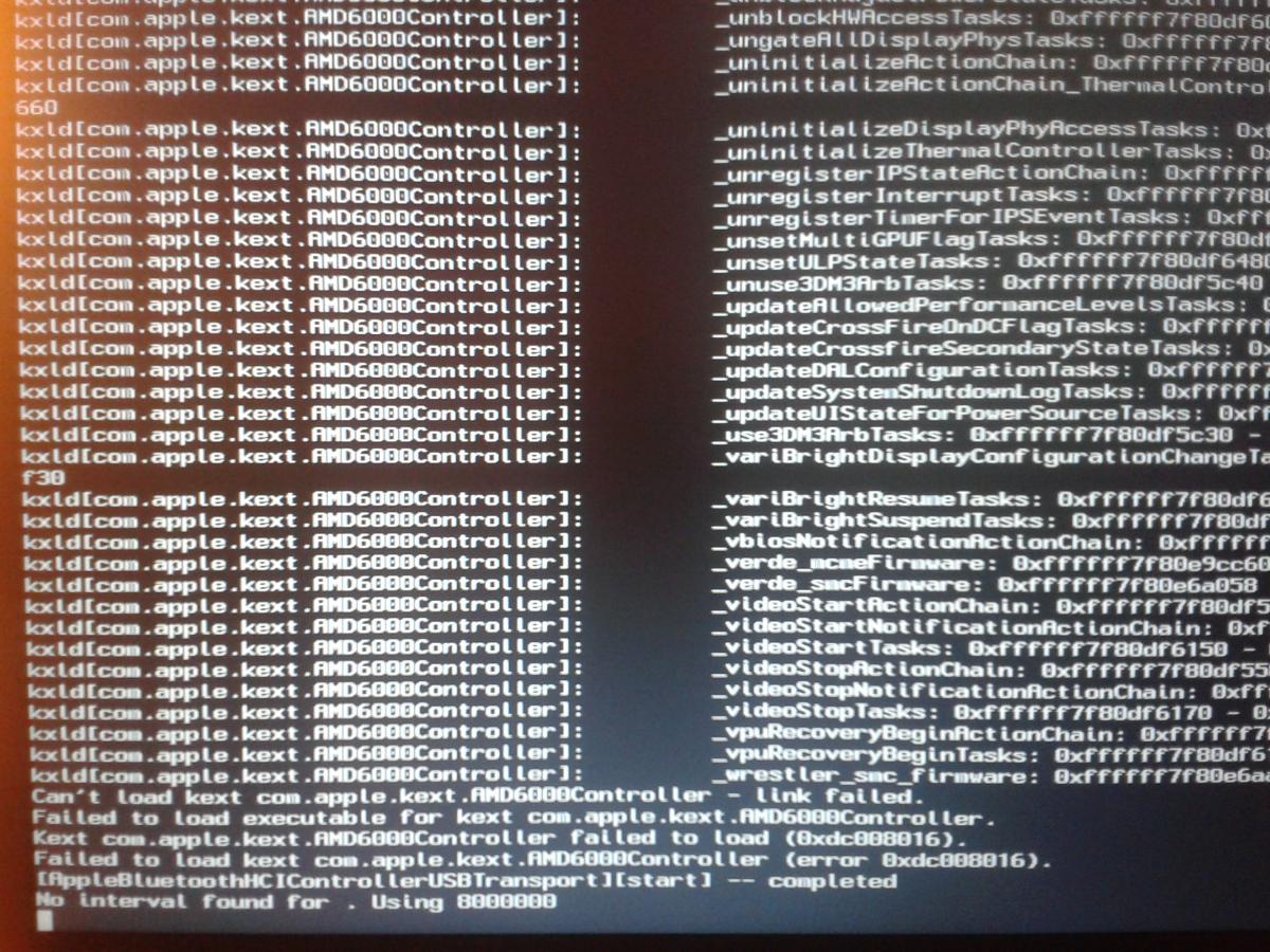

okay i try this one out but it will take a little time i have to reinstall os x and i have to change HDD (because i have different hdd for os x and for windows Till OSx became fully working on my device)
I kinda blind patched the 10.8.3 kext as I didn't have the correct Pithecia offset, i did searched for match with Pithecia"s original connector info, but maybe I patched wrong framebuffer (or something else, that's why the kext is not loading). Install xcode and run ati-personally.pl to find the correct offset in 10.8.3, I am running 10.8.2 without xCode atm.
