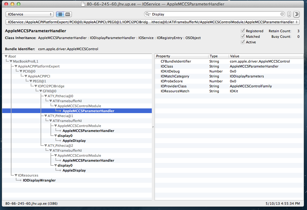

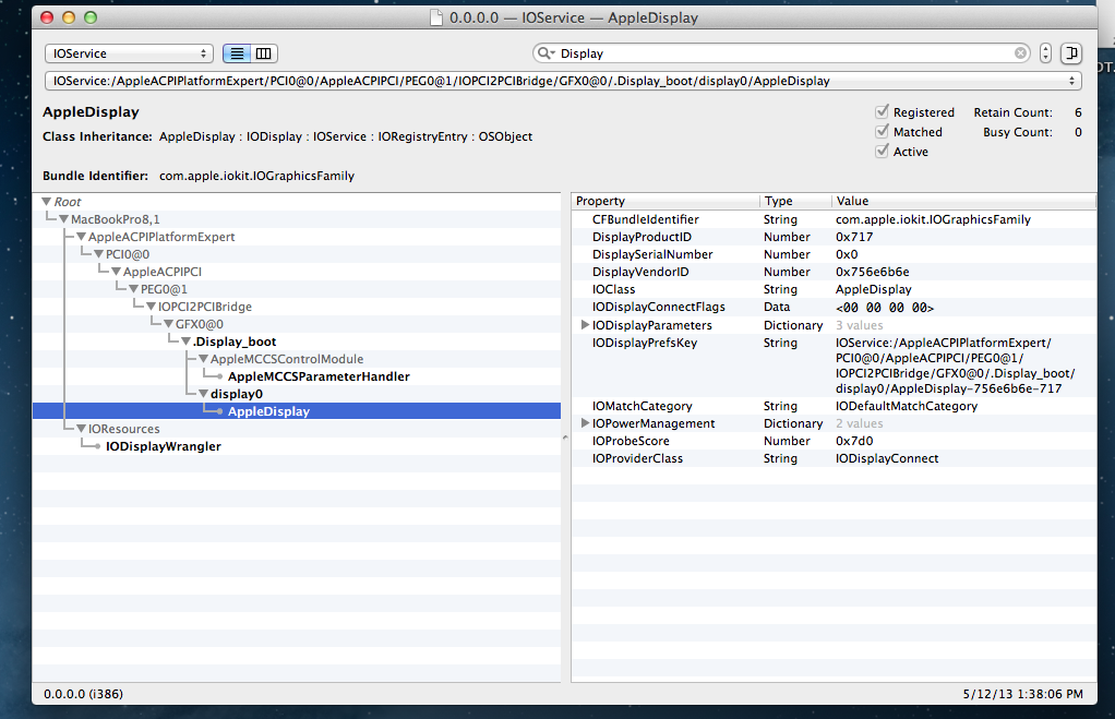

Trucker MK Posted May 12, 2013 Author Share Posted May 12, 2013 Well something did changed, your LVDS Display is now somehow detected  Before Link to comment https://www.insanelymac.com/forum/topic/277042-amd-radeon-hd-6650m-graphics-enabler-dsdt-hdmi-audio-acer-aspire-7750g-2674g50mnkk-gradients-fixed/page/14/#findComment-1914483 Share on other sites More sharing options...

Trucker MK Posted May 12, 2013 Author Share Posted May 12, 2013 DSDT.aml.zip Try this and get back with ioreg again. Link to comment https://www.insanelymac.com/forum/topic/277042-amd-radeon-hd-6650m-graphics-enabler-dsdt-hdmi-audio-acer-aspire-7750g-2674g50mnkk-gradients-fixed/page/14/#findComment-1914486 Share on other sites More sharing options...
Tauio111 Posted May 12, 2013 Share Posted May 12, 2013 Here you go. Edit: I noticed that VRAM,totalsize is <00 00 00 80> I think it should be <00 00 00 40> because I have 1gb of VRAM. 0.0.0.0_2.zip Link to comment https://www.insanelymac.com/forum/topic/277042-amd-radeon-hd-6650m-graphics-enabler-dsdt-hdmi-audio-acer-aspire-7750g-2674g50mnkk-gradients-fixed/page/14/#findComment-1914487 Share on other sites More sharing options...
Trucker MK Posted May 12, 2013 Author Share Posted May 12, 2013 Are you sure that you used the last DSDT.aml? Â Here you go. Edit: I noticed that VRAM,totalsize is <00 00 00 80> I think it should be <00 00 00 40> because I have 1gb of VRAM. Yes, that's riight, but not bigy, i will change it, it has happened to me to use wrong value but no problems. Link to comment https://www.insanelymac.com/forum/topic/277042-amd-radeon-hd-6650m-graphics-enabler-dsdt-hdmi-audio-acer-aspire-7750g-2674g50mnkk-gradients-fixed/page/14/#findComment-1914489 Share on other sites More sharing options...
Tauio111 Posted May 12, 2013 Share Posted May 12, 2013 I think I used the latest DSDT, I reapplied it just incase and heres the IOreg again. 0.0.0.0.zip Link to comment https://www.insanelymac.com/forum/topic/277042-amd-radeon-hd-6650m-graphics-enabler-dsdt-hdmi-audio-acer-aspire-7750g-2674g50mnkk-gradients-fixed/page/14/#findComment-1914490 Share on other sites More sharing options...
Trucker MK Posted May 12, 2013 Author Share Posted May 12, 2013 Once more DSDT.aml.zip Link to comment https://www.insanelymac.com/forum/topic/277042-amd-radeon-hd-6650m-graphics-enabler-dsdt-hdmi-audio-acer-aspire-7750g-2674g50mnkk-gradients-fixed/page/14/#findComment-1914492 Share on other sites More sharing options...
Tauio111 Posted May 12, 2013 Share Posted May 12, 2013 Nothing changed. 0.0.0.0.zip Link to comment https://www.insanelymac.com/forum/topic/277042-amd-radeon-hd-6650m-graphics-enabler-dsdt-hdmi-audio-acer-aspire-7750g-2674g50mnkk-gradients-fixed/page/14/#findComment-1914493 Share on other sites More sharing options...
Trucker MK Posted May 12, 2013 Author Share Posted May 12, 2013 Ok, here is your DSDT with only corrected VRAM size to 1GB DSDT.aml.zip. I will try to complie this dsdt with my patch later today if you want to try that too. There's nothing else changed in this dsdt exept vram but stiil attach the ioreg once more with this one. Link to comment https://www.insanelymac.com/forum/topic/277042-amd-radeon-hd-6650m-graphics-enabler-dsdt-hdmi-audio-acer-aspire-7750g-2674g50mnkk-gradients-fixed/page/14/#findComment-1914496 Share on other sites More sharing options...
Tauio111 Posted May 12, 2013 Share Posted May 12, 2013 Here. 0.0.0.0.zip Link to comment https://www.insanelymac.com/forum/topic/277042-amd-radeon-hd-6650m-graphics-enabler-dsdt-hdmi-audio-acer-aspire-7750g-2674g50mnkk-gradients-fixed/page/14/#findComment-1914497 Share on other sites More sharing options...

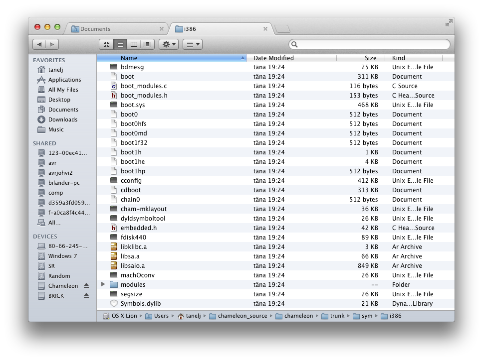

Trucker MK Posted May 14, 2013 Author Share Posted May 14, 2013 { 0x6760, 0x20011043, CHIP_FAMILY_CAICOS, "AMD Radeon HD 6470M", kIpomoea }, Â your id is included but with ipomoea framebuffer, but i can't do it for you, i made clean 10.8.2 installation after updating to 10.8.3 and i don't have xcode installed, so i can't compile chameleon. someone with xcode installed just change the framebuffer to Pithecia and compile, like this: { 0x6760, 0x20011043, CHIP_FAMILY_CAICOS, "AMD Radeon HD 6470M", kPithecia }, Â and try some of the kexts we made for you, sorry if i was uncler, can't type, driving at the moment. Link to comment https://www.insanelymac.com/forum/topic/277042-amd-radeon-hd-6650m-graphics-enabler-dsdt-hdmi-audio-acer-aspire-7750g-2674g50mnkk-gradients-fixed/page/14/#findComment-1915050 Share on other sites More sharing options...
Tauio111 Posted May 14, 2013 Share Posted May 14, 2013 I changed all the 6470's to Pithecia and ran "make" command on it now I've got these files but I have no idea how to install them Link to comment https://www.insanelymac.com/forum/topic/277042-amd-radeon-hd-6650m-graphics-enabler-dsdt-hdmi-audio-acer-aspire-7750g-2674g50mnkk-gradients-fixed/page/14/#findComment-1915086 Share on other sites More sharing options...
