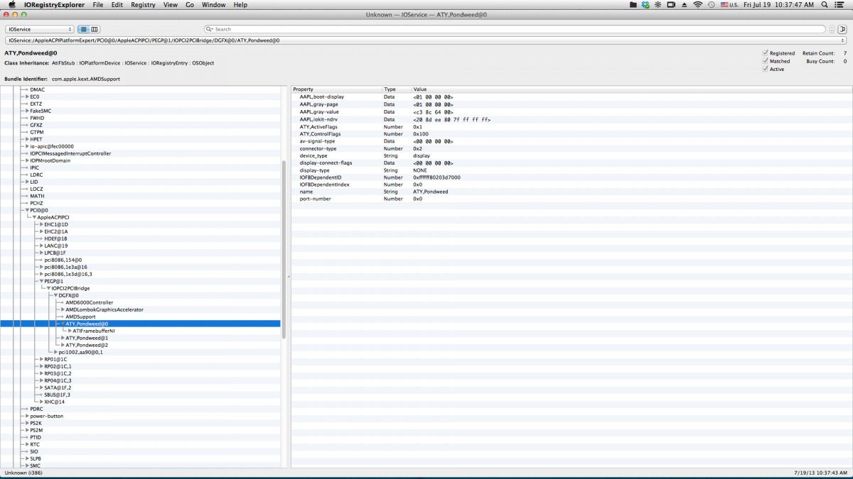

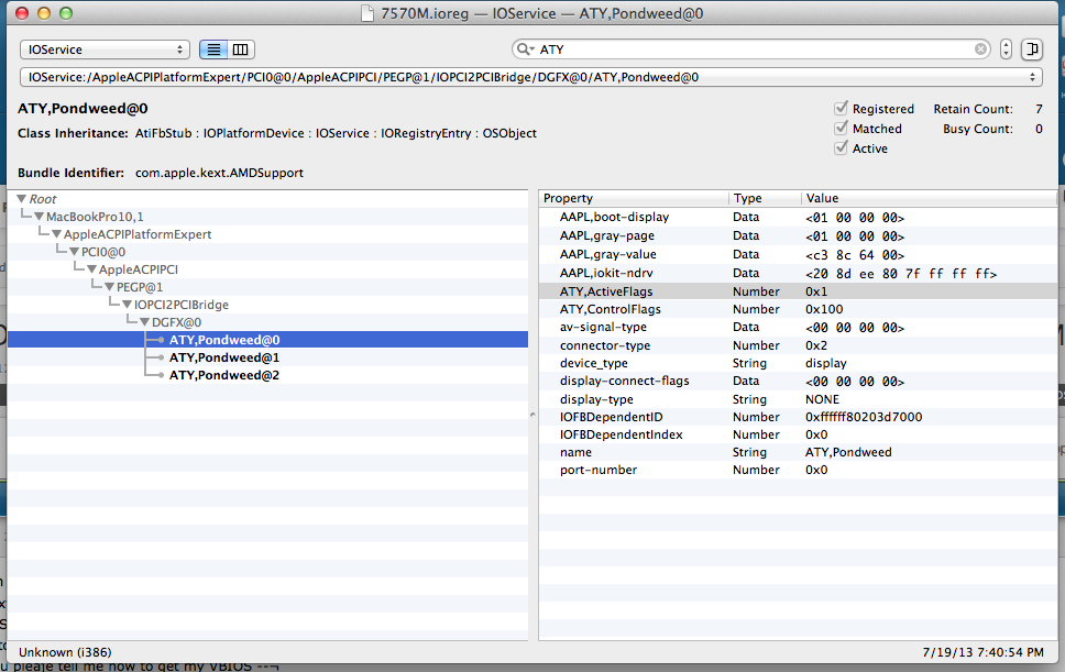

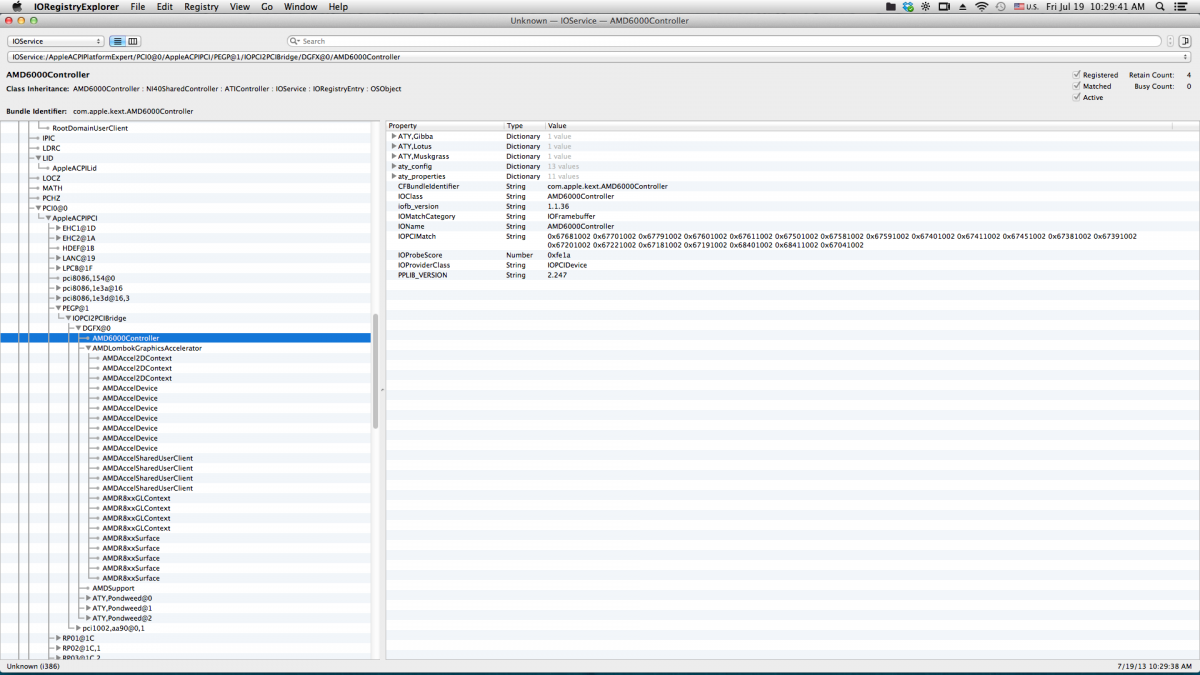

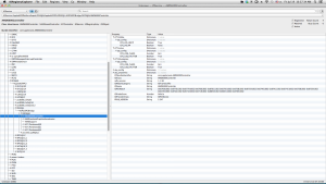

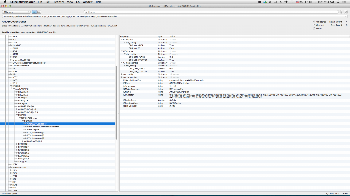

1. Boot with clean ATI6000Controller.kext with GE=Yes and check in IORegExplorer which framebuffer is loaded by default (maybe its better to start with this one)
2. Change back the HotplugID from 01 to 03, you already have 01 in Hydrilla on the second port
Personality: Hydrilla
    ConnectorInfo count in decimal: 5
    Disk offset in decimal 179664
    0000000 02 00 00 00 00 01 00 00 09 01 00 00 12 04 03 03 (02 00 00 00 40 00 00 00 09 01 00 00 10 00 01 01)
    0000010 00 04 00 00 04 03 00 00 00 01 00 00 11 02 01 01
    0000020 00 04 00 00 00 01 00 00 00 09 10 00 21 03 02 02
    0000030 00 04 00 00 00 01 00 00 00 09 10 00 22 05 05 04
    0000040 00 04 00 00 04 03 00 00 00 01 00 00 10 00 04 05
    0000050
3. Try different Transmitter/Encoder values  (in my VBIOS i also have transmitter/encoder 10/00 but its working with 20/01 when i use GE=Yes

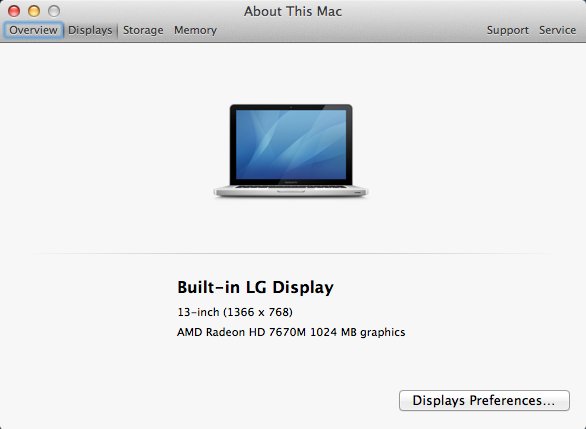

BTW, I forgot to say - to get this "Built-in LG Display" line I had to replace one of descriptors with "00 00 00 FC 00 4C 47 0A 20 20 20 20 20 20 20 20 20 20" (FC means it's display name and 4C 47 are letters "LG". 0A shows this is the end of string and the rest of the space is filled with 20). Also it works only if you have serial number from Apple display. All in all, my new EDID looks like this:

Hi Trucker,
With pure ATI6000Controller.kext and GraphicsEnabler=Yes, I got this IOReg (attached)
As I mentioned, external display port is working with this (I am writing this post with external monitor now:) ). LVDS is black+backlight
Under GFX, AMD6000Controller, I see ATY,Gibba, ATY,Lotus, ATY,Muskgrass.
And there are three ATY,Pondweed elements under GFX.
Does this mean one of these personality has been used for display port with correct framebuffer? And I can tweak it for LVDS?
Thanks!
7570M.ioreg.zip

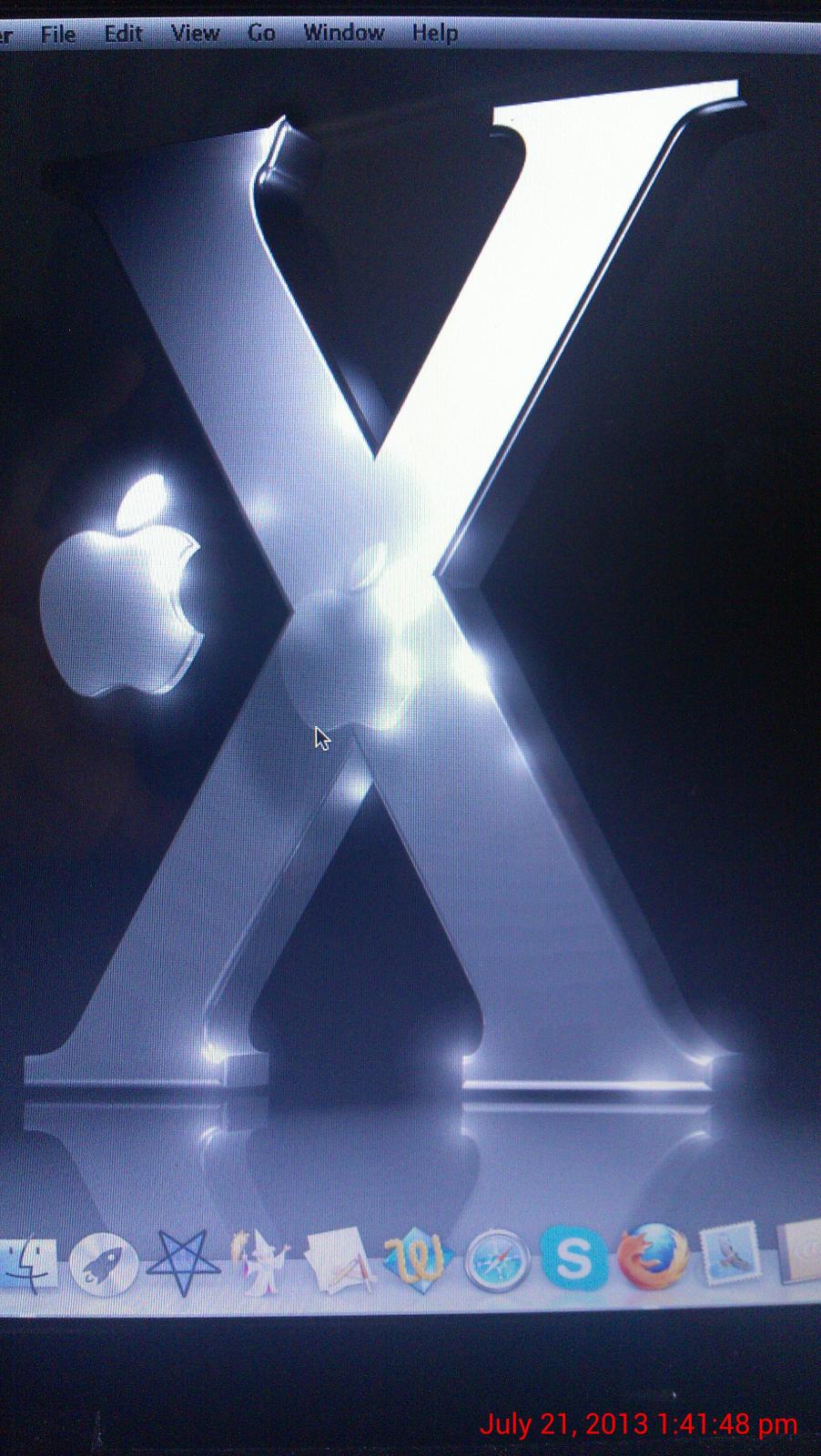

I tried the DisplayMergeNub.kext, it still does not inject my modified EDID (i can see in IOREg my original EDID) but i definitely see some improvement.
Without DisplayMergeNub.kext                                  With DisplayMergeNub.kext
post-423012-0-94877100-1374408134_thumb.jpg                                     post-423012-0-91995700-1374408256_thumb.jpg
You can see here the gradients all over
the lower part on the X
Edit. I managed to inject the modified EDID with DisplayMergeNub.kext + Display Override file (DisplayVendorID and DisplayProductID in Display Overrides) but the result is the same. I would say that now we are from 16-bit color Pixel Depth to 24-bit color Pixel Depth, but not yet at 32-bit color Pixel Depth. I will do some more tests.
Great news! If you see an improvement, then probably EDID is at least somehow injected. You probably just need a bit different "basic params" value than me.
