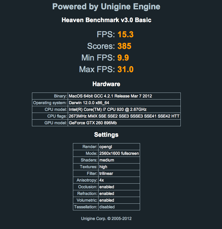

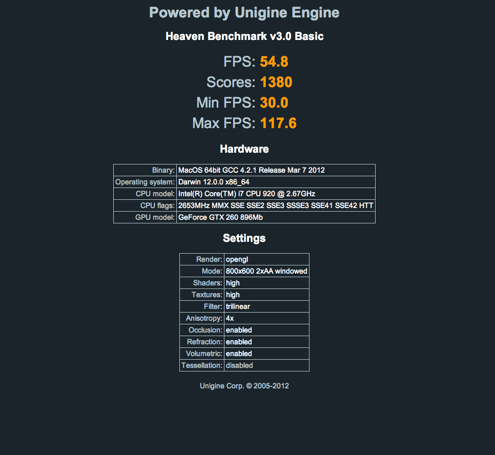

Mountain Lion DP2, gtx260
Maybe a bit low - but we dont have any other GTX 260 to compare + your res isnt listed to .
Your gpu should give at least 2,5 * of the result of my 9600 GT (look my score screenshoots first post) which means score = > 2500 , using: 800x600 windowed, FSAA * 2, SHaders = High, Ani =4
Resoulution= + FSAA= + shaders= has the most effect on the score results - so if they are different to already listed results, its not possible to compare.
Different Ani filter and other parameters have less effect and so different settings here can compared even if the users used different settings in that parameters.

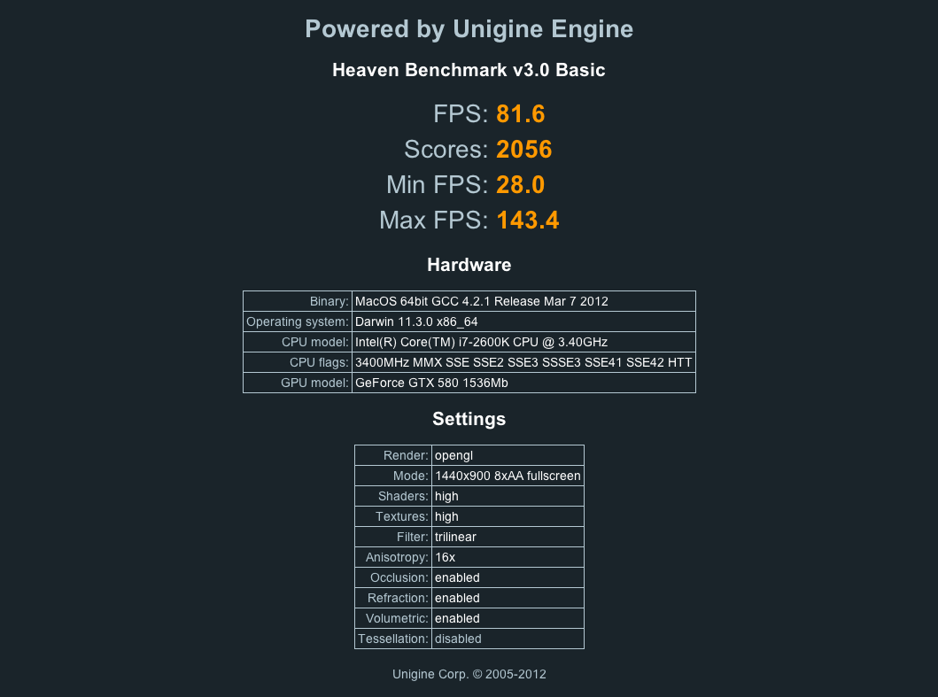

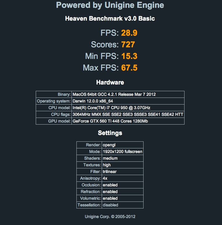

@ GTX 580:
Same here : your combination of res (1440x900) + 8* FSAA isnt already listed to compare.
But there are some GTX 570, GTX 460/470 results with other res / other FSAA settings. You could try to use similar settinsg and compare then.
HINT: Because the different possible settings (especially RES + FSAA + SHADERS) makes it hard to compare already benched GPUs,
PLEASE post also 800x600 windowed, FSAA * 2, Shaders = High, Ani =4 Result beside your other (for sure also interesting) full screen high res + 4* FSAA results.
1920x1080 + FSAA * 2 may run (near) out of VRAM (not really but starts swapping VRAM RAM) if
You may reduce Textures Details (=corresponds 1:1 to VRAM usage, if enough MEDIUM vs HIGH doesnt matter in FPS speed) to MEDIUM (insted of HIGH) and bench again.
If much diff (>> 10%) VRAM was a bit to less for 1920x1080 + FSAA*2. Diff may occur more in the diff of Min FPS than Max FPS in that case.
Gigabyte GTX 580 Stock Clock
is this very good, good enough, not good or no at all?

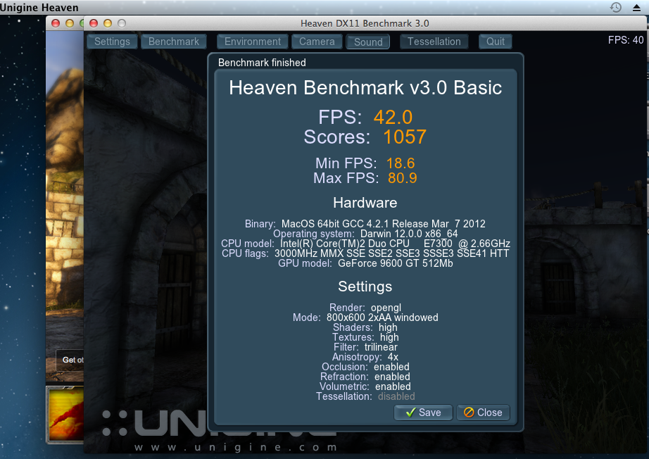

PIC shows usual 800x600, windowed, FSSA*2 , Shader = High, OS X ML DP2

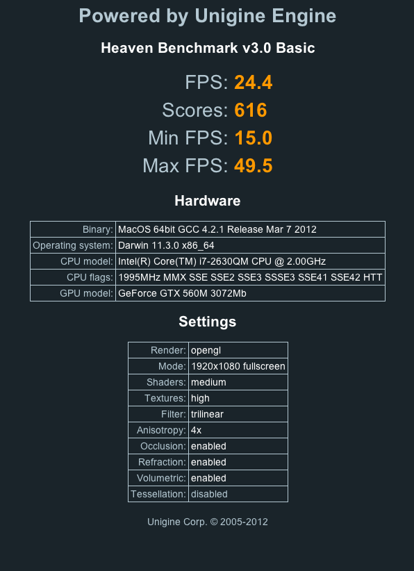

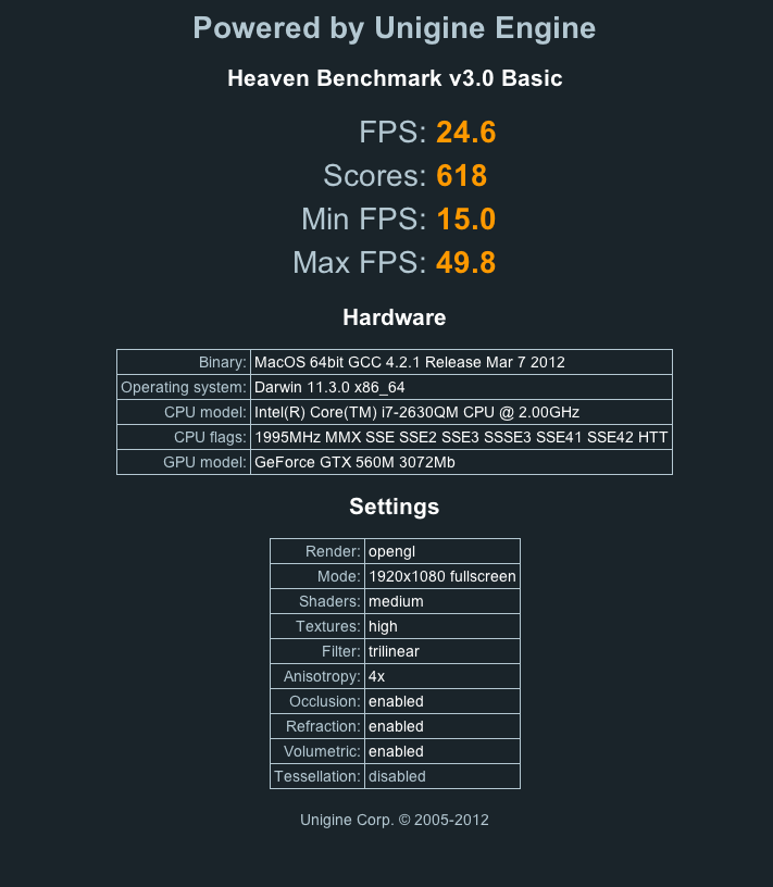

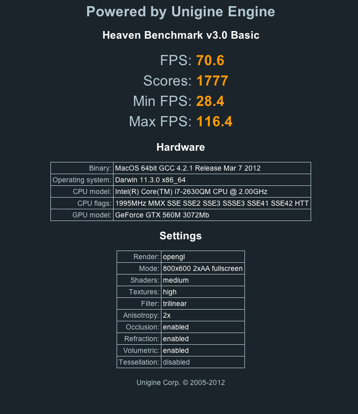

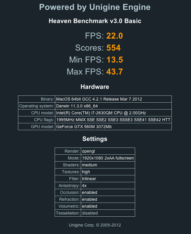

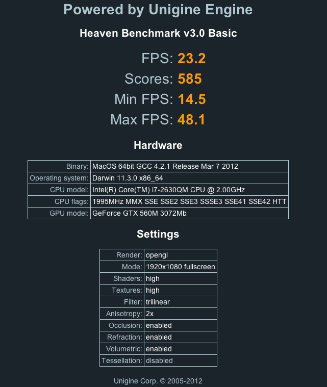

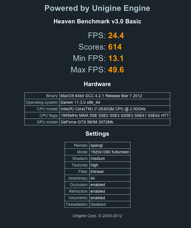

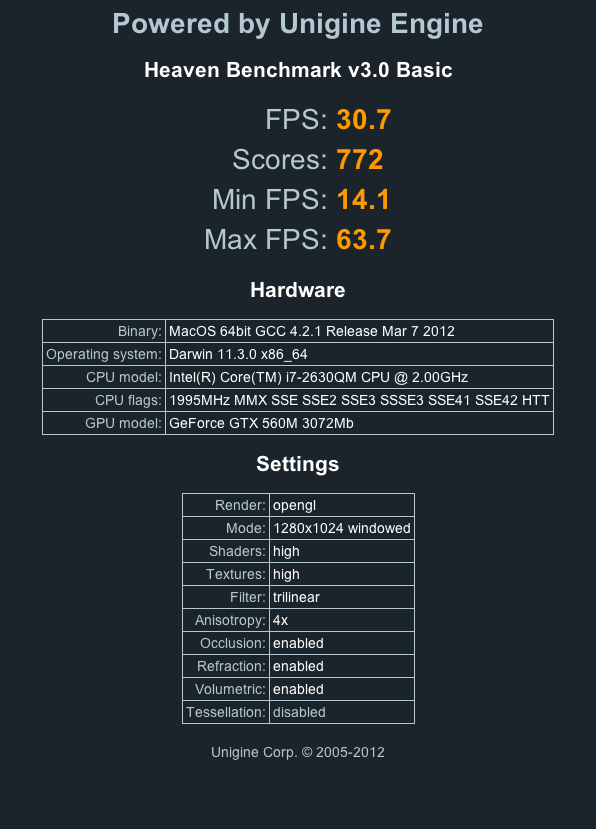

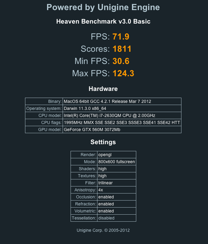

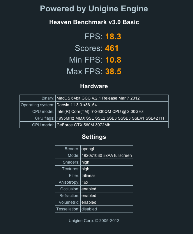

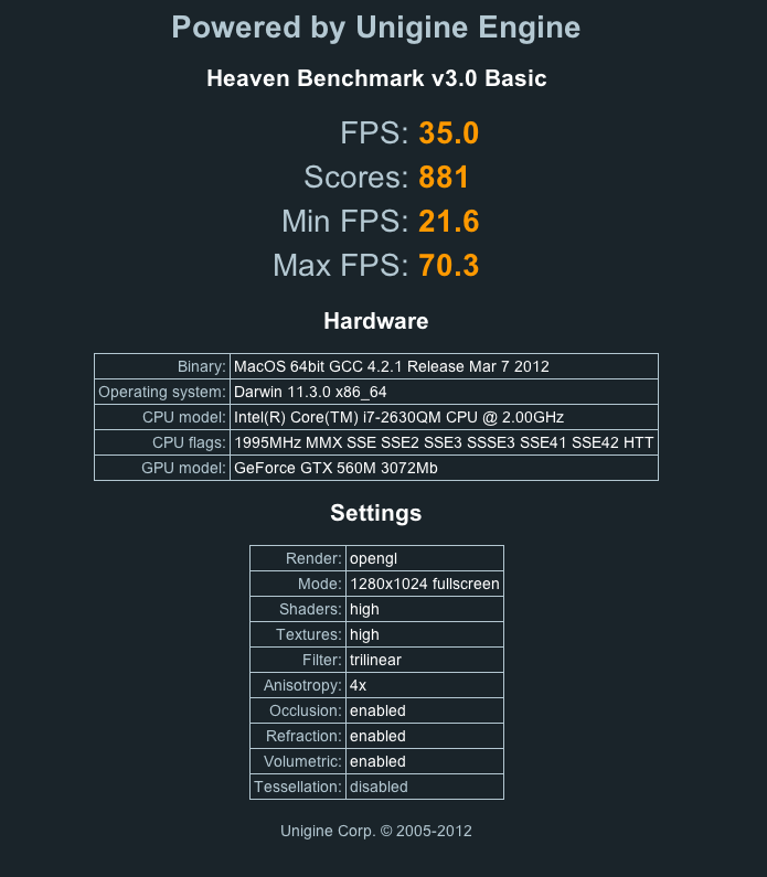

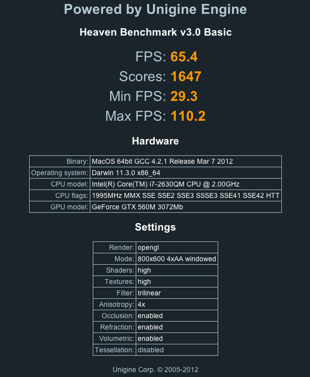

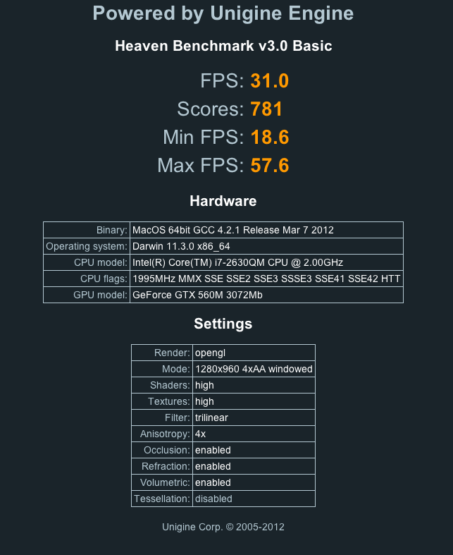

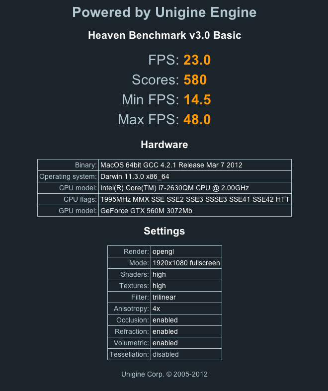

After many many benchmarks scenarios I realize where I start to suffer from FPS loss. In my case its screen resolution and not so much FSAA.

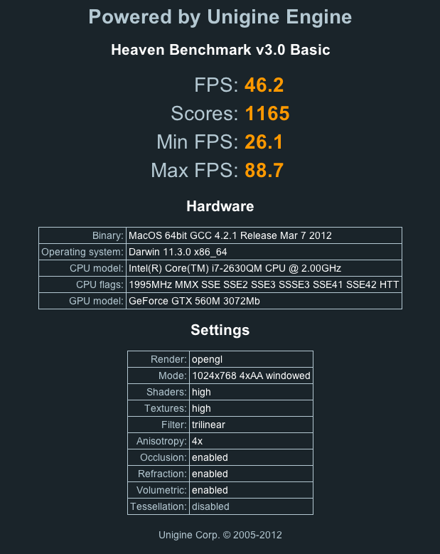

I am using 10.7.3 clean install and my graphics card is Mobile. I don't see any benchmarks other than mine on Mobile. It seems like most of the benchmark results posted so far are from Desktop Graphics Cards.
Even the GTX 460 I thought at first was mobile is why I was unhappy with my original results. I should be happy with these results I suppose unless I see someone post there mobile GTX460M with better results over my GTX560M. I doubt that will be the case though.
