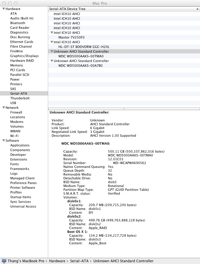

tdtran1025 Posted January 24, 2012 Share Posted January 24, 2012 I tried this. No joy. Kext loads fine with no errors but USB 3 hardware not recognized. I tried adding IDs to PCIPrimaryMatch and changing it to PCIMatch. Doesn't work. It's funny how Highpoint markets same PC and Mac products from teh same chipset. I use a Highpoint SATA internal card (6GBs) and empoy 2 disks for RAID0. The machine runs perfectly except the card itself does not list properly in Systems. However, all the functionalities are there. What I am saying is it may not list in Systems but may well be fully functional. Take a look at teh attached graphic. Link to comment https://www.insanelymac.com/forum/topic/273244-usb-30-card-asm1042-os-x-drivers-from-highpointmac/#findComment-1788971 Share on other sites More sharing options...

dashbad Posted January 25, 2012 Share Posted January 25, 2012 It's funny how Highpoint markets same PC and Mac products from teh same chipset. I use a Highpoint SATA internal card (6GBs) and empoy 2 disks for RAID0. The machine runs perfectly except the card itself does not list properly in Systems. However, all the functionalities are there. What I am saying is it may not list in Systems but may well be fully functional. Take a look at teh attached graphic. Sure - it might not be identified but its still listed there as 'unknown'. With these USB 3 drivers it isn't detecting a super hi speed bus at all. Perhaps someone with more kext knowhow than me can take a look Link to comment https://www.insanelymac.com/forum/topic/273244-usb-30-card-asm1042-os-x-drivers-from-highpointmac/#findComment-1789207 Share on other sites More sharing options...

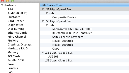

idoc Posted June 2, 2012 Share Posted June 2, 2012 I picked up a secondhand ET2210 and have been fiddling with 10.8 r3 today. It seems if you install a modified caldigit driver from Here and force it to load by removing extraneous matching in the info.plist (IOPCIClassMatch 0x0c033000 only) it will recognise the usb3 ports, at least it does on this rig. Link to comment https://www.insanelymac.com/forum/topic/273244-usb-30-card-asm1042-os-x-drivers-from-highpointmac/#findComment-1824391 Share on other sites More sharing options...
XLR Posted June 2, 2012 Share Posted June 2, 2012 It's funny how Highpoint markets same PC and Mac products from teh same chipset. I use a Highpoint SATA internal card (6GBs) and empoy 2 disks for RAID0. The machine runs perfectly except the card itself does not list properly in Systems. However, all the functionalities are there. What I am saying is it may not list in Systems but may well be fully functional. Take a look at teh attached graphic. Same with CalDigit USB3/eSATA card, the USB3 recognized in System Profiler but eSATA shows as unknown. Link to comment https://www.insanelymac.com/forum/topic/273244-usb-30-card-asm1042-os-x-drivers-from-highpointmac/#findComment-1824467 Share on other sites More sharing options...
idoc Posted June 3, 2012 Share Posted June 3, 2012 I guess the point of my post was that the ASM 1042 will now work on a hackintosh with a simple plist hack to allow the Caldigit driver to load. The PXHCD kext doesn't work for this USB3 controller. Link to comment https://www.insanelymac.com/forum/topic/273244-usb-30-card-asm1042-os-x-drivers-from-highpointmac/#findComment-1824484 Share on other sites More sharing options...
^Andy^ Posted June 10, 2012 Share Posted June 10, 2012 I guess the point of my post was that the ASM 1042 will now work on a hackintosh with a simple plist hack to allow the Caldigit driver to load. The PXHCD kext doesn't work for this USB3 controller. What did you change in the plist? Yup the modified drivers load and show up as super speed bus in system information spose i better test if they actually work though. Yup they actually work! Link to comment https://www.insanelymac.com/forum/topic/273244-usb-30-card-asm1042-os-x-drivers-from-highpointmac/#findComment-1825630 Share on other sites More sharing options...
