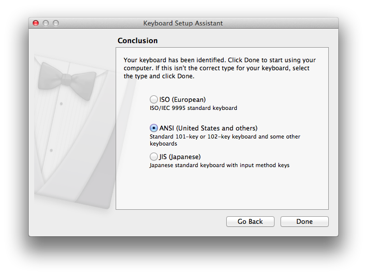

Hi guys, I installed OS X successfully on my N5110, everything is good except my keyboard layout. I choose US layout but I can't type the backward slash ( \ ) and the pipeline ( | ) anymore, the key right on top of the Enter key procedures ( ` ) and ( ~ ) while the key right on top of the tab key procedures ( § ) and ( ± ). I've tried to GG but didn't help. Any work around to fix this thing?
go to /System/Library/Extension/VoodooPS2Controller/MacOS.. find something like plist.info
search for dell wn09 and remove the 52,29,2b  custom ps2 key remaps
plist.info can be edited with xcode
radu, thank you so much! You've just saved my day.
At first I didn't get you, but I tried to work around and finally have it fixed and will clarify here for later come:
1. Locate the VoodooPS2Controller.kext at SLE, show its package content.
2. In the package content, continue locate VoodooPS2Keyboard.kext at Contents/PlugIns/, show its package content.
3. Go to Contents, open to edit the file Info.plist.
4. Remove the row with keys 56, 29 and 2b in the Info.plist, located at Info.plist~IOKitPersonalities/ApplePS2Keyboard/Platform Profile/DELL/WN09/Custom PS2 Map
5.Restart the machine.
