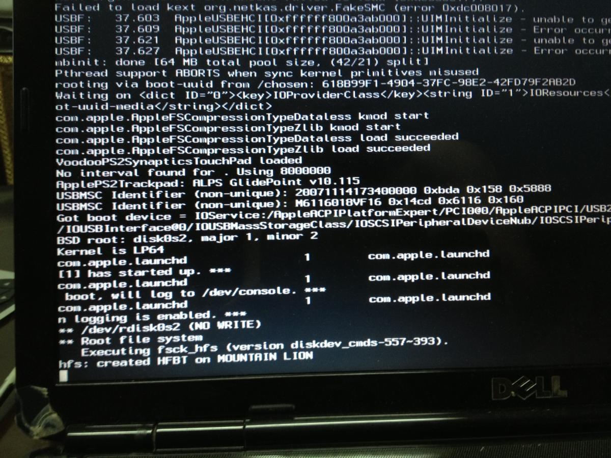

mokeev1995 Posted December 22, 2012 Share Posted December 22, 2012 There was one small problem... I don't know if it's already solved. My dell stop after this moment... now I already format my disk and trying to reinstall. I use all kexts in post install zip. When I boot with "-f" the system works great. but before deleting PXHCD.kext system don't boot successfull and with "-f", only with "-x"... Link to comment https://www.insanelymac.com/forum/topic/271573-guide-dell-inspiron-n5110/page/48/#findComment-1875201 Share on other sites More sharing options...
nanotech Posted December 23, 2012 Share Posted December 23, 2012 There was one small problem... I don't know if it's already solved. My dell stop after this moment... now I already format my disk and trying to reinstall. I use all kexts in post install zip. When I boot with "-f" the system works great. but before deleting PXHCD.kext system don't boot successfull and with "-f", only with "-x"... Same problem faced me it was solved completely by booting with -x -v or UseKernelCache=No then repair permissions via disk utility you must use your SSDT-4 1 Link to comment https://www.insanelymac.com/forum/topic/271573-guide-dell-inspiron-n5110/page/48/#findComment-1875382 Share on other sites More sharing options...
M.O.S Posted December 23, 2012 Share Posted December 23, 2012 There was one small problem... I don't know if it's already solved. My dell stop after this moment... now I already format my disk and trying to reinstall. I use all kexts in post install zip. When I boot with "-f" the system works great. but before deleting PXHCD.kext system don't boot successfull and with "-f", only with "-x"... bro u can use this NullCPUPowerManagement.kext FakeSMC.kext in s/l/e work for me !! Same problem faced me it was solved completely by booting with -x -v or UseKernelCache=No then repair permissions via disk utility you must use your SSDT-4 good idea <3 Link to comment https://www.insanelymac.com/forum/topic/271573-guide-dell-inspiron-n5110/page/48/#findComment-1875400 Share on other sites More sharing options...

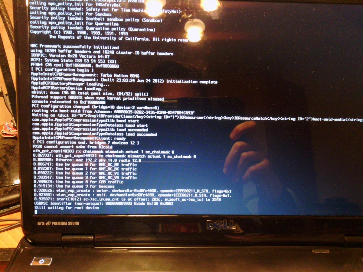

sureshtrb Posted January 1, 2013 Share Posted January 1, 2013 Removed AppleACPIBatteryManager & AppleACPIBatteryDevice kexts from E/E now using cpus=2 DSDT=No -v -x struck at waiting for root device loop.... Help please edit: When i disconnect the HDD from the system and connect thro USB, ML starts. Waiting for help to solve "still waiting for root device" issue, when the HDD is assembled in the system. attached the photos taken during successful boot thro USB connection Waiting for support Link to comment https://www.insanelymac.com/forum/topic/271573-guide-dell-inspiron-n5110/page/48/#findComment-1877222 Share on other sites More sharing options...

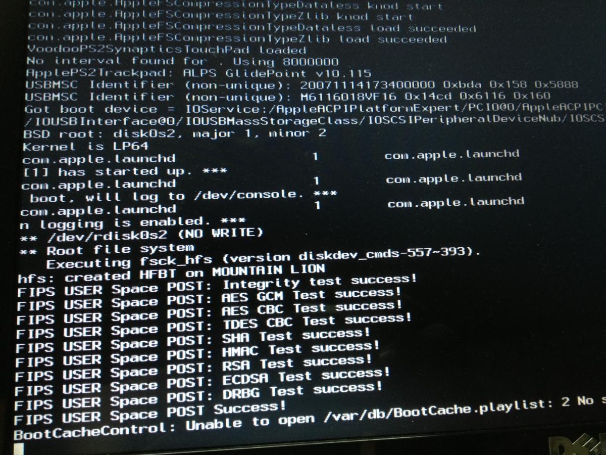

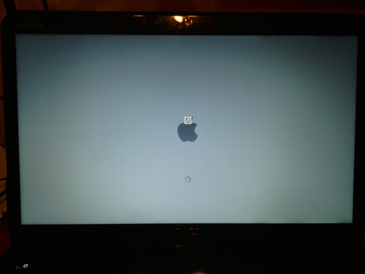

atlfmv7 Posted January 3, 2013 Share Posted January 3, 2013 I have a N5110 with a 2450m, I followed the guide perfectly, but when I go to install, my computer goes to sleep and then sits at a black screen if i wake it up. It doesn't quite make it to the install setup screen. Does anyone have any suggestions? Thanks for all your hard work! EDIT: I tried doing a clean install without the extra files, and was able to get to the setup screen, so it must be related to them. I also noticed that it does get to the installation screen, but the back-light to the monitor turns off, and then forces the computer to sleep. If i wake it, it goes back to that screen but still doesnt turn the backlight on, and then goes back to sleep. I don't have an nvidia card, just the Intel hd3000, and switched the files as apart of the customization process. Anyone have any ideas or fixes that they know of? Again, thanks to everyone for their contributions to this guide! Regards, Ryan Link to comment https://www.insanelymac.com/forum/topic/271573-guide-dell-inspiron-n5110/page/48/#findComment-1877735 Share on other sites More sharing options...
styrian Posted January 3, 2013 Share Posted January 3, 2013 I have a N5110 with a 2450m, I followed the guide perfectly, but when I go to install, my computer goes to sleep and then sits at a black screen if i wake it up. It doesn't quite make it to the install setup screen. Does anyone have any suggestions? Thanks for all your hard work! EDIT: I tried doing a clean install without the extra files, and was able to get to the setup screen, so it must be related to them. I also noticed that it does get to the installation screen, but the back-light to the monitor turns off, and then forces the computer to sleep. If i wake it, it goes back to that screen but still doesnt turn the backlight on, and then goes back to sleep. I don't have an nvidia card, just the Intel hd3000, and switched the files as apart of the customization process. Anyone have any ideas or fixes that they know of? Again, thanks to everyone for their contributions to this guide! You need the extra folder with Smbios.plist and org.chameleonboot.plist for the install. Regards, Ryan I don´t know, which SMBios you are using. Try to use MBP 8,2. If this does not work, remove AppleIntelSNBGraphicsFB.kext from /S/L/E of your install device. But keep the kext on your device. Should be something related with the pinout of the kext. Boot with options GE= no -v -f. You need extra folder with SMBios.plist and org.Chameleon.Boot.plist for installing. Have fun. Link to comment https://www.insanelymac.com/forum/topic/271573-guide-dell-inspiron-n5110/page/48/#findComment-1877766 Share on other sites More sharing options...

atlfmv7 Posted January 3, 2013 Share Posted January 3, 2013 I don´t know, which SMBios you are using. Try to use MBP 8,2. If this does not work, remove AppleIntelSNBGraphicsFB.kext from /S/L/E of your install device. But keep the kext on your device. Should be something related with the pinout of the kext. Boot with options GE= no -v -f. You need extra folder with SMBios.plist and org.Chameleon.Boot.plist for installing. Have fun. Thanks for your reply. I'm using the SMBios from the no nvidia attachment on the first page. And I'm sorry, I'm fairly new to this, so I'm not quite sure what MBP 8,2 is. Thanks for your help! Link to comment https://www.insanelymac.com/forum/topic/271573-guide-dell-inspiron-n5110/page/48/#findComment-1877867 Share on other sites More sharing options...
