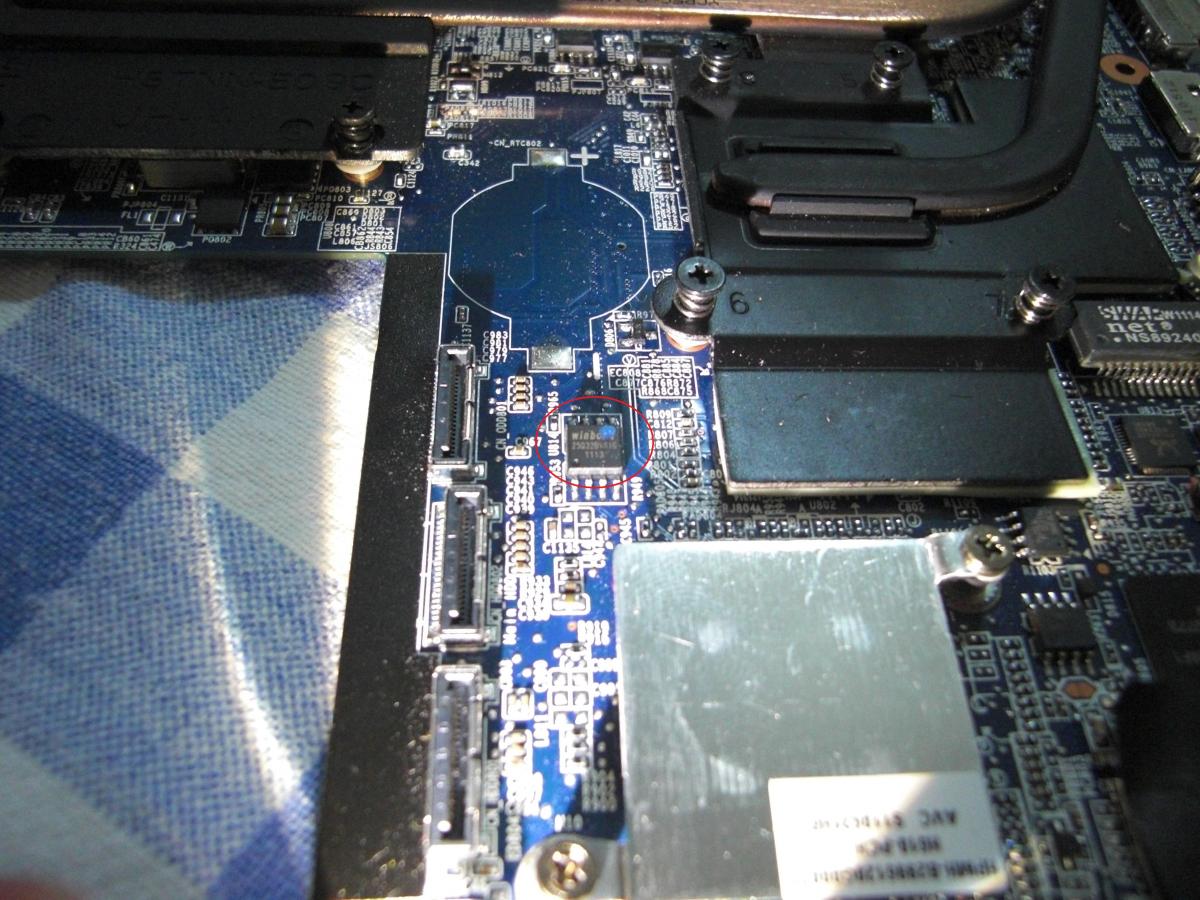

eXtremee Posted August 2, 2012 Share Posted August 2, 2012 Hey Micky, I'm checking all the topics over the time to ensure if there are any updates with our lappies. 6770m? No bios hackers tried to help us? Link to comment https://www.insanelymac.com/forum/topic/267974-dv6-6090xx-mac-os-x-lion-install-disc/page/15/#findComment-1840440 Share on other sites More sharing options...
Micky1979 Posted August 2, 2012 Share Posted August 2, 2012 Hey Micky, I'm checking all the topics over the time to ensure if there are any updates with our lappies. 6770m? No bios hackers tried to help us? I really think that the work on the bios is really hard ..... impossible! I have done experiments to create new builds myself with PhoenixTool204.exe from MDL, I also replaced bios chip to change bootblock:only result is that my Lappy is now in service! I must say, that changing bios is fairly simple with this tool, but the problem is RSA signing! Leave this way! See only chance editing the dsdt with "ACPI CALLS" method as in Linux. Search on google Link to comment https://www.insanelymac.com/forum/topic/267974-dv6-6090xx-mac-os-x-lion-install-disc/page/15/#findComment-1840444 Share on other sites More sharing options...
eXtremee Posted August 2, 2012 Share Posted August 2, 2012 That's sad, i'd really like to switch to osx, would be very nice for my education, anyway benefits of 6770m for some graphics/gaming apps are hodling me off :S really hate hp now for 2 reasons: 1) locked <<<<<<<<<<<<<< bioses(wouldn't be a big deal, if they would have allowed to disable integrated graphics...) 2) warranty service(they didn't send me new hdd as a replacement one, even though they were telling they did ><) @ Denmark Anyway i'll look more in-depth into all of this from september, now i'm on my vacation )) btw, you're using osx as your daily os? how's battery compared to windows? Link to comment https://www.insanelymac.com/forum/topic/267974-dv6-6090xx-mac-os-x-lion-install-disc/page/15/#findComment-1840450 Share on other sites More sharing options...
Micky1979 Posted August 2, 2012 Share Posted August 2, 2012 That's sad, i'd really like to switch to osx, would be very nice for my education, anyway benefits of 6770m for some graphics/gaming apps are hodling me off :S really hate hp now for 2 reasons: 1) locked 2) warranty service(they didn't send me new hdd as a replacement one, even though they were telling they did > Anyway i'll look more in-depth into all of this from september, now i'm on my vacation )) btw, you're using osx as your daily os? how's battery compared to windows? I use only Osx! Battery life is equal to windows, but with F1a camiloml bios (sp54024 NWL Unlocked menues), with this version you can put-off the discrete video card. Our video card there, present and active (kext is loaded!!!! consuming battery, check), but can't switch....crazy..no? Link to comment https://www.insanelymac.com/forum/topic/267974-dv6-6090xx-mac-os-x-lion-install-disc/page/15/#findComment-1840452 Share on other sites More sharing options...
