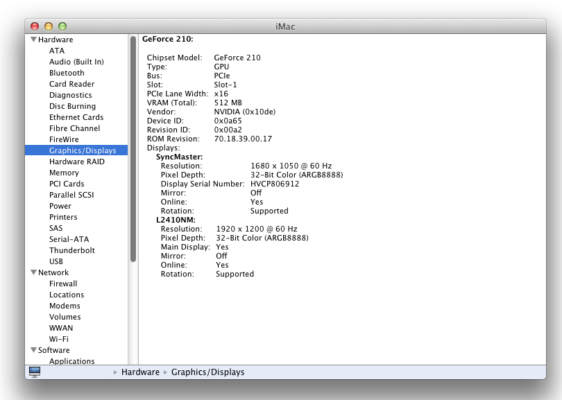

H8TR Posted May 28, 2011 Share Posted May 28, 2011 ASUS GeForce 210 Silent 512MB works OOB. No injector/enabler, no GraphicsEnabler=xxx, no DSDT. Just works. Edit: you might need GraphicsEnabler. It's weird. Chameleon RC5 903 needs GraphicsEnabler=yes, but RC5 846 (I think) that I have on my Snow Leopard 10.6.7 HDD doesn't. Anyway, try it without GraphicsEnabler, if it works, great! If it doesn't just add GraphicsEnabler=Yes to com.apple.boot.plist. Link to comment https://www.insanelymac.com/forum/topic/256103-supported-graphics-cards-with-full-qeqi/page/2/#findComment-1689875 Share on other sites More sharing options...
