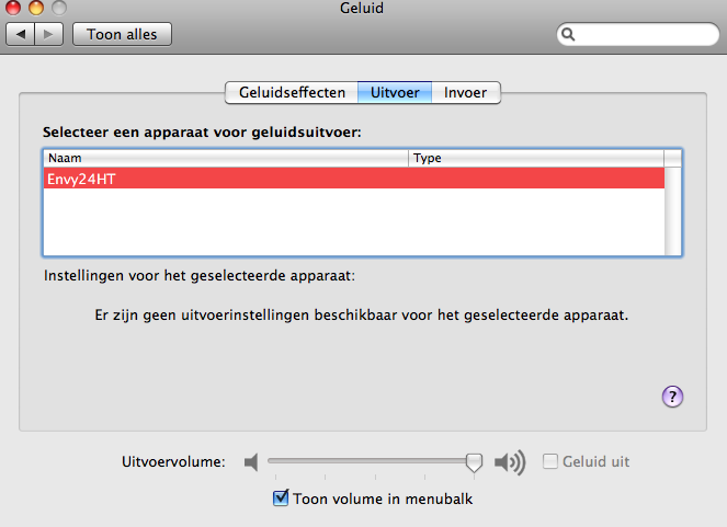

relikwie Posted March 8, 2009 Share Posted March 8, 2009 Hi audiodriverwriter, first of all: thanks for donating some of your time and skills to the community I just came across this thread and realised I had a Terratec Aureon Space laying around, installed it along with your latest driver. But after a reboot it doesn't pick it up right. I get the audio slider fully open and locked. Ouput and Input I got one item "Envy24" Here is a bit from the system.log: Mar 8 11:36:19 localhost kernel[0]: Override HT40 CTL Powers. EEPROM Version is 14.4, Device Type 5Mar 8 11:36:19 localhost kernel[0]: mac 12.10 phy 8.1 radio 13.0 Mar 8 11:36:19 localhost kernel[0]: Found Aureon Space! Mar 8 11:36:19 localhost kernel[0]: subvendor = 3b154511 Mar 8 11:36:19 localhost kernel[0]: Card init done! a kextstat: bash-3.2# kextstat | grep Envy 68 0 0x54773000 0x8000 0x7000 com.audio-evolution.driver.Envy24HT (0.6.0) <66 17 12> And attached a screenshot of the problem on my system, hopefully it is something simple: Dank bij voorbaat! Link to comment https://www.insanelymac.com/forum/topic/25145-esi-juli-envy-24-with-osx86-any-progress/page/24/#findComment-1101577 Share on other sites More sharing options...
