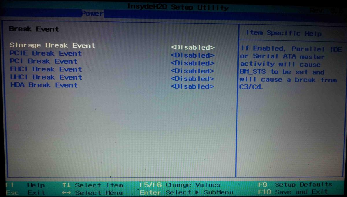

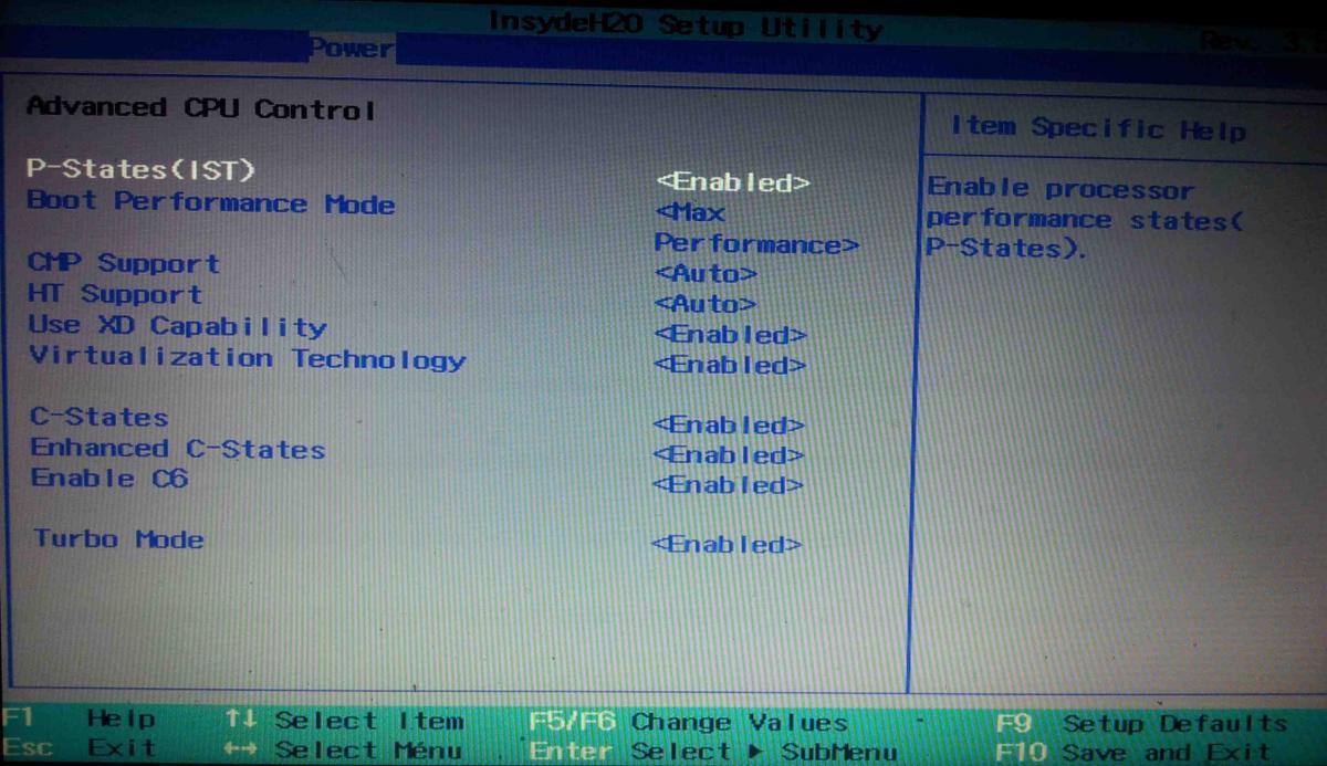

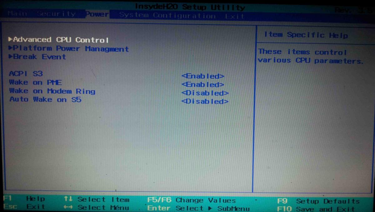

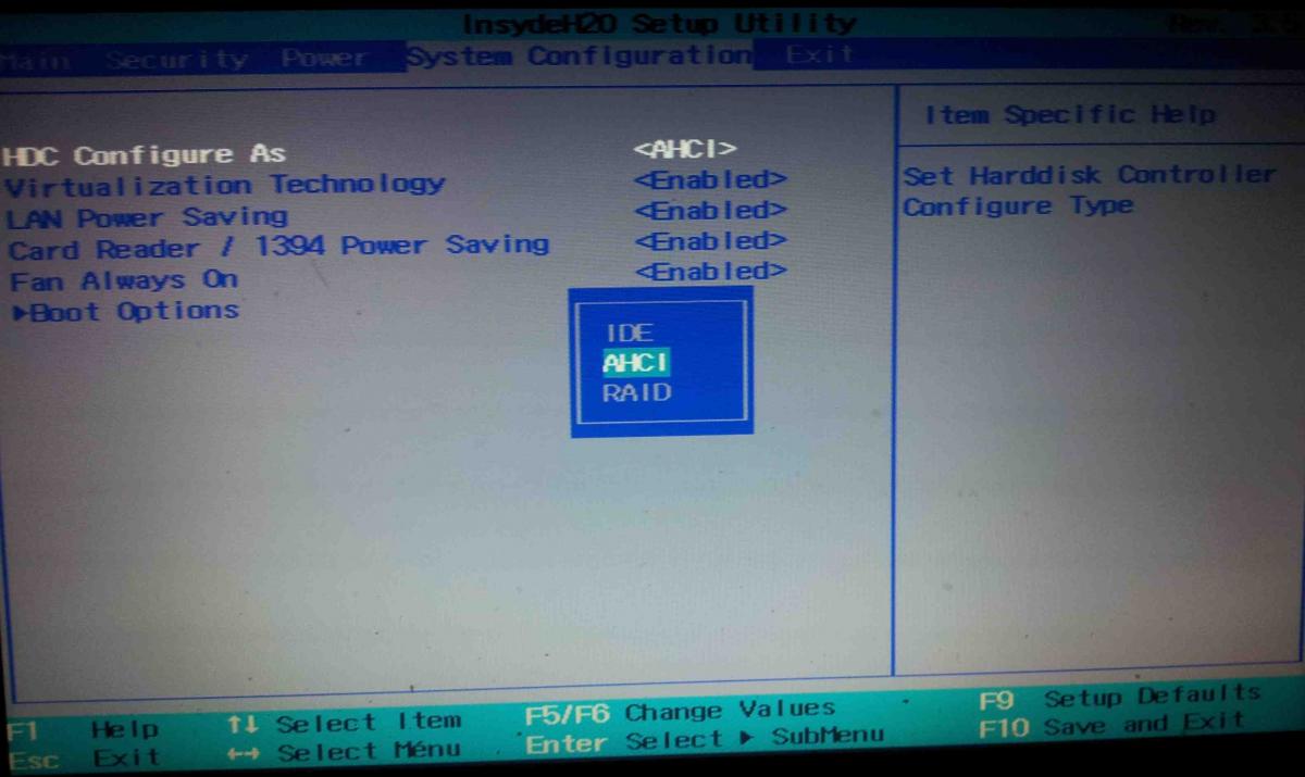

First: No i don't face any problems till now
whitelist is removed (not tested)
Some Screen shots of the added features

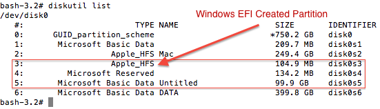

Update: I installed "windows 7 x64 EFI" Successfully and the Partition map is Pure GPT now   :thumbsup_anim:
I used a program called "rufus" and just copied "efi\boot\bootx64.efi" to the root of the Bootable USB

First : Clover
1) install clover on your EFI partition
2) Make sure it's working good with your mac
3) leave the partition you will use for mac not partitioned
Second: Prepear your windows USB installation
1) you can use "rufus"
2) in the Partition scheme and target system type, Choose GPT for UEFI
    in file system, choose NTFS
3) choose the windows iso and Start the process
4) After it's done copy "efi\boot\bootx64.efi" to the root of the Bootable USB
Third: Boot From clover
1) Boot from clover EFI windows USB
(if you don't find it, use ("boot from file" which you will find in Boot Maintence Manager) and choose the "bootx64.efi" on USB root
2) when you boot windows creat Partition in the empty space and start installation
3) windows will Create 3 Partitions (EFI Partition, System Reserved Partition, windows Partition)
