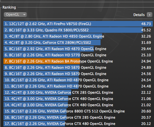

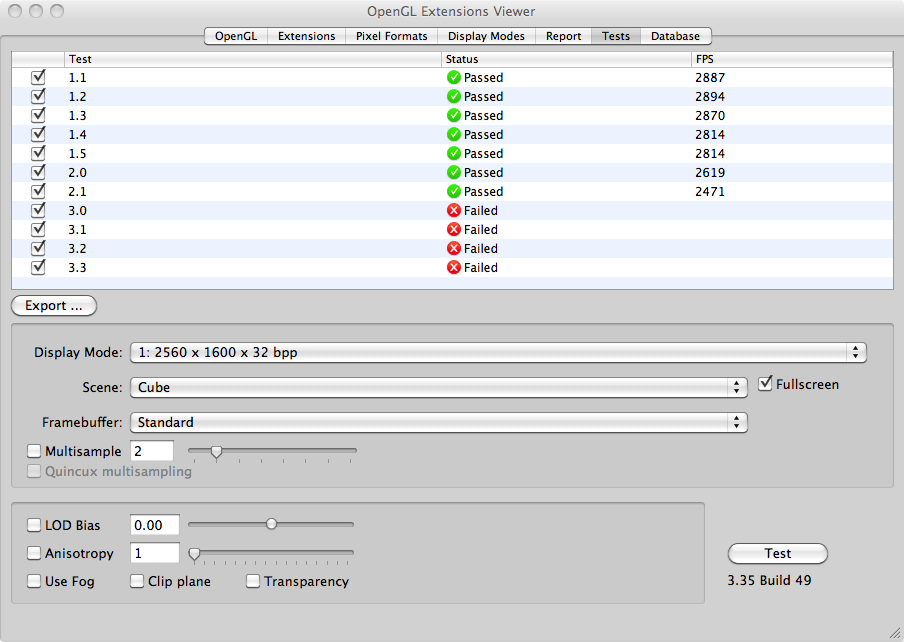

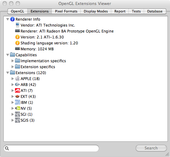

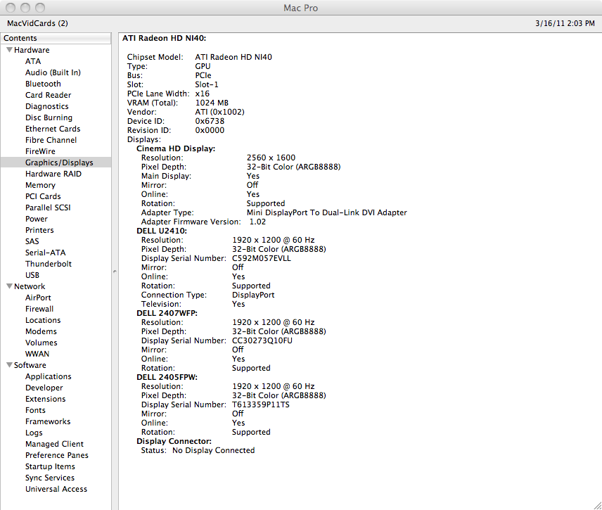

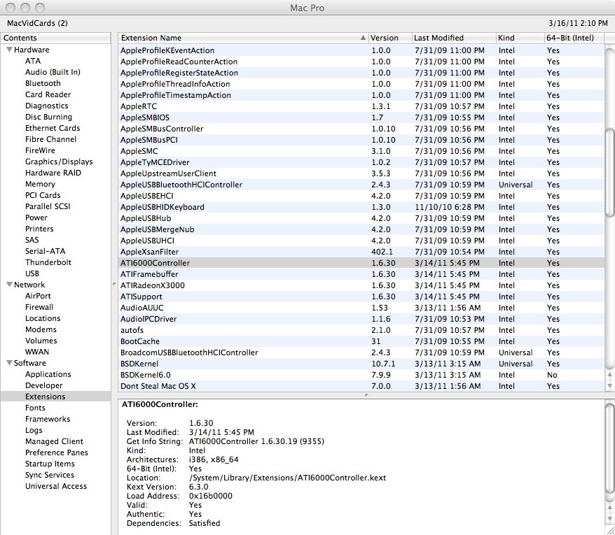

rominator Posted March 16, 2011 Share Posted March 16, 2011 Got an XFX 6870 from Newegg. Working beautifully in Mac Pro 4,1. (I think AGPM issue is only with Nvidia cards) 4 displays, OpenGL, QE/CI, cleans the house and irons the cat. PERFECT !!! Using complete 10.6.6 from MBP, likely only need a few of the kexts though. (Note "Thunderbolt" to left of 6000 controller) I would say 6950/70 will come in future update, or will require some deeper digging in kexts we have now. Thanks to you guys !!! Link to comment https://www.insanelymac.com/forum/topic/250804-ati-radeon-6xxx-working-qeci/page/5/#findComment-1656313 Share on other sites More sharing options...

rominator Posted March 17, 2011 Share Posted March 17, 2011 hi your points in cinebech is? novabech? thanks is? http://www.newegg.com/Product/Product.aspx...0-506-_-Product or http://www.newegg.com/Product/Product.aspx...0-507-_-Product The cheaper card. $179 after rebate. Cinebench is kinda embarassing, My mac has 8 cores...but the cheapest 8 cores, ie, @ 2.26 Ghz. The other cards tested are mostly mine too. I also have a 2006 with a Quad 3.0. Cinebench is very CPU bound, even the OpenGl part. Running in OSX is an embarassment. Neat OS, but Graphics Performance is not what it was in past compared to Windows. Haven't paid for Novabench. BTW, card does NOT have shutdown/sleep issues. To run 4 displays, you will need to have real DP monitors, or use Active DP adapters. Link to comment https://www.insanelymac.com/forum/topic/250804-ati-radeon-6xxx-working-qeci/page/5/#findComment-1656415 Share on other sites More sharing options...
