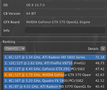

Jordan2Delta Posted April 22, 2011 Share Posted April 22, 2011 When having both cards installed ATI 5770 and GTX 570 I had 43fps in cinebench's (Vers. 11.5) OpenGL benchmark. When I removed the ATI card I only got 10fps! Which is a bummer. I don't know why. I looked at AppleGPUPowerManagemnt.kext and found for the MacPro5,1: GeForce GT9500 Vendor10deDevice0640 GeForce GT200 (GTX 260) Vendor10deDevice05e2 ...which means my card wouldn't be affected by this. Maybe adding my vendor id would do the trick? Aargh, I am not sure. I think I better wait for another version of Lion AND Chameleon to catch up. Some of my apps (like VirusBarrier) don't run well on Lion and 1st booting into SL to delete caches from Lion's system and secondly, rebooting to Lion and hoping not to hang on nstat lookup entry failed: 2 nspace-handler-set-snapshot-time: 1303230505 isn't very pleasant. Edit: Newest Chameleon Lion Boot loader works with GTX 570 and no need to delete caches every reboot any longer. Nstat etc. still shows up but no hangs on that one. Yeah! I set GraphicsEnabler=No if someone is curious about. Bad news are I couldn't reproduce 43fps in cinebench. This time I only got 26fps or less depending switching to 2nd DVI port. Maybe it's because system clock/all animations of GUI are running too fast? CPU benchmark results also 35% lower than I'd expect. Link to comment https://www.insanelymac.com/forum/topic/245540-geforce-500-series/page/2/#findComment-1673478 Share on other sites More sharing options...

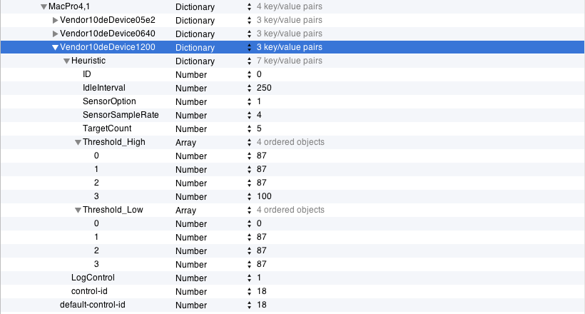

rominator Posted July 13, 2011 Share Posted July 13, 2011 Hey guys, wanted to let you know that GTX560 works but GTX560ti doesn't, at least for me. I'n going to try changing device id of the Ti to be normal and see if it works that way. CUDA and OpenGl work fairly well, but I had to add 1201 id to AGPM to get proper behavior. Just removing AGPM made it unreliable OpenCl crashes out. UPDATE : !!!!!!! Turns out the GTX560Ti also works just fine in Lion once you edit an AGPM for it. (Who knows how to add MORE entries in AGPM beyond usual 2? Would be great to build one that included a BUNCH of cards) The problem was a GT120 that worked fine in SL but went black/hang in Lion. I will predict right now that many people with Hacks or flashed oddball Nvidia cards may find issues with monitor definitions in Lion that they did not have in SL. Will require NVCAP fiddling (or equiv) Anyway, the Ti scores almost IDENTICALLY to the regular 560. Next to get DisplayPort on 560 to work Link to comment https://www.insanelymac.com/forum/topic/245540-geforce-500-series/page/2/#findComment-1714220 Share on other sites More sharing options...
gargo1 Posted July 16, 2011 Share Posted July 16, 2011 UPDATE : !!!!!!! Turns out the GTX560Ti also works just fine in Lion once you edit an AGPM for it. So GTX 560Ti works fully, can you play games that use OpenGL etc.? Is there any guide on how to getting it to work? Thanks Link to comment https://www.insanelymac.com/forum/topic/245540-geforce-500-series/page/2/#findComment-1715641 Share on other sites More sharing options...
