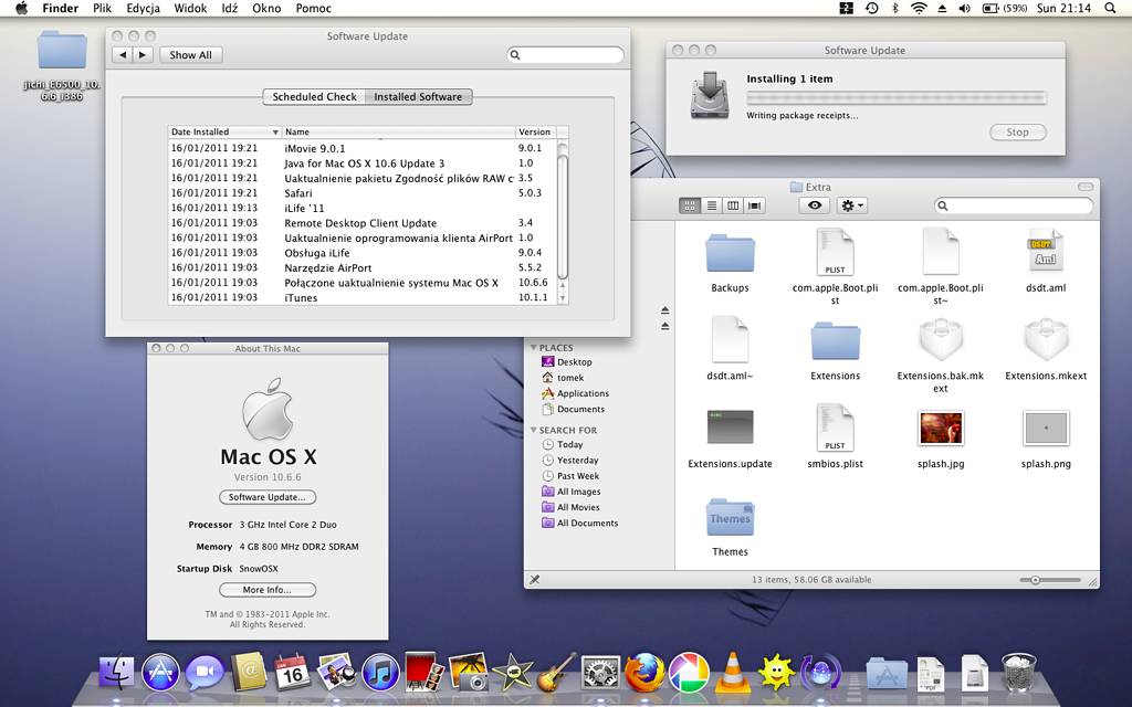

compnird Posted July 18, 2012 Share Posted July 18, 2012 Hello, Just updated my Dell Latitude E6400 from 10.6.3 to 10.6.6. 1. To install OSX i use this guide: [iNSTALL/GUIDE] Snow Leopard On Dell E6500/E6400 in 8 simple steps, Dual boot Windows 7 Instruction Included I use empty DVD with this OSX - SnowOSX Universal 10.6.2 v3.6 Intel Only, this works fine on my E6400. 2. Then, after add kext from this tutorial: 64-bitHackintosh Specifically for the Latitude E6400/E6500.pdf Additional_Kexts_for_E6400_E6500.zip and Extras_for_E6400_E6500.zip (thanks to carman23) I was able to use Snow Leopard on my Latitude E6400. This kext and extras set up graphic, sound, LAN, webcam and keyboard to work in my E6400. I still need to set up SD Card Reader, WiFi, Trackpad and volume to work. To make WiFi and SD Card Reader to work i needed this kext: Broadcom43XXFamily.kext and VoodooSDHC.kext ( 4.3MB ) 3. When system run after next reboot i added kext (used Kext Helper to install) and /extra folder from this pack (just copy them and replace yours). This pack works perfectly with my 64bit OSX. jichi_E6500_10.6.6_i386.tar.bz2 ( 12.41 MB ) (thanks to jichj - HCL 10.6.6/Portables) This fix trackpad and volume in my E6400. 3a. If you find problem with volume control - slider changes but volume doesn't - you need to replace VoodooHDA (thanks to pcrew): download 32/64bit VoodooHDA.kext ( 230.49K ) 4. Then after reboot, i was able to run system update, witch found new update for: OSX 10.6.6, airport, itunes and some more. Downloaded them, installed and after reboot. System starts OK, but without sound. So went to S/L/E and i deleted AppleHDA.kext Next reboot and everything works UPDATE 6/03/2011: After playing with some kext, got kelner panic, so do installation again from beginning. When i replace my /extra with jichj pack, need to delete ApplePS2Controller.kext from S/L/E. This help me with TrackPad. UPDATE 10/04/2011: Hi, today got updated my hackintosh to SL 10.6.7, from system update. There was no problems at all, works fine ;P All the best, Tom. Excellent write up and exactly the information I was looking for... HOWEVER, all of the links are dead. I just obtained an E6400 and am looking to do a dual boot of Snow Leopard (Retail disk arrives tomorrow, Only $30 from Apple!) with Windows 7. I would like to obtain as much of the driver/software (kext) as possible prior to doing this. I have been using Linux for many years and supported Mac until the Puma days all the way back to OS8 and hoping to get back into the scene without the expense of a new MacBook Pro (yet). This will be my first OSX on a PC attempt although I've done it many times on a real Mac. Looks like a number of folks trying to find these and there are copious forum posts but all are dead links. PM me or post a location if anyone finds these please! Quote Link to comment Share on other sites More sharing options...
