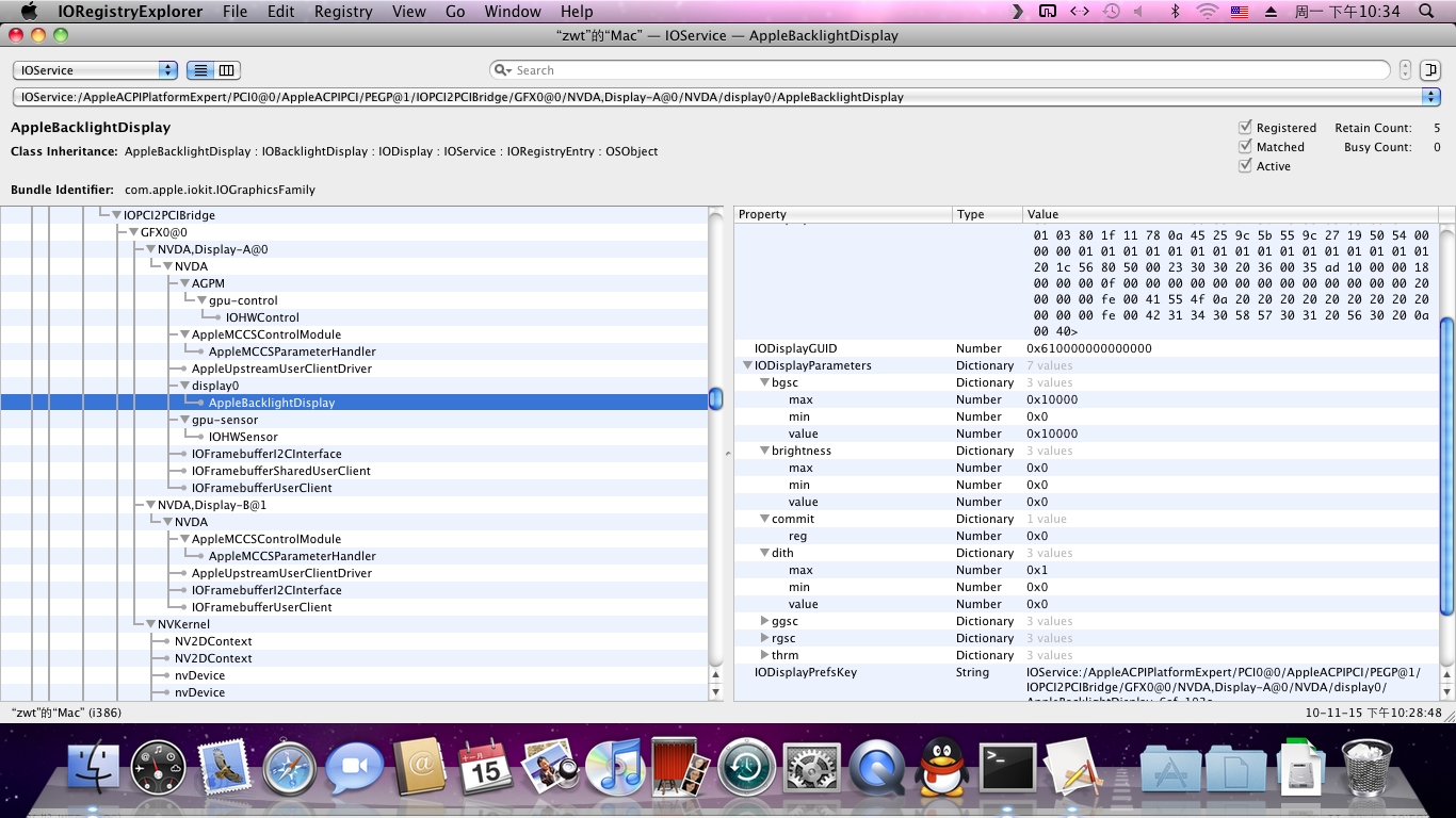

maczx Posted November 16, 2010 Share Posted November 16, 2010 Do you have max brightness 0 in ioreg? yes the max and min are all 0 here is my ioreg and use your kext dmesg give me this info Acpi brightness levels:11, lowest brightness:5, highest brightness:100 We still don't have brightness entry in ioreg... waiting... Link to comment https://www.insanelymac.com/forum/topic/236835-updated-2012-genericbrightnesskext/page/6/#findComment-1584823 Share on other sites More sharing options...
BlackCH Posted November 16, 2010 Share Posted November 16, 2010 Try adding something like Store (0xFFFFFFFF, LEVL) to _WAK method before last return. If this works, then, we could save this to some variable in _PTS method and restore it in _WAK. That didnt work Link to comment https://www.insanelymac.com/forum/topic/236835-updated-2012-genericbrightnesskext/page/6/#findComment-1584833 Share on other sites More sharing options...
ivik Posted November 16, 2010 Author Share Posted November 16, 2010 Then osx messes with brightness after wakeup. Maybe your injector values are wrong. Try removing AAPL,BacklightRestore and see if anything changes or change to zero all values. @maczx try changing some injector values with backlight. Maybe then max brightness changes. Or try loading nvidia rom for your grahics. Link to comment https://www.insanelymac.com/forum/topic/236835-updated-2012-genericbrightnesskext/page/6/#findComment-1584836 Share on other sites More sharing options...
BlackCH Posted November 16, 2010 Share Posted November 16, 2010 Then osx messes with brightness after wakeup. Maybe your injector values are wrong. Try removing AAPL,BacklightRestore and see if anything changes or change to zero all values. I think what happens is that osx restore it's own brightness value after sleep and your kext does not correct it. After you press bright up/down the brightness is fine again. Anyway, I can live with it. Thanx for your work! Link to comment https://www.insanelymac.com/forum/topic/236835-updated-2012-genericbrightnesskext/page/6/#findComment-1584903 Share on other sites More sharing options...
maczx Posted November 16, 2010 Share Posted November 16, 2010 Then osx messes with brightness after wakeup. Maybe your injector values are wrong. Try removing AAPL,BacklightRestore and see if anything changes or change to zero all values. @maczx try changing some injector values with backlight. Maybe then max brightness changes. Or try loading nvidia rom for your grahics. as u say i try use rom but no change what card is yours? mine is gt240m the best situation is the SUN icon and the bar .but backlight didnot change when i press fn+Pause and fn+ScorLk ,the bar always goes to 100% here is my modfied dsdt any suggestion? dsdt.zip Link to comment https://www.insanelymac.com/forum/topic/236835-updated-2012-genericbrightnesskext/page/6/#findComment-1584910 Share on other sites More sharing options...
ivik Posted November 16, 2010 Author Share Posted November 16, 2010 Yeah... this is becase it cant move, min/max=0. I have intel gma 950. Look for chamelon info on how to load original apple rom. Maybe osx from there reads min/max values. I just read them from ioreg. Hm... maybe i could write some menu plugin for people who's values are zero. Link to comment https://www.insanelymac.com/forum/topic/236835-updated-2012-genericbrightnesskext/page/6/#findComment-1584921 Share on other sites More sharing options...
wojnar0 Posted November 16, 2010 Share Posted November 16, 2010 @ivik With your last kext (not from 1 page) nothing change, slider doesn't move. In console i see We still ... ioreg, values in ioreg are 0x0. I run RW Everything under windows and my brightness code are (from lowest): 45,4F,56,6E,8E,AE,CF,FF. Here is screenshot from RW-E with checked whitch one values moves: Maybe is something still wrong in my dsdt, I cant find "LEVL" words Thank you very much. Ps. Is "more vanilla" using VoodooPs2 kext or ApplePs2...? (Im under 64bit) Link to comment https://www.insanelymac.com/forum/topic/236835-updated-2012-genericbrightnesskext/page/6/#findComment-1585113 Share on other sites More sharing options...
ivik Posted November 16, 2010 Author Share Posted November 16, 2010 Use the one in first page. All others are modified for BlackCH notebook. As i sad.. if your max brightness is zero (from ioreg), slider doesn'tt move. Link to comment https://www.insanelymac.com/forum/topic/236835-updated-2012-genericbrightnesskext/page/6/#findComment-1585239 Share on other sites More sharing options...

maczx Posted November 17, 2010 Share Posted November 17, 2010 Yeah... this is becase it cant move, min/max=0.I have intel gma 950. Look for chamelon info on how to load original apple rom. Maybe osx from there reads min/max values. I just read them from ioreg. Hm... maybe i could write some menu plugin for people who's values are zero. ye i have already use 'GraphicsEnabler' to driver the graphic card .and i tried 'UseNvidiaROM' flag also. at the same time i deleted 'PEGP' from dsdt,but no go! if i do not driver the card ,the brightness couled be contralled with origianl keys fn+up/down,but no SUN no bar. once the card was drivered,brightness goes away. Link to comment https://www.insanelymac.com/forum/topic/236835-updated-2012-genericbrightnesskext/page/6/#findComment-1585564 Share on other sites More sharing options...
ivik Posted November 17, 2010 Author Share Posted November 17, 2010 But do you have osx rom dump from apple copmuter with this card? Link to comment https://www.insanelymac.com/forum/topic/236835-updated-2012-genericbrightnesskext/page/6/#findComment-1585565 Share on other sites More sharing options...
maczx Posted November 17, 2010 Share Posted November 17, 2010 But do you have osx rom dump from apple copmuter with this card? It seems that Apple have not used this card before.so there no osx rom.the rom i used is dumped from Everest. thx reply Link to comment https://www.insanelymac.com/forum/topic/236835-updated-2012-genericbrightnesskext/page/6/#findComment-1585572 Share on other sites More sharing options...
ivik Posted November 17, 2010 Author Share Posted November 17, 2010 What is your hardware brightness status when osx starts? Can you change brightness before login (on boot)? Link to comment https://www.insanelymac.com/forum/topic/236835-updated-2012-genericbrightnesskext/page/6/#findComment-1585576 Share on other sites More sharing options...
maczx Posted November 17, 2010 Share Posted November 17, 2010 What is your hardware brightness status when osx starts? Can you change brightness before login (on boot)? yes before login i could change brightness .and when osx come back from sleep the brightness go to the max, the brightest. Link to comment https://www.insanelymac.com/forum/topic/236835-updated-2012-genericbrightnesskext/page/6/#findComment-1585590 Share on other sites More sharing options...
ivik Posted November 17, 2010 Author Share Posted November 17, 2010 What about when you dont load my driver? Do your hardware brightness keys work? Link to comment https://www.insanelymac.com/forum/topic/236835-updated-2012-genericbrightnesskext/page/6/#findComment-1585592 Share on other sites More sharing options...
maczx Posted November 17, 2010 Share Posted November 17, 2010 What about when you dont load my driver? Do your hardware brightness keys work? thx reply Whether load your driver or not , the situation is the same: bar appears but still 100%,SUN appears when i press fn+Pause/SorLk ,in ioreg max and min are 0 aways. when i load your driver manual ,dmesg gives me below info " Acpi brightness levels:11, lowest brightness:5, highest brightness:100 We still don't have brightness entry in ioreg... waiting..." Link to comment https://www.insanelymac.com/forum/topic/236835-updated-2012-genericbrightnesskext/page/6/#findComment-1585602 Share on other sites More sharing options...
ivik Posted November 17, 2010 Author Share Posted November 17, 2010 Yes... but do your native hardware keyboard brightness keys work without my driver? Link to comment https://www.insanelymac.com/forum/topic/236835-updated-2012-genericbrightnesskext/page/6/#findComment-1585605 Share on other sites More sharing options...
maczx Posted November 17, 2010 Share Posted November 17, 2010 Yes... but do your native hardware keyboard brightness keys work without my driver? native keys are fn+up/down ,but they dont work. pressing fn+Pause/ScrLk could call SUN icon . did you see my modified dsdt? thx Link to comment https://www.insanelymac.com/forum/topic/236835-updated-2012-genericbrightnesskext/page/6/#findComment-1585608 Share on other sites More sharing options...
ivik Posted November 17, 2010 Author Share Posted November 17, 2010 Please understand me... if max brightness=0, my driver wont work. Delete it and try this dsdt and let me know if hardware brightness keys work. Also... in early boot brightness should be set to minimum by this dsdt. dsdtmaczx.aml.zip Link to comment https://www.insanelymac.com/forum/topic/236835-updated-2012-genericbrightnesskext/page/6/#findComment-1585613 Share on other sites More sharing options...
