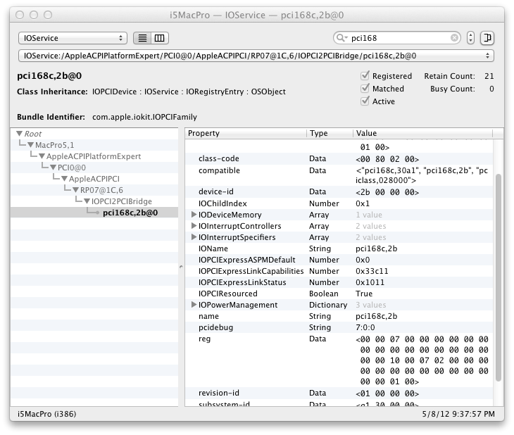

pnoytechie Posted May 8, 2012 Share Posted May 8, 2012 I've been trying this. But I'm not good in DSDTing Could anyone tell me how to put this correctly in my DSDT? I'm using ASRock Z77 Extreme4 board with i5 2500k. Atheros 9285 card is TP-Link TL-WN781ND v1. I extracted my DSDT (using DSDTE/DSDT Editor), but when I tried to integrate the DSDT code (from page 1), IASL gives me errors (18 errors to be exact). Could anyone tell me how to correct this? here's the original, unmodified DSDT from my board: dsdt_stock.txt here's the version after I inserted the code in page 1: dsdt_modded.txt and here goes the IASL compilation log, with 18 errors: iasl_log.txt RP07 is where the card is plugged in, as shown in IOReg: Anyhelp will be greatly appreciated. Thanks in advance! Link to comment https://www.insanelymac.com/forum/topic/234570-atheros-ar9285-fix-for-snow-leopard-mavericks/page/6/#findComment-1818844 Share on other sites More sharing options...
juanerson Posted May 9, 2012 Share Posted May 9, 2012 pnoytechie DSDT compilation errors was fixed, basic fixes applied, AirPort device and injection added, and .dsl file for future hack editions attached. Then, Try the dsdt.aml from /Extra + Install the DeviceMergeNub injector in /S/L/E. And just try installing only one of them at time, because it depend of firmware card to show in ioreg. + Repair permissions and rebuild cache. Finally, restart the system. Sorry my English. Good Luck. NOTE: This is to use with the VANILLA IO80211Family.kext DSDT ready.zip DeviceMergeNub.kext_AtherosNewma40_AirPort.zip DeviceMergeNub.kext_AtherosFusion21_AirPort.zip 2 Link to comment https://www.insanelymac.com/forum/topic/234570-atheros-ar9285-fix-for-snow-leopard-mavericks/page/6/#findComment-1819041 Share on other sites More sharing options...
LatinMcG Posted May 9, 2012 Share Posted May 9, 2012 juanerson when u get a card like ar9285 or 9287 that wont work with id 2A try 30. it uses firmware 4 not 2 in binary Link to comment https://www.insanelymac.com/forum/topic/234570-atheros-ar9285-fix-for-snow-leopard-mavericks/page/6/#findComment-1819115 Share on other sites More sharing options...
pnoytechie Posted May 9, 2012 Share Posted May 9, 2012 pnoytechie DSDT compilation errors was fixed, basic fixes applied, AirPort device and injection added, and .dsl file for future hack editions attached. Then, Try the dsdt.aml from /Extra + Install the DeviceMergeNub injector in /S/L/E. And just try installing only one of them at time, because it depend of firmware card to show in ioreg. + Repair permissions and rebuild cache. Finally, restart the system. Sorry my English. Good Luck. NOTE: This is to use with the VANILLA IO80211Family.kext thank you very much juanerson. i haven't tried it yet, but i will when i get the time. so you mean to say that this DSDT patch for AR9285 will not work without the devicemergenub? thanks again, appreciate it. Link to comment https://www.insanelymac.com/forum/topic/234570-atheros-ar9285-fix-for-snow-leopard-mavericks/page/6/#findComment-1819143 Share on other sites More sharing options...
LatinMcG Posted May 11, 2012 Share Posted May 11, 2012 thank you very much juanerson. i haven't tried it yet, but i will when i get the time. so you mean to say that this DSDT patch for AR9285 will not work without the devicemergenub? thanks again, appreciate it. devicemergenub was adjusted to change country code locale. Link to comment https://www.insanelymac.com/forum/topic/234570-atheros-ar9285-fix-for-snow-leopard-mavericks/page/6/#findComment-1819760 Share on other sites More sharing options...

pnoytechie Posted June 4, 2012 Share Posted June 4, 2012 pnoytechie DSDT compilation errors was fixed, basic fixes applied, AirPort device and injection added, and .dsl file for future hack editions attached. Then, Try the dsdt.aml from /Extra + Install the DeviceMergeNub injector in /S/L/E. And just try installing only one of them at time, because it depend of firmware card to show in ioreg. + Repair permissions and rebuild cache. Finally, restart the system. Sorry my English. Good Luck. NOTE: This is to use with the VANILLA IO80211Family.kext thanks for all those who tried to help me, esp. juanerson and LatinMcG. but no matter how i tried (i can no longer count how many), my setup cannot detect the device with DSDT injection. i ended up just editing the Info.plist of AirPortAtheros40.kext and this one worked (150mbps), even AirDrop, even though it just shows as "Wi-Fi" (not AirPort) thanks again. Link to comment https://www.insanelymac.com/forum/topic/234570-atheros-ar9285-fix-for-snow-leopard-mavericks/page/6/#findComment-1824648 Share on other sites More sharing options...
