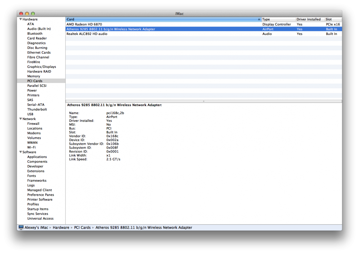

existation Posted November 3, 2012 Share Posted November 3, 2012 Works in Lion 10.7.5 with DSDT edit's. Device (ARPT) { Name (_ADR, Zero) Name (_PRW, Package (0x02) { 0x0B, 0x05 }) Method (_DSM, 4, NotSerialized) { Store (Package (0x0C) { "AAPL,slot-name", Buffer (0x08) { "AirPort" }, "device-id", Unicode ("*"), "device_type", Buffer (0x08) { "AirPort" }, "model", Buffer (0x34) { "Atheros 9285 8802.11 b/g/n Wireless Network Adapter" }, "subsystem-id", Buffer (0x04) { 0x8F, 0x00, 0x00, 0x00 }, "subsystem-vendor-id", Buffer (0x04) { 0x6B, 0x10, 0x00, 0x00 } }, Local0) DTGP (Arg0, Arg1, Arg2, Arg3, RefOf (Local0)) Return (Local0) } } You don't need to edit kext and don't be afraid of Os Updates! BTW what i need to put there? "device-id", Unicode ( "*" ), \\ You can change the "+" to unicode = 2b:??? I want this edit in my dsdt. I think i will see my wifi in pci dev List, am i rigth? Link to comment https://www.insanelymac.com/forum/topic/234570-atheros-ar9285-fix-for-snow-leopard-mavericks/page/7/#findComment-1864737 Share on other sites More sharing options...
LatinMcG Posted November 3, 2012 Share Posted November 3, 2012 Works in Lion 10.7.5 with DSDT edit's. "device-id", Unicode ("*"), [left][color=#000000][font=Verdana, Geneva, sans-serif][size=3]), \\ You can change the "+" to unicode = 2b:???[/size][/font][/color][/left] [left][color=#000000][font=Verdana, Geneva, sans-serif][size=3]I want this edit in my dsdt. I think i will see my wifi in pci dev List, am i [/size][/font][/color][/left] [font=Verdana, Geneva, sans-serif][color=#000000][size=3]rigth?[/size][/color][/font] 2B ? thats not supported natively. 2A is and 30 LOGIC TO IT: MAKE IT THINK ITS 2A OR 30 DEVICE ID THAT IS IN ATHEROS KEXT. what is point of makign it same it already is ?? 2B ? Not in kext of atheros Link to comment https://www.insanelymac.com/forum/topic/234570-atheros-ar9285-fix-for-snow-leopard-mavericks/page/7/#findComment-1864765 Share on other sites More sharing options...
existation Posted November 8, 2012 Share Posted November 8, 2012 I manage this to see in pci :wink2: And i flash rom of my card to get clear log when os is booting. I choose 0x0 in select country. And now I get this: I am Happy. BTW! Anybody knows how to get bluetooth on my MB Asus P8Z68V-Pro with out booting in other OS first? Note I don't use a Cham or Chimera or XPC boot. Only Clover. Link to comment https://www.insanelymac.com/forum/topic/234570-atheros-ar9285-fix-for-snow-leopard-mavericks/page/7/#findComment-1865780 Share on other sites More sharing options...
