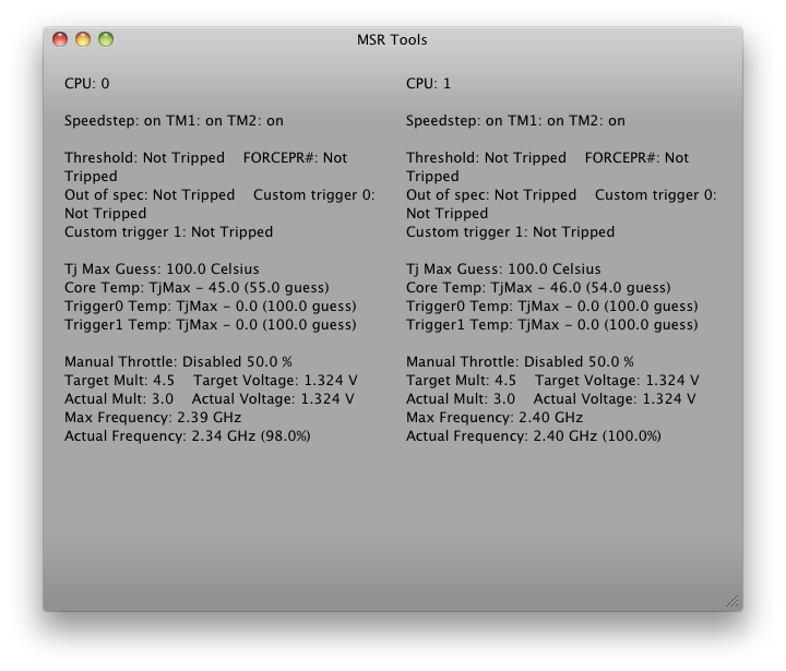

Hi MaLd0n,
as always thanks for your advice. I haven't upgraded yet to 10.6.7 (still 10.6.6, Chameleon 2 RC5) but things are working well, except Speedstep. I have it enabled in /Extra/com.apple.Boot.plist:
<key>GeneratePStates</key>
<string>Yes</string>
<key>GenerateCStates</key>
But MSR Tools show actual frequ. and max. frequ. as the same (no load). Any suggestions? Bios settings?
Best,
aMuse

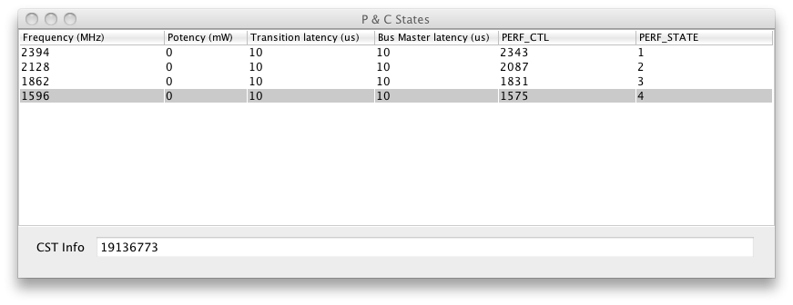

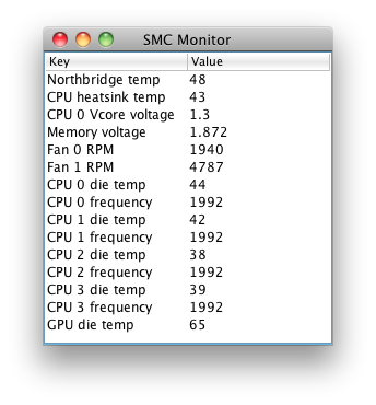

Hi MaLd0n,
thanks. Which FakeSMC are you using with the SMC Monitor?
Also, can you send me a snapshot of you P & C States (SMC Monitor)? My Frequency (MHz) and PERF_CTL differ quite a bit.
aMuse
Hi MaLd0n,
aMuse
FAKESMC.zip
use in S/L/E

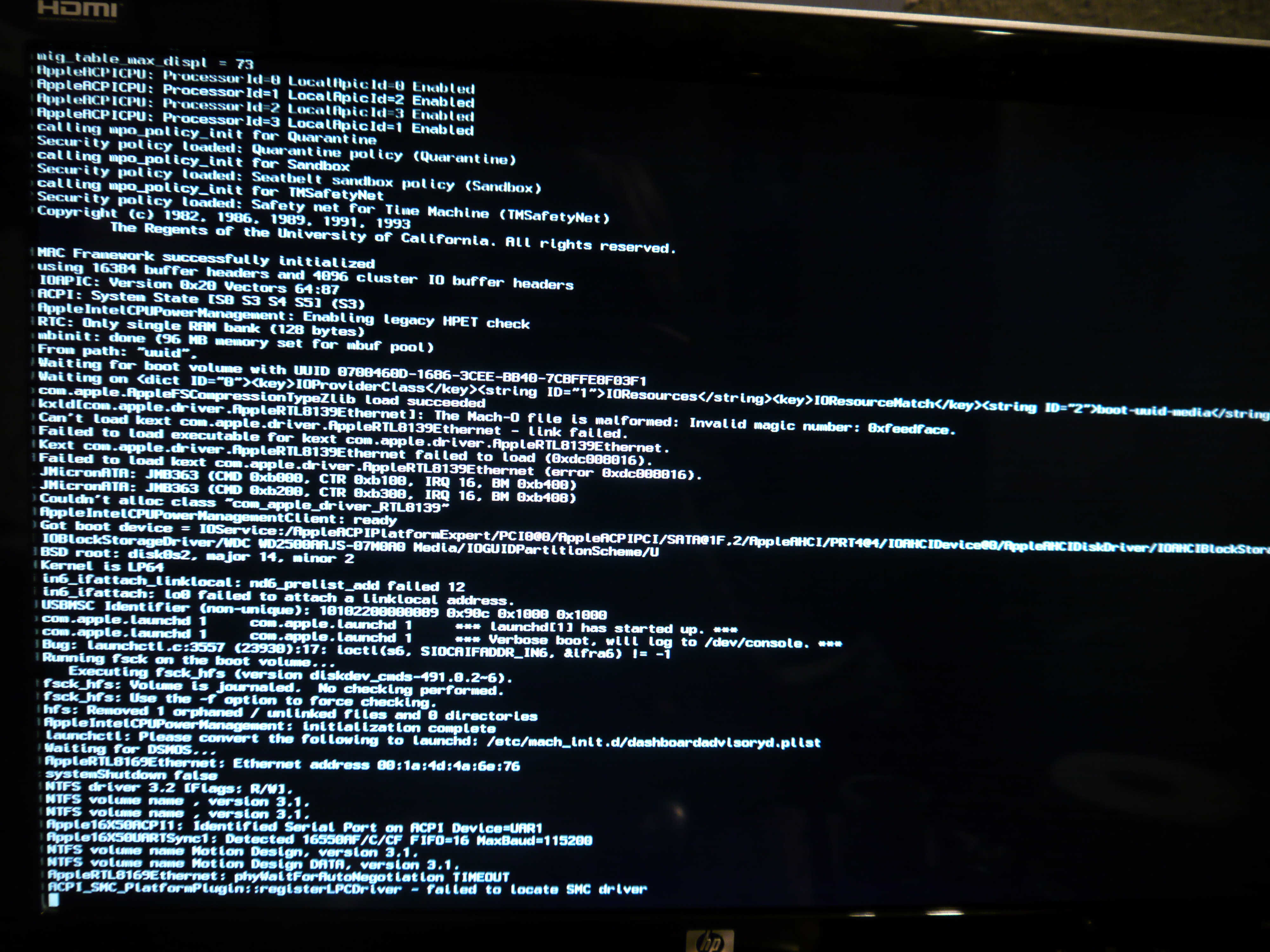

Hi, thanks for your tutorial.
Here are my specs:
Ga P35-DS3
Q6600
Nvidia GTS 450
8GB DDr2 Ram
I've installed everything like you've explained in the first post. Copy the Extra folder, install Chameleon RC5, generate DSDT and copy to EXTRA folder. (Update to 10.6.7)
But then, after rebooting, it hangs after some time at "failed to locate SMC Driver" (look at the attached pic). Same thing with safe mode.
If I try to boot from Boot CD, I get Kernel Panics.
Thats very inconvenient cause everytime I try something new I have to reinstall Snow Leopard because I'm unable to get back into the OS after I did the Post installation thing.
I guess it's about my Graphic Card?
Thanks for help,
Tobi
try with -f -v
I think he's got permissions problems, FakeSMC is not loading. If he just copied the Extra folder content from within OSX then permissions must be broken.
I copied the Extra folder, but there is no FakeSMC.kext in Extra/Extensions.
Is that the Problem? It's the Extra-folder from OP.
I'm a bit confused, there is this other Thread "Snow Leopard on Gigabyte Mobos" where I can download the Extra-folder according to the cpu I've installed. There is a fakesmc.kext.
But not in this thread...
\õ>
use in S/L/E
FakeSMC_TEMP.zip
I will update the topic
just copy to root of HD
not need to repair permissions
in folder S/L/E that need repair
