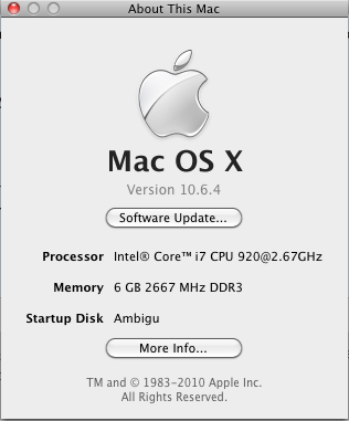

makosx Posted August 26, 2010 Share Posted August 26, 2010 ASUS P6T Intel i7 920 - SL 10.6.4 Everything is OK over here after update. Anyhow, I have had to update the netkas EFI 6 too, because the apple graphics improvement affects to my About This Mac, where it shows a wrong CPU. After netkas EFI everything's right. I even edit the NVDANV50Hal to include my card device ID (0x061a), and, I think, 3D software seems very good more than before. Link to comment https://www.insanelymac.com/forum/topic/228757-snow-leopard-graphics-update-10/page/4/#findComment-1537766 Share on other sites More sharing options...

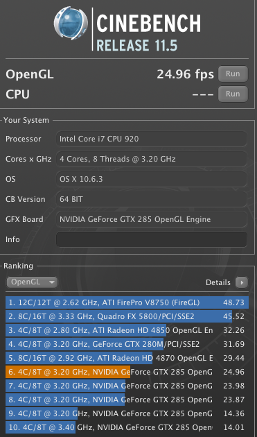

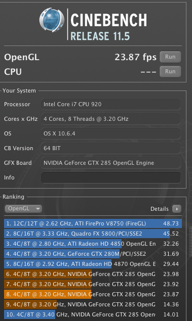

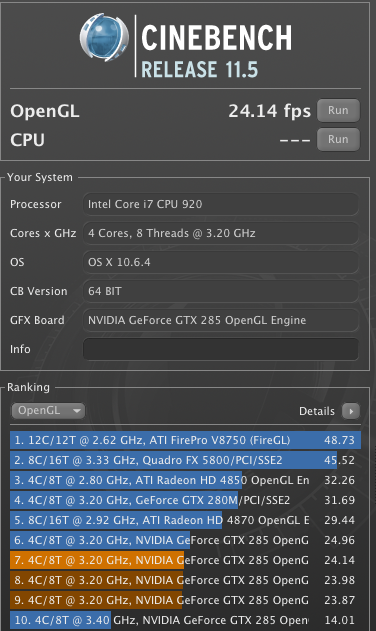

d00d Posted August 27, 2010 Share Posted August 27, 2010 Weird I applied the update via software update, when it came out. I'll try applying the update and report back (after backing up as a just incase) Did the manual update, now running 1.6.18.18 with no change in performance still a little lower than it should be but 23.92 fps at last test with cinebench. heres the same info requested by d00d before, after the manual download and update out.rtf I'm not sure why you have good performance and I don't.Anyone else with a GTX 285 have their original GPU scores in CINEBENCH or Open GL Extensions Viewer, after applying MacOSXUpd10.6.4 or SnowLeopardGraphicsUpdate1.0? Do you mean the Mac version BIOS? Out of interest. what are the other likely effects of using a model id of MacPro3,1? It seems to have to effect on performance of the CPU memory etc (pretty itdentical geekbench scores). so I assume the turbo boost, and memory bandwidth etc are unaffected by the model id? Cheers Jon I flashed with an EVGA PC BIOS.The ROM on the PC GPUs isn't large enough to hold the Mac BIOS. As far as I can tell using MacPro3,1 is cosmetic other than this issue. Others have written that updates won't happen correctly on X58 hardware if not using MacPro4,1. Link to comment https://www.insanelymac.com/forum/topic/228757-snow-leopard-graphics-update-10/page/4/#findComment-1538112 Share on other sites More sharing options...

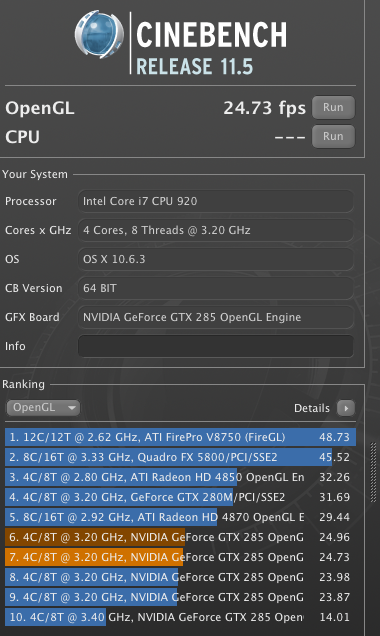

quattrofx Posted August 27, 2010 Share Posted August 27, 2010 Good news! Aperture Update is out and Newest CUDA Driver 3.1.14 is out! So I installed Graphics Update 1.0 again and updated Aperture & CUDA. After Update everything works OK, but after some more tests no significant increase noticed. Here are my test results before update: http://www.insanelymac.com/forum/index.php...t&p=1520788 I will post today results after update... d00d & sidewinder33 can you post yours allso? How do you inject your cards and what boot-loader are you using?Thanks! Cheers QuattroFX Link to comment https://www.insanelymac.com/forum/topic/228757-snow-leopard-graphics-update-10/page/4/#findComment-1538117 Share on other sites More sharing options...

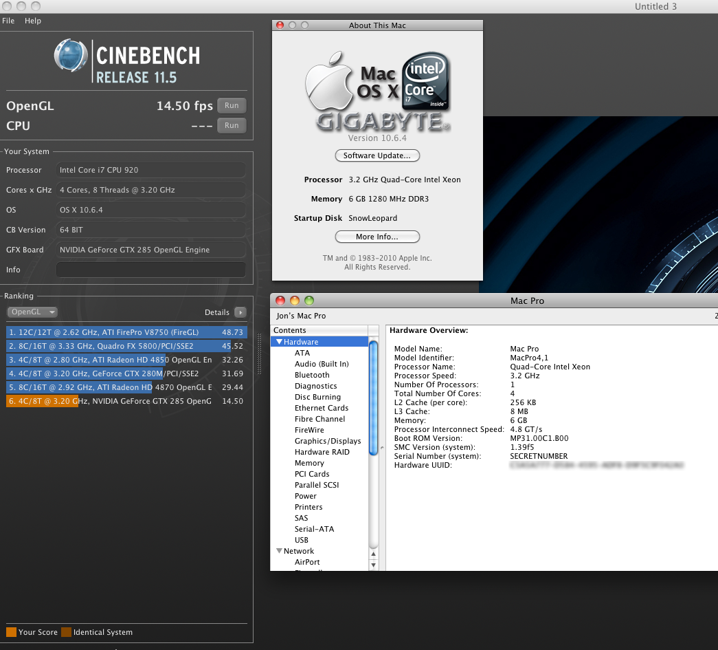

jhrfc Posted August 27, 2010 Share Posted August 27, 2010 As far as I can tell using MacPro3,1 is cosmetic other than this issue.Others have written that updates won't happen correctly on X58 hardware if not using MacPro4,1. Thanks. I guess to be cautious i could set the id to 4,1 when applying updates. I'm not sure why you have good performance and I don't.Anyone else with a GTX 285 have their original GPU scores in CINEBENCH or Open GL Extensions Viewer, after applying MacOSXUpd10.6.4 or SnowLeopardGraphicsUpdate1.0? Here we go. I don't have cinebench marks from 10.6.3, but empirically the are the same as now with id of 3,1. eg 30fps 10.6.4 MacPro3,1 pre graphics update 10.6.4 MacPro4,1 pre graphics update 10.6.4 MacPro3,1 post graphics update 10.6.4 MacPro4,1 post graphics update Cheers Jon Link to comment https://www.insanelymac.com/forum/topic/228757-snow-leopard-graphics-update-10/page/4/#findComment-1538130 Share on other sites More sharing options...

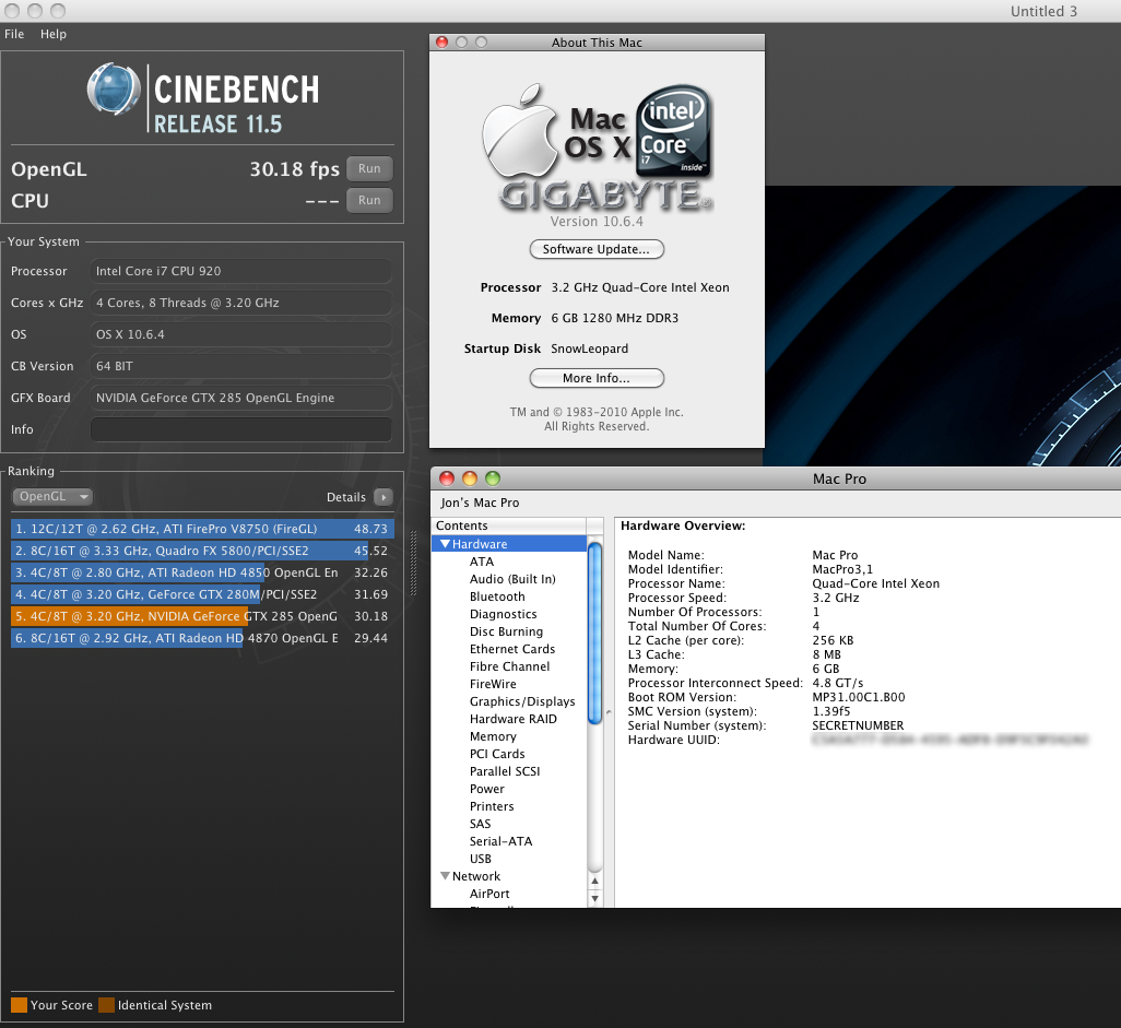

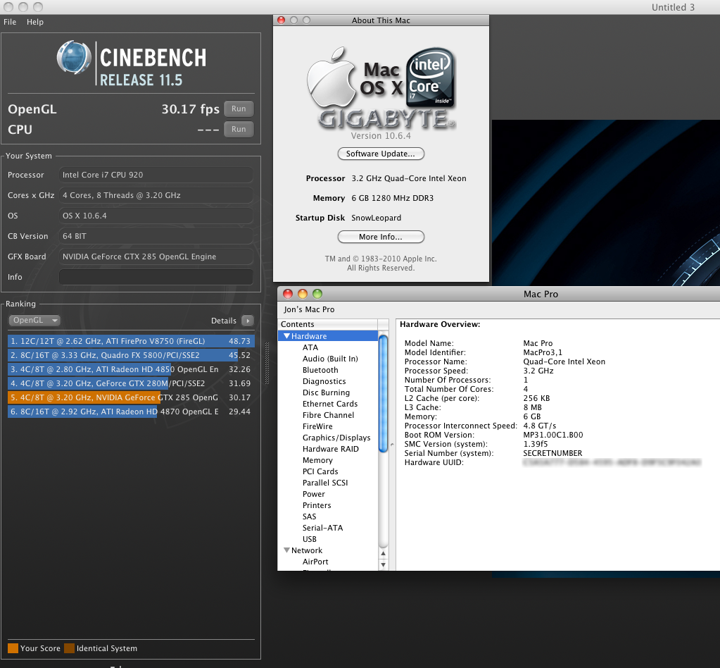

Sidewinder33 Posted August 27, 2010 Share Posted August 27, 2010 Alright I dont have pre and post update stats but I have 10.6.3 and 10.6.4 and MacPro3,1 and MacPro4,1 stats for my system. I could have swore thought that I used to hit 30 fps with 10.6.4 and MacPro3,1 id. I went back to 4,1 because the gpu would get super hot after a sleep cycle, as described by d00d in his native power management thread. Something to do with the gpu not clocking back down after sleep, (or something to that effect d00d will probably explain it much better after me) * my 10.6.4 scores are post graphics update* 10.6.4 MacPro4,1 10.6.4 MacPro3,1 10.6.3 MacPro4,1 10.6.3 MacPro3,1 Also my scores pre update were in the 12-14fps range. Link to comment https://www.insanelymac.com/forum/topic/228757-snow-leopard-graphics-update-10/page/4/#findComment-1538461 Share on other sites More sharing options...

d00d Posted August 27, 2010 Share Posted August 27, 2010 Alright I dont have pre and post update stats but I have 10.6.3 and 10.6.4 and MacPro3,1 and MacPro4,1 stats for my system. I could have swore thought that I used to hit 30 fps with 10.6.4 and MacPro3,1 id. I went back to 4,1 because the gpu would get super hot after a sleep cycle, as described by d00d in his native power management thread. Something to do with the gpu not clocking back down after sleep, (or something to that effect d00d will probably explain it much better after me)* my 10.6.4 scores are post graphics update* ... It may be your newer pci3842,1180 EVGA BIOS, I was only able to find the older pci3842,1281 to flash with.If you have time, would you dump your BIOS with nvflash so that I can test with it? It's at; http://www.techpowerup.com/downloads/1824/...%20Windows.html Thanks. For X58 MBs and a GTX 285 with degraded performance, edit the AppleGraphicsPowerManagement.kext/Contents/Info.plist's MacPro4,1 section and change Vendor10deDevice05e2 to Vendor10deDevice05e3. This will keep level 0 low power mode on gpu under low load after sleep and wake, but shader and memory will be stuck in level 2 high power mode. GPU temperatures before, and after sleep and wake are still less than using MacPro3,1 or deleting AppleGraphicsPowerManagement.kext, which causes gpu, shader and memory to always run in level 2 high power mode. I've tested this using nvclock with device-properties video string or DSDT video modification, but not with GraphicEnabler. Link to comment https://www.insanelymac.com/forum/topic/228757-snow-leopard-graphics-update-10/page/4/#findComment-1538526 Share on other sites More sharing options...

jhrfc Posted August 28, 2010 Share Posted August 28, 2010 This will keep level 0 low power mode on gpu under low load after sleep and wake, but shader and memory will be stuck in level 2 high power mode. Thanks. Strangely this is exactly the results I get simply by setting my model id to MacPro3,1 (even after sleeping, I rarely reboot). see nvclock results for 3,1 As 4,1 the GPU clock seems to stick in level 0 all the time. MacPro3,1 idle -- General info -- Card: GT200b [GeForce GTX 285] Architecture: GT200 B1 PCI id: 0x05e3 Subvendor id: 0x19da GPU clock: 300.856 MHz Bustype: PCI-Express -- Shader info -- Clock: 1296.000 MHz Stream units: 240 (11111111b) ROP units: 32 (11111111b) -- Memory info -- Amount: 1024 MB Type: 512 bit DDR3 Clock: 1188.000 MHz -- PCI-Express info -- Current Rate: 16X Maximum rate: 16X -- Sensor info -- Sensor: Analog Devices ADT7473 Board temperature: 38C GPU temperature: 42C Fanspeed: 850 RPM Fanspeed mode: manual PWM duty cycle: 40.0% -- VideoBios information -- Version: 62.00.58.00.03 Signon message: GT200 P892 SKU 0052 VGA BIOS Performance level 0: gpu 300MHz/shader 600MHz/memory 100MHz/1.05V/100% Performance level 1: gpu 400MHz/shader 800MHz/memory 300MHz/1.05V/100% Performance level 2: gpu 648MHz/shader 1476MHz/memory 1242MHz/1.15V/100% VID mask: 1 Voltage level 0: 1.05V, VID: 1 Voltage level 1: 1.15V, VID: 0 MacPro3,1 load. Card: GT200b [GeForce GTX 285] Architecture: GT200 B1 PCI id: 0x05e3 Subvendor id: 0x19da GPU clock: 648.000 MHz Bustype: PCI-Express -- Shader info -- Clock: 1476.000 MHz Stream units: 240 (11111111b) ROP units: 32 (11111111b) -- Memory info -- Amount: 1024 MB Type: 512 bit DDR3 Clock: 1242.000 MHz -- Sensor info -- Sensor: Analog Devices ADT7473 Board temperature: 43C GPU temperature: 54C Fanspeed: 829 RPM Fanspeed mode: manual PWM duty cycle: 40.0% idle3_1.txt load3_1.txt Link to comment https://www.insanelymac.com/forum/topic/228757-snow-leopard-graphics-update-10/page/4/#findComment-1538816 Share on other sites More sharing options...
