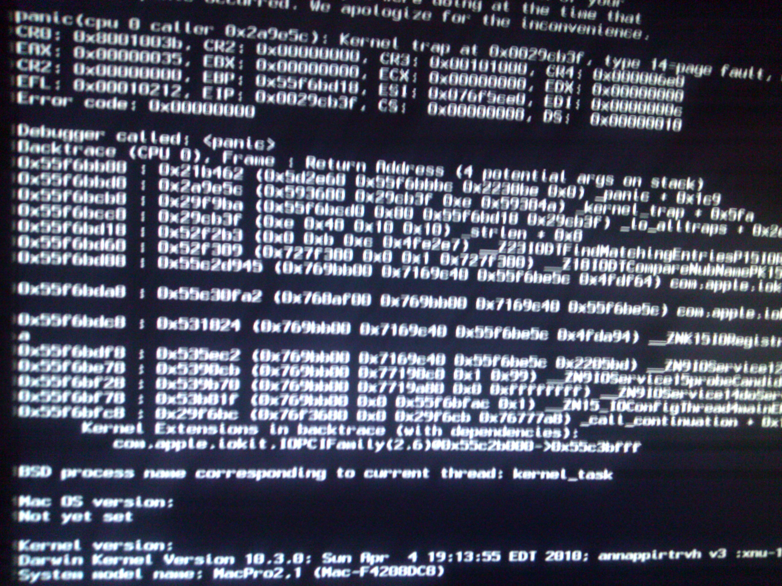

Hi everyone,
I'm getting stuck exactly at "mbinit: done (64 MB memory set for mbuf pool)" just like Addy2k! Other times I get stuck at the USBF or the EHCI. It's completely random. And sometimes the old familiar waiting for root device error. For a limited time I was able to boot (like 10% of the time), but now no luck anymore. I'm assuming it has to do with the hard drives kexts or something.
I've tried reinstalling but I can't even get to the installer anymore. It gets stuck at the same places as I mentioned above, and sometimes after fakesmc.
My mainboard is Asrock 870 Extreme3, Cpu is X6 1055T. All CPU-specific BIOS options are off, and hard drives are on AHCI, DVD-rom on SATA. It's just weird I can't even get to the installer anymore. Any help would be greatly appreciated! Especially from people with the same mobo.
Thanks
After a lot of troubleshooting I found the solution for my mbinit... problem. It was either my keyboard, or the 4 port USB 2.0 hub, the keyboard was attached to. When I read some boot logs from other people that I found in the web, I realized, that the next step after this mbinit... stuff contained some usb related messages, so I decided to give it a try, and it worked using another keyboard and attaching it directly to the PC while disconnecting the 4 port USB hub. Hope this will help you too JoSe7en.

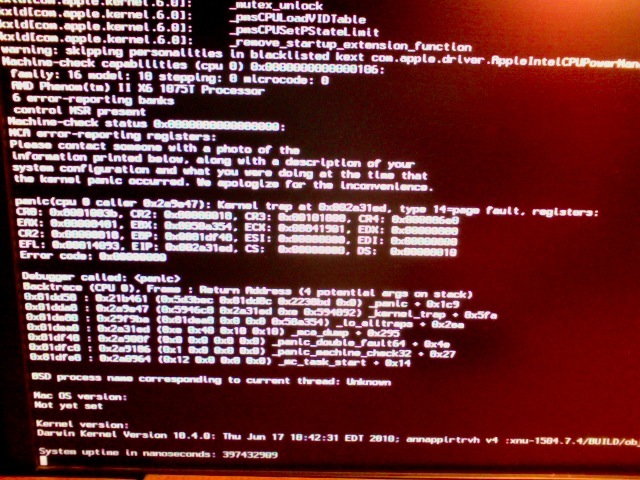

I got the snow leapard cd now (was using the wrong one) but its still not working.
My computer speccs are:
mb: crosshair IV formula
processor: AMD Phenom II X6 1075T
Ram: corsair XMS3 4x 2gb
Can't get it to work with OSX Snowleopard.
