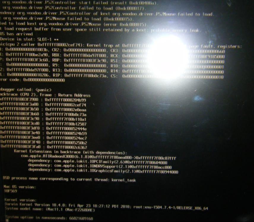

natano2010 Posted October 16, 2010 Share Posted October 16, 2010 Hi try to replace these kexts http://dl.dropbox.com/u/9173457/ATI%20Kexts.zip and of course repair permissions. Let me know how it goes I tried, but still get this "ATIRadeonX3000" (when i injected device ID = 0x689e1002 in ati5xxx and ati3xxx kexts) Maybe I chose a combination of the worst (ASROCK and ATI-5830). If some thread or GUI ,Youtobe vedio that successfully installed drive about ATI5830. I will study and concern and try not to give up. any way thanks very much , likewise and digitalsin Link to comment https://www.insanelymac.com/forum/topic/224063-rhd-550056005830/page/6/#findComment-1565165 Share on other sites More sharing options...
digitalsin Posted October 16, 2010 Share Posted October 16, 2010 I tried, but still get this "ATIRadeonX3000" (when i injected device ID = 0x689e1002 in ati5xxx and ati3xxx kexts) Well you didnt have to inject device ID because the ones i gave you already have Device Id in it (thats why i gave you those ) Link to comment https://www.insanelymac.com/forum/topic/224063-rhd-550056005830/page/6/#findComment-1565169 Share on other sites More sharing options...

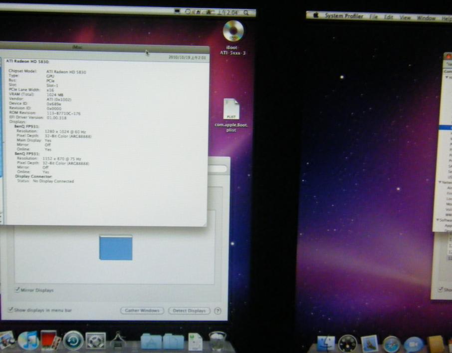

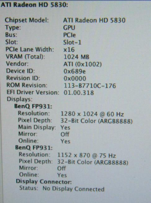

natano2010 Posted October 18, 2010 Share Posted October 18, 2010 http://www.insanelymac.com/forum/index.php...st&id=77473 <----boot=UakariChameleon-2.0-RC5-r516 mac_os_x_10.6.5_10h555_delta_updatereversioner and Pics http://dl.dropbox.com/u/9173457/pics.zip Hi digitalsin , I get succeeded!! (Use your kext , and Chameleon 2.0 R516) When I connect two screens,(VGA adapter & DVI cable), then it work . If only connect single screen, I get DVI black , VGA is white lines screen. So connect two screens that also a key point. Any way , really thank you Digitalsin. Give me support and advice, let my HIS HD5830 get work on the 64-bit. But another problem When I only use single screen, I must maintain a persistent connection of two cable on HD5830. If only connect one cable, I can't successfully boot osx. (DVI is black, VGA is white lines) Any way to properly support a single monitor mode ? Maybe my system without DSDT, so boot very quickly. After this , I will try to learn how to make it work better. (on 10.6.4 or 10.6.5) Thanks again Digitalsin. Link to comment https://www.insanelymac.com/forum/topic/224063-rhd-550056005830/page/6/#findComment-1566102 Share on other sites More sharing options...
digitalsin Posted October 18, 2010 Share Posted October 18, 2010 Hi digitalsin , I get succeeded!! (Use your kext , and Chameleon 2.0 R516) When I connect two screens,(VGA adapter & DVI cable), then it work . If only connect single screen, I get DVI black , VGA is white lines screen. So connect two screens that also a key point. Any way , really thank you Digitalsin. Give me support and advice, let my HIS HD5830 get work on the 64-bit. But another problem When I only use single screen, I must maintain a persistent connection of two cable on HD5830. If only connect one cable, I can't successfully boot osx. (DVI is black, VGA is white lines) Any way to properly support a single monitor mode ? Maybe my system without DSDT, so boot very quickly. After this , I will try to learn how to make it work better. (on 10.6.4 or 10.6.5) Thanks again Digitalsin. thats ok, happy to help.....since i'm learning my self. i havent figure out the monitor thing yet but am guessing we need a different framebuffer, i have tried a few but not all. and hopefully that (framebuffer) will unlock QE/CI aswell. And if you do find out the problem please share it with us cheers Link to comment https://www.insanelymac.com/forum/topic/224063-rhd-550056005830/page/6/#findComment-1566144 Share on other sites More sharing options...
