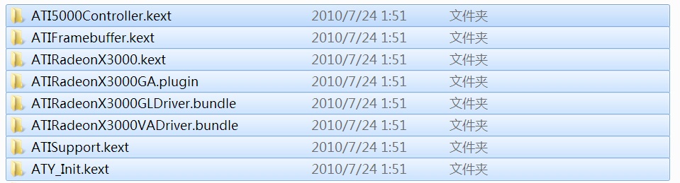

131 Posted July 22, 2010 Share Posted July 22, 2010 using atiradeonx3000.kext, and all other drivers. It means i need delete the ati5000controller.kext and use the other kexts and ati_int.kext will be let my HD5670 1gb DDR5 work? My card is ASUS HD5670 1GB DDR5 device id is same as yours, but after i put the kexts and use terminal as follows: rm -rf /System/Library/Extensions.kextcache rm -rf /System/Library/Extensions.mkext chown -R root:wheel /System/Library/Extensions chmod -R 755 /System/Library/Extensions diskutil repairpermissions / after reboot the computer, everything is no change.. why?Display: Type: GPU Bus: PCIe PCIe Lane Width: x16 VRAM (Total): 256 MB Vendor: ATI (0x1002) Device ID: 0x68d8 Revision ID: 0x0000 Kernel Extension Info: No Kext Loaded Displays: Display: Resolution: 1024 x 768 Pixel Depth: 32-Bit Color (ARGB8888) Main Display: Yes Mirror: Off Online: Yes Link to comment https://www.insanelymac.com/forum/topic/224063-rhd-550056005830/page/2/#findComment-1516174 Share on other sites More sharing options...
DaviDemon Posted July 22, 2010 Share Posted July 22, 2010 You need everything that he uploaded. So, ATY_Init, and all the drivers. Try using "kext helper b7" to install your kexts. Then repair permissions in diskutil. Link to comment https://www.insanelymac.com/forum/topic/224063-rhd-550056005830/page/2/#findComment-1516285 Share on other sites More sharing options...
131 Posted July 23, 2010 Share Posted July 23, 2010 You need everything that he uploaded. So, ATY_Init, and all the drivers. Try using "kext helper b7" to install your kexts. Then repair permissions in diskutil. Is it kexts as follows? just drag them into kexthelper b7? Link to comment https://www.insanelymac.com/forum/topic/224063-rhd-550056005830/page/2/#findComment-1516887 Share on other sites More sharing options...
DaviDemon Posted July 23, 2010 Share Posted July 23, 2010 Yep. You might get black screens or something. So I suggest you try WITHOUT ATIRadeonX3000.kext first. Link to comment https://www.insanelymac.com/forum/topic/224063-rhd-550056005830/page/2/#findComment-1516927 Share on other sites More sharing options...
131 Posted July 23, 2010 Share Posted July 23, 2010 Yep. You might get black screens or something. So I suggest you try WITHOUT ATIRadeonX3000.kext first.Use only ati5000controler.kext,atiframebuffer.kext, atisupport.kext Ati_init.kext, i will try. My hackintoshi is AMD processer and 785g+sb750 chipset., use all kexts with kexthelper b7, after "it looks be fine, cross fingers and reboot" 6 seconds, i got screen panic.... no time to fix permissions. Thank very much for your kindly reply, Davidemon. Link to comment https://www.insanelymac.com/forum/topic/224063-rhd-550056005830/page/2/#findComment-1517368 Share on other sites More sharing options...

131 Posted July 24, 2010 Share Posted July 24, 2010 nice. (:but thank netkas for spoonfeeding me. hehe As the reason for panic, could you send your kexts which are working by email to kaf@live.cn? After kext helper, fullscreen will show panic...no time to repair permission. i think our cards be the same. Thank you very much,. kaf Link to comment https://www.insanelymac.com/forum/topic/224063-rhd-550056005830/page/2/#findComment-1517535 Share on other sites More sharing options...

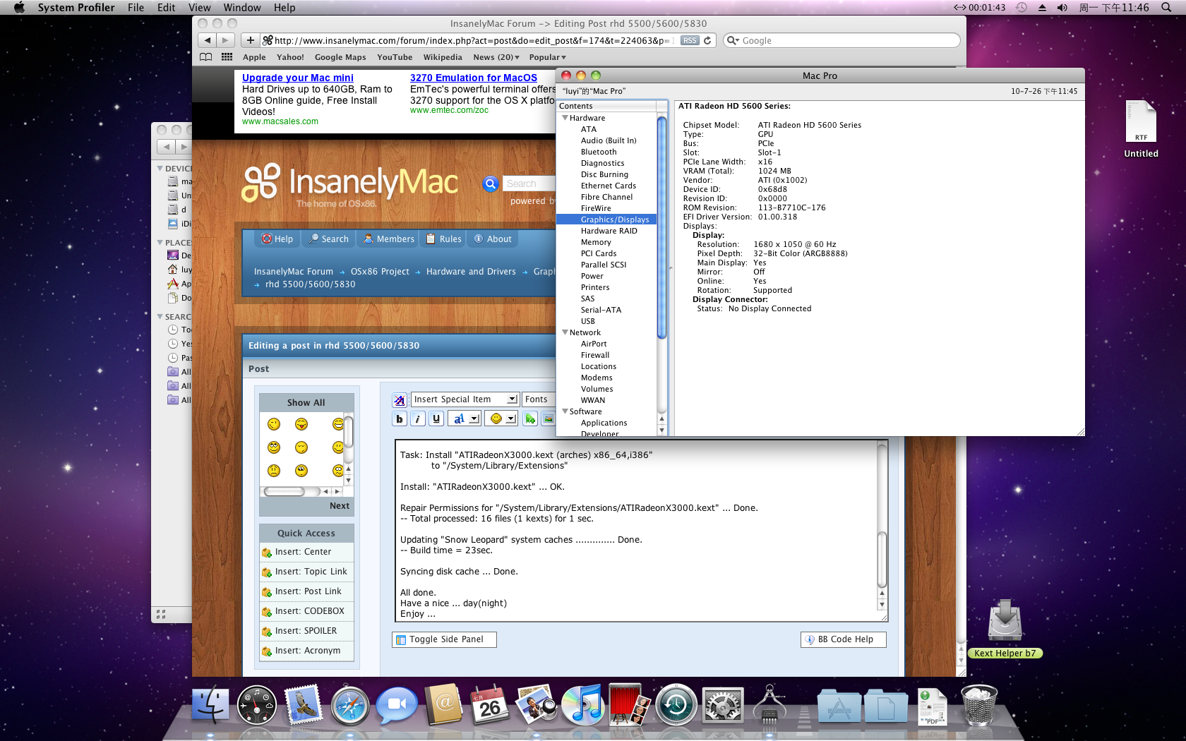

131 Posted July 25, 2010 Share Posted July 25, 2010 now work in leopard 10.6.3. Oh yeah! but No QE/CI!! ATI Radeon HD 5600 Series: Chipset Model: ATI Radeon HD 5600 Series Type: GPU Bus: PCIe Slot: Slot-1 PCIe Lane Width: x16 VRAM (Total): 1024 MB Vendor: ATI (0x1002) Device ID: 0x68d8 Revision ID: 0x0000 ROM Revision: 113-B7710C-176 EFI Driver Version: 01.00.318 Displays: Display: Resolution: 1680 x 1050 @ 60 Hz Pixel Depth: 32-Bit Color (ARGB8888) Main Display: Yes Mirror: Off Online: Yes Display Connector: Status: No Display Connected Next step is open qe/ci. god bless me. Link to comment https://www.insanelymac.com/forum/topic/224063-rhd-550056005830/page/2/#findComment-1518402 Share on other sites More sharing options...
131 Posted July 26, 2010 Share Posted July 26, 2010 -- Kext Utility x64 for MAC OS X -- v2.4.2 © cVad 2009. - Repairer kexts permissions - - mkext Packer/UnPacker - - kexts Installer - www.applelife.ru www.torrentmac.ru ProductName : Mac OS X ProductVersion: 10.6.3 BuildVersion: 10D578 Bootargs : boot-uuid=D81EC2D8-31F4-3D01-8296-219452735CC6 rd=*uuid platform=ACPI -f -v Kernel : Darwin Kernel Version 10.3.0: Fri Apr 9 16:36:07 CST 2010 Model ID : MacPro2,1 KernelMode: i386 CPU TYPE : AMD Phenom II X4 B35 Processor Core : 2328MHz Bus: 99MHz FSB: 396MHz CPU ID : Ox100F52 (1052498) Cache L2: 512Mb RAM : 2048Mb HibernateMode: 0 SwapUsage : total = 64.00M used = 0.00M free = 64.00M User : luyi on 83.173.227.121.broad.sz.js.dynamic.163data.com.cn Start working: Tue Jul 27 07:39:26 EAT 2010 Detected ... MAC OS X "Snow Leopard". Task: Install "ATIRadeonX3000.kext (arches) x86_64,i386" to "/System/Library/Extensions" Install: "ATIRadeonX3000.kext" ... OK. Repair Permissions for "/System/Library/Extensions/ATIRadeonX3000.kext" ... Done. -- Total processed: 16 files (1 kexts) for 1 sec. Updating "Snow Leopard" system caches .............. Done. -- Build time = 23sec. Syncing disk cache ... Done. All done. Have a nice ... day(night) Enjoy ... Link to comment https://www.insanelymac.com/forum/topic/224063-rhd-550056005830/page/2/#findComment-1519163 Share on other sites More sharing options...
aco Posted July 27, 2010 Share Posted July 27, 2010 I am newbie here. Could you please attach the procedure to make your radeon working as well as what kext that u use. Thanks =aco= -- Kext Utility x64 for MAC OS X -- v2.4.2 © cVad 2009. - Repairer kexts permissions - - mkext Packer/UnPacker - - kexts Installer - www.applelife.ru www.torrentmac.ru ProductName : Mac OS X ProductVersion: 10.6.3 BuildVersion: 10D578 Bootargs : boot-uuid=D81EC2D8-31F4-3D01-8296-219452735CC6 rd=*uuid platform=ACPI -f -v Kernel : Darwin Kernel Version 10.3.0: Fri Apr 9 16:36:07 CST 2010 Model ID : MacPro2,1 KernelMode: i386 CPU TYPE : AMD Phenom™ II X4 B35 Processor Core : 2328MHz Bus: 99MHz FSB: 396MHz CPU ID : Ox100F52 (1052498) Cache L2: 512Mb RAM : 2048Mb HibernateMode: 0 SwapUsage : total = 64.00M used = 0.00M free = 64.00M User : luyi on 83.173.227.121.broad.sz.js.dynamic.163data.com.cn Start working: Tue Jul 27 07:39:26 EAT 2010 Detected ... MAC OS X "Snow Leopard". Task: Install "ATIRadeonX3000.kext (arches) x86_64,i386" to "/System/Library/Extensions" Install: "ATIRadeonX3000.kext" ... OK. Repair Permissions for "/System/Library/Extensions/ATIRadeonX3000.kext" ... Done. -- Total processed: 16 files (1 kexts) for 1 sec. Updating "Snow Leopard" system caches .............. Done. -- Build time = 23sec. Syncing disk cache ... Done. All done. Have a nice ... day(night) Enjoy ... Link to comment https://www.insanelymac.com/forum/topic/224063-rhd-550056005830/page/2/#findComment-1519970 Share on other sites More sharing options...
131 Posted July 27, 2010 Share Posted July 27, 2010 I am newbie here. Could you please attach the procedure to make your radeon working as well as what kext that u use. Thanks =aco= I used all text from netkas, just first step use except x3000.kext, all kexts be installed by kext ulity. My email kaf@live.cn , i can e-mail to you detail information. Link to comment https://www.insanelymac.com/forum/topic/224063-rhd-550056005830/page/2/#findComment-1519973 Share on other sites More sharing options...
