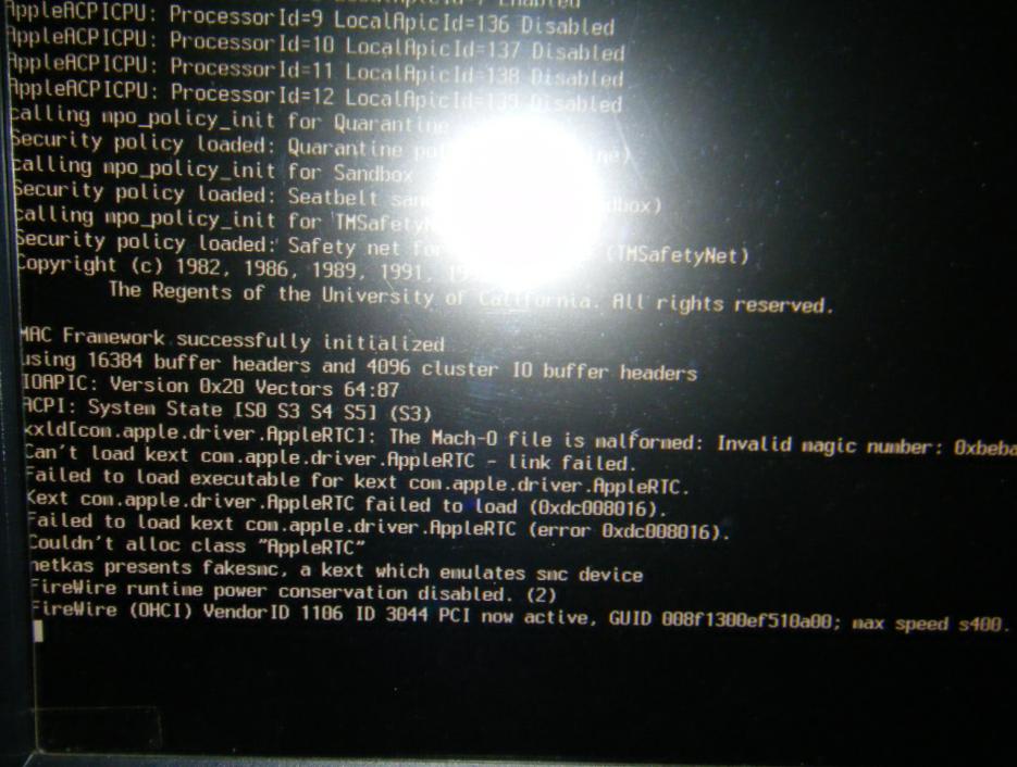

hi guys i have a problem.. :angel: i tried to follow Maxato's method but without success. On my retail leopard 10.6.4 i installed graphic update, the installation went well so before rebooting i tried to find all the 4 ATIRadeonX3000 kexts that he mentioned..... but i can't find them!! so after rebooting my screen goes in power saving mode... can someone help me please? thanks ;)
Heyyo,
Pivy, try to boot into single user mode. Once in there do both the /sbin commands that appear.
After that? do..
cd /system/library/extensions
then try...
rm -rf atix3000support.kext
You really just need to delete that one and the rest like the plugin should not matter since it's the kext that loads it. After that just type reboot and see if it works ok! If not? then do the same but do ati5000controller.kext as well.
the_mard thanks for your help. So this is the situation: i did i fresh install of snow leopard retail 10.6.4 then i run the graphic update with no errors so i deleted all the 4 kext in the finder and added the ATY_Init.kext, edited com.apple.Boot.plist and the rebooted. Result: after a few seconds of loading my screen turns off (in power saving mode). I have a vtx3d 5670 512 mb ddr5... and i tried to boot in single user mode but it stucks after a couple of seconds. What did i do wrong? Thanks!
Hmm, did you boot into verbose mode? Tell us what happens when it gets stuck when trying to boot to single user mode.
I have a 5670 although not a VTX3D. You MAY need a fresh install. NOT SURE. Last resort. I've re-installed mine 7 times trying to get everything to work. Still a bit choppy. ;P

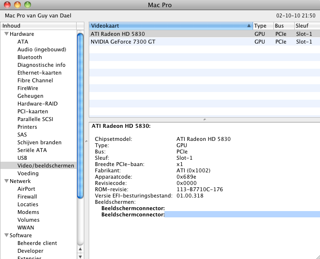

Hi, I have a MacPro 1.1 with a defect NVidea Geforce 7300GT. I have added a Radeon HD5830 which is detected in hardware config, but my DVI outputs are not active. What is your solution with your succesfull configuration?

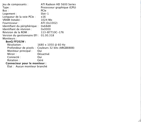

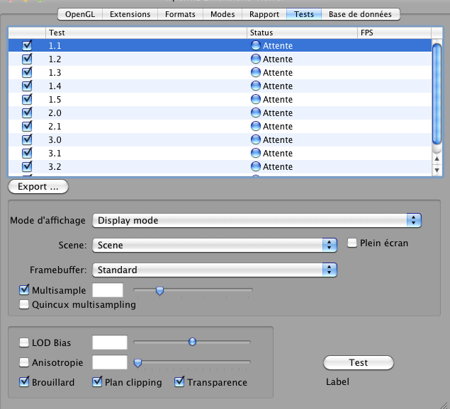

hi,
I followed maxato instructions, could start with my graphic card enabled but can not run the openGl tests !!
I have a gigabyte HD5670.
here are the system profiler infos:

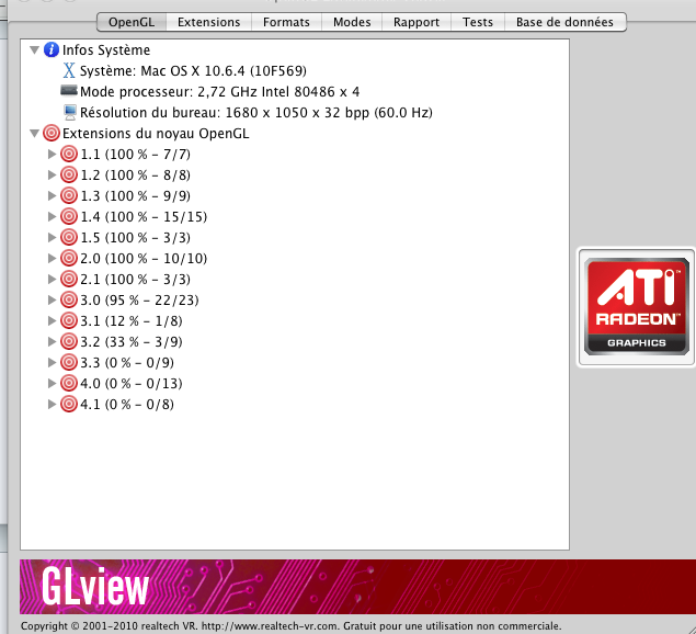

Here are some screenshots of openGl viewer
(sorry, i have the french version) but when i click on Test. Nothing happen !! :P
When i looked in he first 2 panes, everytnig seems OK....

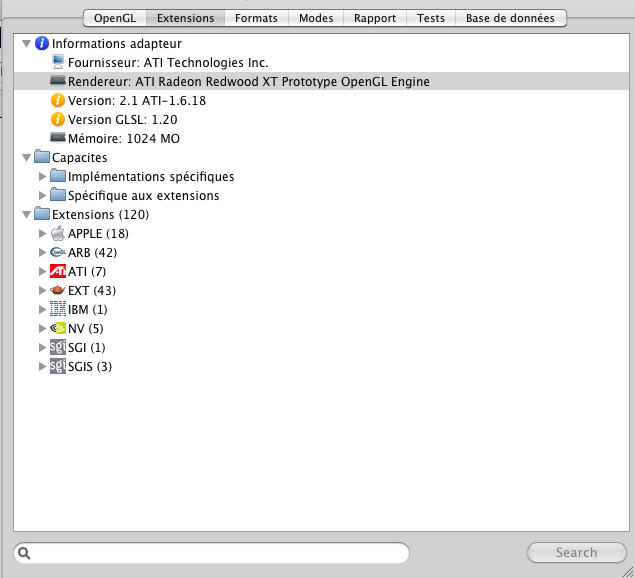

I looked at openGl extensions vieweer logs and found:
07/10/10 00:20:34 OpenGL Extensions Viewer[749] -[GLController downloadXSA:]: unrecognized selector sent to instance 0x181a200
I would appreciate help on this....
thx

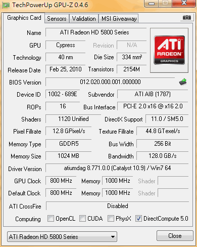

My HIS 5830 still not work (4830 work normal )
I read these articles and thread, and other related etc ..
UPDATED Simple HD 57/58/59xx Installation Using [url=&quot;http://www.insanelymac.com/forum/topic/279450-why-insanelymac-does-not-support-tonymacx86/&quot;]#####[/url]
ATi HD5000 BootLoader ! , need testers
EXPERIMENTAL ATI 5770 GraphicsEnabler = Yes: Guide!!
ATI HD 5770
What i do
Boot using [url=&quot;http://www.insanelymac.com/forum/topic/279450-why-insanelymac-does-not-support-tonymacx86/&quot;]#####[/url] ATI 5xxx-3 and Install OS X 10.6.3 Retail
Use [url=&quot;http://www.insanelymac.com/forum/topic/279450-why-insanelymac-does-not-support-tonymacx86/&quot;]#####[/url] [url=&quot;http://www.insanelymac.com/forum/topic/279450-why-insanelymac-does-not-support-tonymacx86/&quot;]#####[/url] not with user DSDT, and updata 10.6.4(i use ASROCK X58 Extreme3)
Install latest chameleon, replace boot file on root by one of my boot files.
(It makes my GPU fan was not 100%)
Add to boot.plist GPU and UseAtiROM Yes, and get my GPU BIOS 1002_689E.rom put in the extra folde.
Restart and install GFX update 1.0
Still get this
Chipset Model: ATI Radeon HD 5830 Series
Type: GPU
Bus: PCIe
Slot: Slot-1
PCIe Lane Width: x16
VRAM (Total): 256 MB
Vendor: ATI (0x1002)
Device ID: 0x689e
Revision ID: 0x0000
ROM Revision: 113-B7710C-176
EFI Driver Version: 01.00.318
Displays:
Display:
Resolution: 1024 x 768
Pixel Depth: 32-Bit Color (ARGB8888)
Main Display: Yes
Mirror: Off
Online: Yes
Display Connector:
Display Connector:
I also injected device ID = 0x689e1002 in ati5xxx and ati3xxx kexts
with framebuffer = Uakari, 5830.zip (boot), Vervet, Eulemur .... etc 20-30 reboot times.
And i try 32bit (ATY kext), 64bit too, all possible combinations.
Also replaced BIOS ROM here http://www.techpowerup.com/vgabios/73252/H...024.100221.html
5830's VRAM always = 256 MB
This is my boot.plist (in Extra folde)
<dict>
<key> Kernel </ key>
<string> mach_kernel </ string>
<key> Kernel Flags </ key>
<string> arch = x86_64 </ string>
<key> UseAtiROM </ key>
<string> Yes </ string>
<key> GraphicsEnabler </ key>
<key> Timeout </ key>
<string> 1 </ string>
<key> Legacy Logo </ key>
<key> EthernetBuiltIn </ key>
</ Dict>
</ Plist>
My BIOS ROM
I miss somethings?
Please give me some help or give me some advice.
Thanks !!

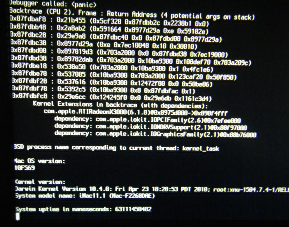

i try "-x" boot in 32 bit get Kernel panic
64bit
DVIX2 port --->VGA port= black screen
DVIx2 port = Broken white screen
