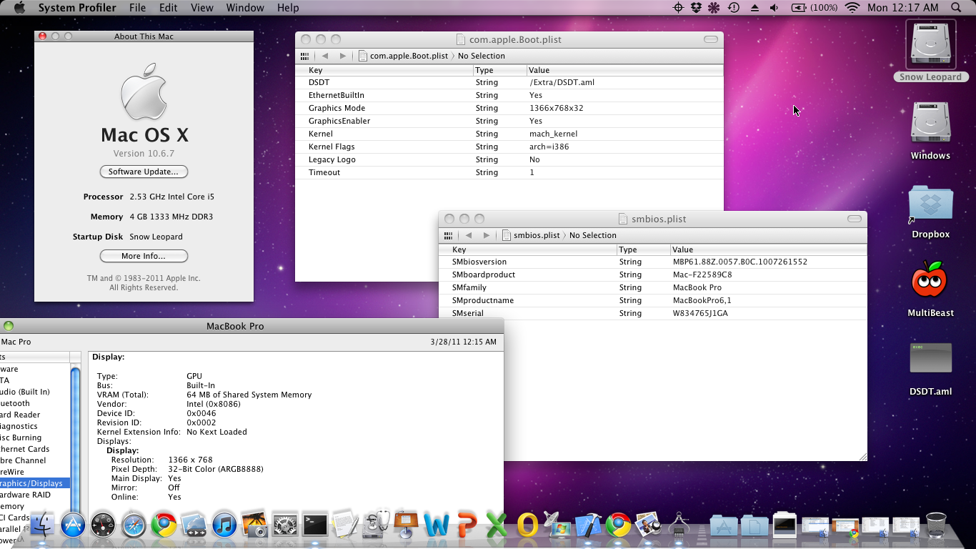

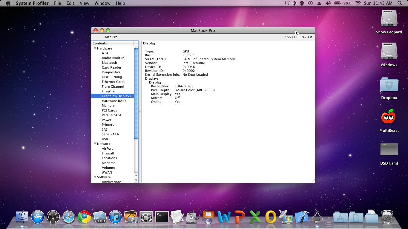

Jedis Posted March 27, 2011 Share Posted March 27, 2011 thanks for reply my message in quick, errm is ur resolution now 1280 x 768? which bootloader are u using? chameleon RC5 or RC4 or bootefi? Chameleon RC5-r699 Resolution 1366x768 Link to comment https://www.insanelymac.com/forum/topic/223754-intel-hd-graphics-gma-5700/page/17/#findComment-1661729 Share on other sites More sharing options...
GhostRaider Posted March 27, 2011 Share Posted March 27, 2011 Chameleon RC5-r699 Resolution 1366x768 This screenshot makes me cry with joy! Then there is hope to get native resolution afterall. Can upgrading to Mac OS X 10.6.7 be one of the steps to get native resolution with Intel HD Graphics? I can see that there is no QE/CI but as long as there's native resolution I'm fine with that! EDIT: Are you using Intel HD Graphics? Hopefully you are. Link to comment https://www.insanelymac.com/forum/topic/223754-intel-hd-graphics-gma-5700/page/17/#findComment-1661767 Share on other sites More sharing options...

Jedis Posted March 27, 2011 Share Posted March 27, 2011 This screenshot makes me cry with joy! Then there is hope to get native resolution afterall. Can upgrading to Mac OS X 10.6.7 be one of the steps to get native resolution with Intel HD Graphics? I can see that there is no QE/CI but as long as there's native resolution I'm fine with that! EDIT: Are you using Intel HD Graphics? Hopefully you are. I had native resolution in 10.6.*. Yes, it's Intel HD Graphics on my Arrandale i5-540M processor. Now that I'm posting this, I'm not sure if I have the GMA 5700. Mine only says Intel HD Graphics. Laptop is a Dell Latitude E4310. Link to comment https://www.insanelymac.com/forum/topic/223754-intel-hd-graphics-gma-5700/page/17/#findComment-1661826 Share on other sites More sharing options...

Jedis Posted March 28, 2011 Share Posted March 28, 2011 Maybe can help a kextstat. What kext you have installed for your video card? I hope this helps. Let me know if you need anything else. Only changes I made to /S/L/E were deleting the AppleIntelHD* kexts, but that was just for the 10.6.6/7 updates. I had native resolution in 10.6.*. I am using a DSDT I generated for my laptop, too, but I believe I had native resolution with just the edits to boot.plist. macosx:~ jedis$ cd /Extra/Extensionsmacosx:Extensions jedis$ ls AppleACPIPS2Nub.kext FakeSMC.kext LegacyAppleRTC.kext VoodooBattery.kext ApplePS2Controller.kext JMicron36xATA.kext NullCPUPowerManagement.kext EvOreboot.kext JMicron36xSATA.kext PlatformUUID.kext macosx:~ jedis$ kextstatIndex Refs Address Size Wired Name (Version) <Linked Against> 1 58 0 0 0 com.apple.kpi.bsd (10.7.0) 2 4 0 0 0 com.apple.kpi.dsep (10.7.0) 3 82 0 0 0 com.apple.kpi.iokit (10.7.0) 4 88 0 0 0 com.apple.kpi.libkern (10.7.0) 5 69 0 0 0 com.apple.kpi.mach (10.7.0) 6 31 0 0 0 com.apple.kpi.private (10.7.0) 7 46 0 0 0 com.apple.kpi.unsupported (10.7.0) 8 0 0 0 0 com.apple.kernel.6.0 (7.9.9) 9 0 0 0 0 com.apple.kernel.bsd (7.9.9) 10 0 0 0 0 com.apple.kernel.iokit (7.9.9) 11 0 0 0 0 com.apple.kernel.libkern (7.9.9) 12 0 0 0 0 com.apple.kernel.mach (7.9.9) 13 11 0x52812000 0x4000 0x3000 com.apple.iokit.IOACPIFamily (1.3.0) <7 6 4 3> 14 15 0x52a0e000 0x11000 0x10000 com.apple.iokit.IOPCIFamily (2.6) <7 5 4 3> 15 2 0x52aaf000 0x42000 0x41000 com.apple.driver.AppleACPIPlatform (1.3.5) <14 13 7 6 5 4 3> 16 0 0x4c5fd000 0x2000 0x1000 es.osx86.driver.EvOreboot (1.0.3) <4 3> 17 0 0x5261f000 0x2000 0x1000 org.tgwbd.driver.NullCPUPowerManagement (1.0.0d2) <7 4 3> 18 0 0x52621000 0x2000 0x1000 com.superhai.driver.PlatformUUID (1.0.0) <4 3> 19 0 0x52a39000 0x4000 0x3000 com.superhai.driver.VoodooBattery (1.2.1) <13 4 3> 20 0 0x52a7d000 0x1e000 0x1d000 com.apple.driver.AppleIntelCPUPowerManagement (105.13.0) <7 6 5 4 3 1> 21 7 0x52b54000 0x18000 0x17000 com.apple.iokit.IOStorageFamily (1.6.2) <7 6 5 4 3 1> 22 0 0x52a9b000 0x11000 0x10000 com.apple.driver.DiskImages (289) <21 7 6 5 4 3 1> 23 0 0x54c1d000 0x8000 0x7000 com.apple.nke.applicationfirewall (2.1.11) <7 6 5 4 3 1> 24 2 0x52bfa000 0x3000 0x2000 com.apple.kext.AppleMatch (1.0.0d1) <4 1> 25 0 0x54c25000 0x5000 0x4000 com.apple.security.quarantine (0) <24 7 6 5 4 2 1> 26 0 0x54c13000 0x8000 0x7000 com.apple.security.sandbox (1) <24 7 6 5 4 2 1> 27 0 0x54c2a000 0x3000 0x2000 com.apple.security.TMSafetyNet (6) <7 6 5 4 2 1> 28 0 0x52bfd000 0x3000 0x2000 com.apple.driver.AppleAPIC (1.4) <4 3> 29 0 0x59797000 0x4000 0x3000 com.apple.driver.AppleSMBIOS (1.6) <7 4 3> 30 0 0x5979b000 0x3000 0x2000 com.apple.driver.AppleHPET (1.5) <13 7 5 4 3> 31 0 0x59899000 0x5000 0x4000 com.apple.driver.AppleRTC (9.9) <13 5 4 3 1> 32 1 0x59895000 0x3000 0x2000 com.apple.iokit.IOSMBusFamily (1.1) <5 4 3> 33 0 0x5988d000 0x6000 0x5000 com.apple.driver.AppleACPIEC (1.3.5) <32 15 13 5 4 3> 34 0 0x598ac000 0x3000 0x2000 com.yourcompany.driver.AppleACPIPS2Nub (1.0.0d1) <13 7 5 4 3 1> 35 3 0x59948000 0x3c000 0x3b000 com.apple.iokit.IOHIDFamily (1.6.5) <7 6 5 4 3 1> 36 0 0x52b4c000 0x4000 0x3000 com.apple.driver.AppleACPIButtons (1.3.5) <35 15 13 7 6 5 4 3 1> 37 0 0x52b41000 0x5000 0x4000 org.netkas.FakeSMC (3.1.0) <13 7 5 4 3> 38 1 0x52b46000 0x3000 0x2000 com.apple.driver.AppleEFIRuntime (1.4.0) <7 6 5 4 3> 39 3 0x598af000 0x6000 0x5000 com.apple.iokit.IOAHCIFamily (2.0.4) <5 4 3 1> 40 0 0x59900000 0x14000 0x13000 com.apple.driver.AppleAHCIPort (2.1.5) <39 14 5 4 3 1> 41 2 0x598d7000 0x6000 0x5000 com.apple.driver.ApplePS2Controller (1.1.0) <7 5 4 3 1> 42 5 0x59a13000 0x2f000 0x2e000 com.apple.iokit.IOUSBFamily (3.8.5) <14 7 5 4 3 1> 43 0 0x598e6000 0x14000 0x13000 com.apple.driver.AppleUSBEHCI (3.7.5) <42 14 7 5 4 3 1> 44 0 0x598fa000 0x6000 0x5000 com.apple.driver.AppleEFINVRAM (1.4.0) <38 7 5 4 3> 45 0 0x598c6000 0x4000 0x3000 com.apple.driver.ApplePS2Keyboard (1.2.0) <41 35 7 6 5 4 3 1> 47 0 0x59765000 0x2000 0x1000 com.apple.iokit.IOUSBUserClient (3.8.5) <42 7 5 4 3 1> 48 0 0x598ca000 0x3000 0x2000 com.apple.driver.ApplePS2Mouse (1.2.0) <41 35 7 6 5 4 3 1> 49 0 0x599d2000 0xf000 0xe000 com.apple.driver.AppleUSBHub (3.8.4) <42 5 4 3 1> 50 0 0x599b7000 0x13000 0x12000 com.apple.iokit.IOAHCIBlockStorage (1.6.3) <39 21 5 4 3 1> 51 2 0x599e1000 0x1a000 0x19000 com.apple.iokit.IOSCSIArchitectureModelFamily (2.6.5) <5 4 3 1> 52 0 0x59914000 0x9000 0x8000 com.apple.iokit.IOAHCISerialATAPI (1.2.5) <51 39 5 4 3 1> 53 0 0x59aa1000 0x3000 0x2000 com.apple.driver.XsanFilter (402.1) <21 5 4 3 1> 54 3 0x59a98000 0x8000 0x7000 com.apple.iokit.IOCDStorageFamily (1.6) <21 5 4 3 1> 55 2 0x59aee000 0x6000 0x5000 com.apple.iokit.IODVDStorageFamily (1.6) <54 21 5 4 3 1> 56 1 0x59b03000 0x5000 0x4000 com.apple.iokit.IOBDStorageFamily (1.6) <55 54 21 5 4 3 1> 57 0 0x59b49000 0x18000 0x17000 com.apple.iokit.IOSCSIMultimediaCommandsDevice (2.6.5) <56 55 54 51 21 5 4 3 1> 59 1 0x59ad7000 0x4000 0x3000 com.apple.driver.AppleUSBComposite (3.7.5) <42 4 3 1> 60 0 0x59adb000 0x3000 0x2000 com.apple.driver.AppleUSBMergeNub (3.8.5) <59 42 4 3 1> 62 0 0x59b17000 0x6000 0x5000 com.apple.AppleFSCompression.AppleFSCompressionTypeZlib (1.0.0d1) <6 4 3 2 1> 63 0 0x59b43000 0x5000 0x4000 com.apple.BootCache (31) <7 6 5 4 3 1> 64 0 0x59ce4000 0xa000 0x9000 com.apple.filesystems.autofs (2.1.0) <7 6 5 4 3 1> 65 2 0x59ccf000 0xa000 0x9000 com.apple.driver.AppleSMC (3.1.0d3) <13 7 5 4 3> 67 1 0x59d36000 0xb000 0xa000 com.apple.driver.IOPlatformPluginFamily (4.5.0d5) <6 5 4 3> 68 0 0x59d4c000 0x10000 0xf000 com.apple.driver.ACPI_SMC_PlatformPlugin (4.5.0d5) <67 65 14 13 7 6 5 4 3> 69 2 0x59d25000 0x9000 0x8000 com.apple.iokit.IOSerialFamily (10.0.3) <7 6 5 4 3 1> 70 0 0x59d68000 0x9000 0x8000 com.apple.driver.Apple16X50Serial (3.0) <69 14 5 4 3> 71 4 0x59cfd000 0x17000 0x16000 com.apple.iokit.IONetworkingFamily (1.10) <7 6 5 4 3 1> 72 1 0x59d98000 0x24000 0x23000 com.apple.iokit.IO80211Family (314.1.1) <71 7 6 5 4 3 1> 73 0 0x5a4da000 0x176000 0x175000 com.apple.driver.AirPortBrcm43224 (427.36.9) <72 71 14 7 5 4 3 1> 74 7 0x59ef6000 0x2b000 0x2a000 com.apple.iokit.AppleProfileFamily (61) <14 7 6 5 4 3 1> 76 0 0x59f4f000 0xf000 0xe000 com.katharsys.driver.IntelE1000e (1.1.2) <71 14 4 3 1> 77 1 0x59d2e000 0x4000 0x3000 com.apple.kext.OSvKernDSPLib (1.3) <5 4> 78 4 0x59f2d000 0x18000 0x17000 com.apple.iokit.IOAudioFamily (1.8.0fc1) <77 5 4 3 1> 79 0 0x59f7b000 0x1f000 0x1e000 org.voodoo.driver.VoodooHDA (2.7.2) <78 14 7 5 4 3> 80 4 0x5a210000 0x22000 0x21000 com.apple.iokit.IOGraphicsFamily (2.2) <14 7 5 4 3> 81 1 0x59f9a000 0xd000 0xc000 com.apple.iokit.IONDRVSupport (2.2) <80 14 7 5 4 3> 83 0 0x59e91000 0x4000 0x3000 com.apple.driver.AudioIPCDriver (1.1.6) <78 5 4 3 1> 84 0 0x59ec0000 0x7000 0x6000 com.apple.driver.AppleIntelNehalemProfile (19) <74 6 4 3> 86 0 0x59ee7000 0x7000 0x6000 com.apple.driver.AppleMCCSControl (1.0.17) <80 14 7 5 4 3 1> 87 0 0x59ebb000 0x4000 0x3000 com.globaldelight.driver.BoomDevice (1) <78 5 4 3 1> 90 0 0x59eb4000 0x5000 0x4000 com.apple.driver.AppleUpstreamUserClient (3.5.4) <80 14 13 7 5 4 3 1> 91 2 0x59f21000 0x5000 0x4000 com.apple.iokit.CHUDKernLib (365) <7 6 5 4 3 1> 93 0 0x52712000 0xc000 0xb000 com.apple.iokit.CHUDProf (366) <91 7 6 5 4 3> 94 0 0x52704000 0x7000 0x6000 com.apple.iokit.CHUDUtils (364) <91 5 4 3 1> 95 0 0x526f8000 0xb000 0xa000 com.apple.driver.AGPM (100.12.19) <81 80 14 5 4 3> 97 0 0x526cf000 0x6000 0x5000 com.apple.Dont_Steal_Mac_OS_X (7.0.0) <65 7 4 3 1> 98 0 0x526e9000 0x9000 0x8000 com.apple.iokit.IOBluetoothSerialManager (2.4.0f1) <69 7 5 4 3 1> 99 0 0x5271e000 0xb000 0xa000 com.apple.iokit.IOSurface (74.2) <7 5 4 3 1> 100 0 0x526cb000 0x3000 0x2000 com.evosx86.driver.lspcidrv (1.0) <4 3> 101 0 0x526d5000 0x4000 0x3000 com.jft.driver.PdaNetDrv (1.0.64) <71 5 4 3 1> 102 0 0x526e3000 0x5000 0x4000 com.Cycling74.driver.Soundflower (1.5.2) <78 5 4 3> 103 0 0x526f2000 0x4000 0x3000 com.apple.driver.AppleProfileCallstackAction (69) <74 6 5 4 3 1> 104 0 0x526c5000 0x3000 0x2000 com.apple.driver.AppleProfileKEventAction (67) <74 4 3 1> 106 0 0x526c8000 0x3000 0x2000 com.apple.driver.AppleProfileRegisterStateAction (67) <74 4 3 1> 107 0 0x59922000 0x3000 0x2000 com.apple.driver.AppleProfileThreadInfoAction (67) <74 6 4 3 1> 108 0 0x5273f000 0x3000 0x2000 com.apple.driver.AppleProfileTimestampAction (67) <74 5 4 3 1> 109 0 0x59943000 0x3000 0x2000 com.apple.driver.AppleProfileReadCounterAction (67) <74 6 4 3> 110 0 0x59e05000 0x5000 0x4000 com.apple.driver.AppleHWSensor (1.9.3d0) <5 4 3> 111 1 0x5a7fb000 0x60000 0x5f000 com.apple.filesystems.ntfs (3.4) <7 6 5 4 1> 112 0 0x5aa09000 0x34000 0x33000 com.apple.filesystems.smbfs (1.6.6) <7 6 5 4 3 1> Link to comment https://www.insanelymac.com/forum/topic/223754-intel-hd-graphics-gma-5700/page/17/#findComment-1662036 Share on other sites More sharing options...
irako Posted March 29, 2011 Share Posted March 29, 2011 I hope this helps. Let me know if you need anything else. Only changes I made to /S/L/E were deleting the AppleIntelHD* kexts, but that was just for the 10.6.6/7 updates. I had native resolution in 10.6.*. I am using a DSDT I generated for my laptop, too, but I believe I had native resolution with just the edits to boot.plist. Hello Jedis, do you did a "normal" installation or did something "special"??? and how can I install the DSDT that you have on your laptop, thnx in advance!!! Link to comment https://www.insanelymac.com/forum/topic/223754-intel-hd-graphics-gma-5700/page/17/#findComment-1662570 Share on other sites More sharing options...
GhostRaider Posted March 29, 2011 Share Posted March 29, 2011 I hope this helps. Let me know if you need anything else. Only changes I made to /S/L/E were deleting the AppleIntelHD* kexts, but that was just for the 10.6.6/7 updates. I had native resolution in 10.6.*. I am using a DSDT I generated for my laptop, too, but I believe I had native resolution with just the edits to boot.plist. Jedis, are you sure you didn't do anything else? Changing the boot.plist does not make any difference. The weird thing about your screenshots is the menubar transparency, and a few posts back, you needed the Lion Intel HD Graphics.kext to at least get the menubar transparency. Finally, the question I ask myself, how did you take a screenshot? It seems that you need QE/CI to take screenshots. I'm confused Again, maybe your DSDT has something that can help us. Link to comment https://www.insanelymac.com/forum/topic/223754-intel-hd-graphics-gma-5700/page/17/#findComment-1662725 Share on other sites More sharing options...
PhunkMaZ Posted March 29, 2011 Share Posted March 29, 2011 The most curious thing is the transparent menu bar while the system profiler reads "no kext loaded" He said he has deleted the AppleIntelHD*.kext's but the big question is, how can this work ? Link to comment https://www.insanelymac.com/forum/topic/223754-intel-hd-graphics-gma-5700/page/17/#findComment-1662766 Share on other sites More sharing options...
Fiox89 Posted March 29, 2011 Share Posted March 29, 2011 In the screen there seems to be QE/CI....seems to me only? Maybe the solution are in the DSDT p.s. Jedis have you take the screen with an external monitor ??? Link to comment https://www.insanelymac.com/forum/topic/223754-intel-hd-graphics-gma-5700/page/17/#findComment-1662770 Share on other sites More sharing options...
PhunkMaZ Posted March 29, 2011 Share Posted March 29, 2011 Its QE at least. Jedis, what 10.6.7 update do you got? The full SL Combo Update or the MBP Early 2011 Update? With the last one i can't get my internal lcd to work. I always get 3 errors from the AppleBacklightExpert.kext about unresolved symbols. Link to comment https://www.insanelymac.com/forum/topic/223754-intel-hd-graphics-gma-5700/page/17/#findComment-1662780 Share on other sites More sharing options...
thatguy009 Posted March 30, 2011 Share Posted March 30, 2011 I think he's using transbar( I use it too), because it the makes the menubar rounded, and its not truly transparent. Also the transparency is really blurred. Link to comment https://www.insanelymac.com/forum/topic/223754-intel-hd-graphics-gma-5700/page/17/#findComment-1662963 Share on other sites More sharing options...
