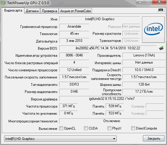

BloodyVlad Posted January 8, 2011 Share Posted January 8, 2011 We need to make IntelHD work, even if we will use only discrete graphics card. LCD screen of laptop and even hdmi-out (not sure about VGA) are attached to Intel graphics - not Nvidia. And even if Nvidia chip is main in Windows 7 - output still goes through Intel chip. I think that IntelFramebuffer is used for output even if Nvidia acceleration kexts are loaded and processing 3D. Need to check that on real MBP. ::EDIT:: Real MBP has 2 (TWO) multiplexes - 1 for each GPU, and MacOS is switching wich to use, so when Nvidia GPU is used, it uses it's own Framebuffer. But according to official whitepapers, Optimus laptops have only one multiplex (it's cheaper, but depend on special Windows 7 frameworks), so if MacOS will switch to Nvidia GPU - we will see black screen or broken output. So Optimus for now is only a dream. The only way is to turn IGP on. It is hardware problem, hacking won't help, IMHO. And then we can try to have CUDA driver installed, but not Nvidia display driver So now not only integrated GPU users are waiting, but also all "lucky" Optimus-enabled laptops users. Link to comment https://www.insanelymac.com/forum/topic/223754-intel-hd-graphics-gma-5700/page/12/#findComment-1618031 Share on other sites More sharing options...
