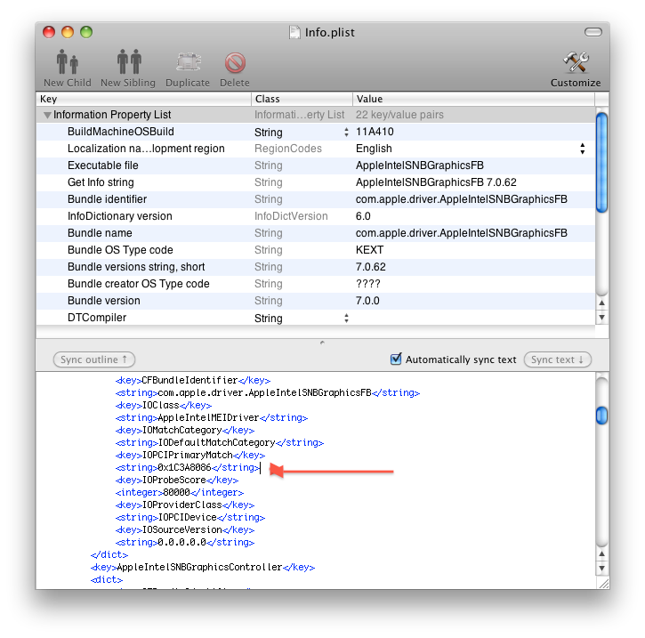

Kyle_C Posted April 1, 2011 Share Posted April 1, 2011 Oh, I forgot: the AppleIntelHDGraphicsGLDriver kext plugin is not in BaseSystem.dmg, it's in Packages/Essentials.pkg. Although I still haven't gotten GLCompositor to work. Link to comment https://www.insanelymac.com/forum/topic/223754-intel-hd-graphics-gma-5700/page/18/#findComment-1664389 Share on other sites More sharing options...

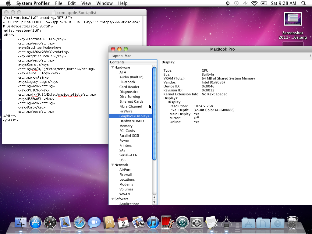

Jedis Posted April 1, 2011 Share Posted April 1, 2011 Jedis, are you sure you didn't do anything else? Changing the boot.plist does not make any difference. The weird thing about your screenshots is the menubar transparency, and a few posts back, you needed the Lion Intel HD Graphics.kext to at least get the menubar transparency. Finally, the question I ask myself, how did you take a screenshot? It seems that you need QE/CI to take screenshots. I'm confused Again, maybe your DSDT has something that can help us. I'm positive I didn't do anything else. I installed from a retail 10.6.3 CD and used a Latitude E6410 boot CD that loaded some kexts specific to the Latitude E4310/E6410 hardware. I'm using Transbar for the transparent menu bar look. I am using Snapplr to take screenshots. And using JustLooking to replace the builtin Preview app. Link to comment https://www.insanelymac.com/forum/topic/223754-intel-hd-graphics-gma-5700/page/18/#findComment-1664684 Share on other sites More sharing options...

Alexey` Posted April 2, 2011 Share Posted April 2, 2011 I'm using the AppleIntel{HD,SNB,Integrated}* kexts from Lion DP2 with the 2011 MBP version of 10.6.7 and nawcom's latest Legacy kernel. The Legacy kernel is probably only necessary if you get hit with a reboot loop. For Sandy Bridge, you will need to specify the busratio of your CPU in the boot arguments.I'm sure I forgot to mention something, so ask away. Great! Really:) So the question is - could you give me this magic kexts from lion DP2? I really appreciate your help. Link to comment https://www.insanelymac.com/forum/topic/223754-intel-hd-graphics-gma-5700/page/18/#findComment-1664817 Share on other sites More sharing options...

GhostRaider Posted April 2, 2011 Share Posted April 2, 2011 I'm positive I didn't do anything else. I installed from a retail 10.6.3 CD and used a Latitude E6410 boot CD that loaded some kexts specific to the Latitude E4310/E6410 hardware. I'm using Transbar for the transparent menu bar look. I am using Snapplr to take screenshots. And using JustLooking to replace the builtin Preview app. Jedis, thanks for mentioning Snapplr. Now I can take screenshots without QE/CI. Anyways as you can see in the screenshot below, editing just the Boot.plist does not do anything. The resolution is still 1024x768 even with GraphicsEnabler=Yes. Link to comment https://www.insanelymac.com/forum/topic/223754-intel-hd-graphics-gma-5700/page/18/#findComment-1664983 Share on other sites More sharing options...
Philz Posted April 2, 2011 Share Posted April 2, 2011 Great! Really:) So the question is - could you give me this magic kexts from lion DP2? I really appreciate your help. Look at my previous post, there is a link. On sidenote, anybody know netkas or care to approach him? He might be who we need to get this working... http://netkas.org/?p=709 For example certain keys to trigger the default on the ATI cards, I bet it's same setup for us on the Intel HD. Link to comment https://www.insanelymac.com/forum/topic/223754-intel-hd-graphics-gma-5700/page/18/#findComment-1665001 Share on other sites More sharing options...
Kyle_C Posted April 2, 2011 Share Posted April 2, 2011 For example certain keys to trigger the default on the ATI cards, I bet it's same setup for us on the Intel HD. That was always my intention, to find those keys. I was actually surprised when I got framebuffer without them, with the DP2 kexts. It's conceivable that the framebuffer works without these keys but QE/CI need some data out of ACPI to start up. But I got my ioreg IGPU section looking almost identical to the macbookpro8,1 (through the use of DSDT edits and modifications to Chameleon) and still no dice on QE/CI. Maybe there are actual hardware differences with the way the integrated GPU is used and some of these keys need to be set differently- that would be the worst possibility since we won't have any idea what to change. But after working on it for a while now, I think it's more likely that the problem is "in the other direction," so to speak. There have probably been changes to the OpenGL framework or other frameworks in Lion that make Snow Leopard window server and applications unable to use the video acceleration features pulled in with these new kexts. I tried copying framework files and dylib's from Lion to test out this theory, but they are too tightly coupled with the rest of the system and it just won't work. What's needed to test this theory is someone who has a CPU that can actually boot the new Lion kernel, so they can simply install DP2 and see. I can only run a Legacy kernel because of this damned reboot loop issue, and until Apple releases Darwin 11.0 sources we won't be able to make a Lion Legacy kernel. Link to comment https://www.insanelymac.com/forum/topic/223754-intel-hd-graphics-gma-5700/page/18/#findComment-1665026 Share on other sites More sharing options...

Philz Posted April 3, 2011 Share Posted April 3, 2011 That was always my intention, to find those keys. I was actually surprised when I got framebuffer without them, with the DP2 kexts. It's conceivable that the framebuffer works without these keys but QE/CI need some data out of ACPI to start up. But I got my ioreg IGPU section looking almost identical to the macbookpro8,1 (through the use of DSDT edits and modifications to Chameleon) and still no dice on QE/CI. Maybe there are actual hardware differences with the way the integrated GPU is used and some of these keys need to be set differently- that would be the worst possibility since we won't have any idea what to change. But after working on it for a while now, I think it's more likely that the problem is "in the other direction," so to speak. There have probably been changes to the OpenGL framework or other frameworks in Lion that make Snow Leopard window server and applications unable to use the video acceleration features pulled in with these new kexts. I tried copying framework files and dylib's from Lion to test out this theory, but they are too tightly coupled with the rest of the system and it just won't work. What's needed to test this theory is someone who has a CPU that can actually boot the new Lion kernel, so they can simply install DP2 and see. I can only run a Legacy kernel because of this damned reboot loop issue, and until Apple releases Darwin 11.0 sources we won't be able to make a Lion Legacy kernel. You happen to know what is needed to boot lion? I haven't seen any "process" for it. My guess my system could... I have legit access to... Link to comment https://www.insanelymac.com/forum/topic/223754-intel-hd-graphics-gma-5700/page/18/#findComment-1665154 Share on other sites More sharing options...

XmodD Posted April 3, 2011 Share Posted April 3, 2011 I had to reinstall OS x but now I am back at 10.6.7 but with an old 10.5.0 Kernel. I have correct display resolution and IOreport tells me, that the EDID is read correctly. But black screen,. I wanted just to change resolution in Vesa Mode, So I edit the S/L/Display/Override/D...ID/file. I Injected my EDID and also changed the name to Generic LCD Display. Now the fun fact: After reboot, at the point, where display normally turns black, it turns grey. Not the normal grey from booting, no simply a different grey. Log in via Screen sharing ... He detected my injected new name Generic LCD Display. Also the resolution is correct. But now i get in About this Computer under Display the field Connector. ... It is blank. it is as before. short time blue start screen, than it turns grey / not black ^^ What does it mean? Link to comment https://www.insanelymac.com/forum/topic/223754-intel-hd-graphics-gma-5700/page/18/#findComment-1665252 Share on other sites More sharing options...

yurick Posted April 3, 2011 Share Posted April 3, 2011 intelhd5700 =0x010b8086 inelhd3000 =0x14с21043 AppleIntelSNBGraphicsFB.kext Link to comment https://www.insanelymac.com/forum/topic/223754-intel-hd-graphics-gma-5700/page/18/#findComment-1665329 Share on other sites More sharing options...
beaups Posted April 3, 2011 Share Posted April 3, 2011 intelhd5700 =0x010b8086inelhd3000 =0x14с21043 AppleIntelSNBGraphicsFB.kext Vendor id 1043 is Atheros. I think you have your id's mixed up for Intel HD3000. Link to comment https://www.insanelymac.com/forum/topic/223754-intel-hd-graphics-gma-5700/page/18/#findComment-1665338 Share on other sites More sharing options...
