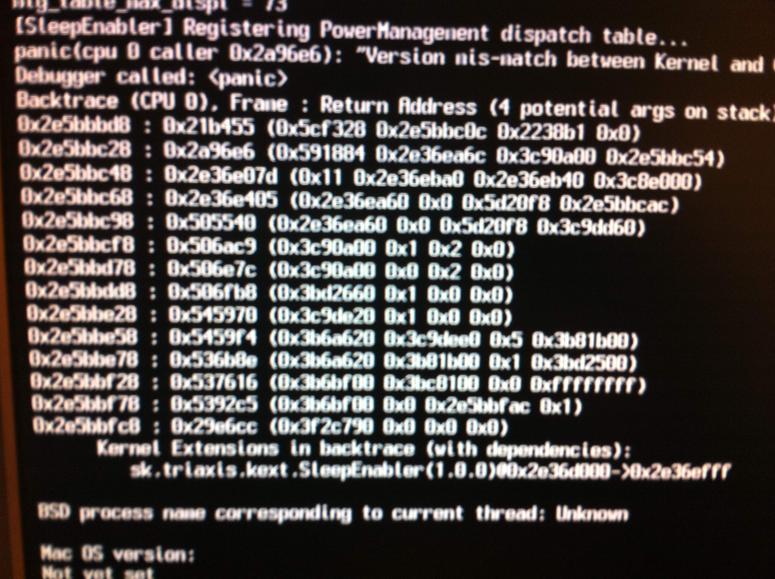

npereira Posted August 22, 2010 Share Posted August 22, 2010 whatever I do, i cannot get chameleon to come up during reboot. I always have to have the SL BOOT cd in. I dont understand why... I folowed everything to the T ! I installed the combo update, fist installing the Pre-10.6.4 pachage, now i cannot load my SL anymore, get a kernel panic : see attached im re-installing... Link to comment https://www.insanelymac.com/forum/topic/222316-pdf-guide-gigabyte-ga-p35-ds3l-rev-2-snow-leopard-1064-vanilla-remixed/page/2/#findComment-1534575 Share on other sites More sharing options...

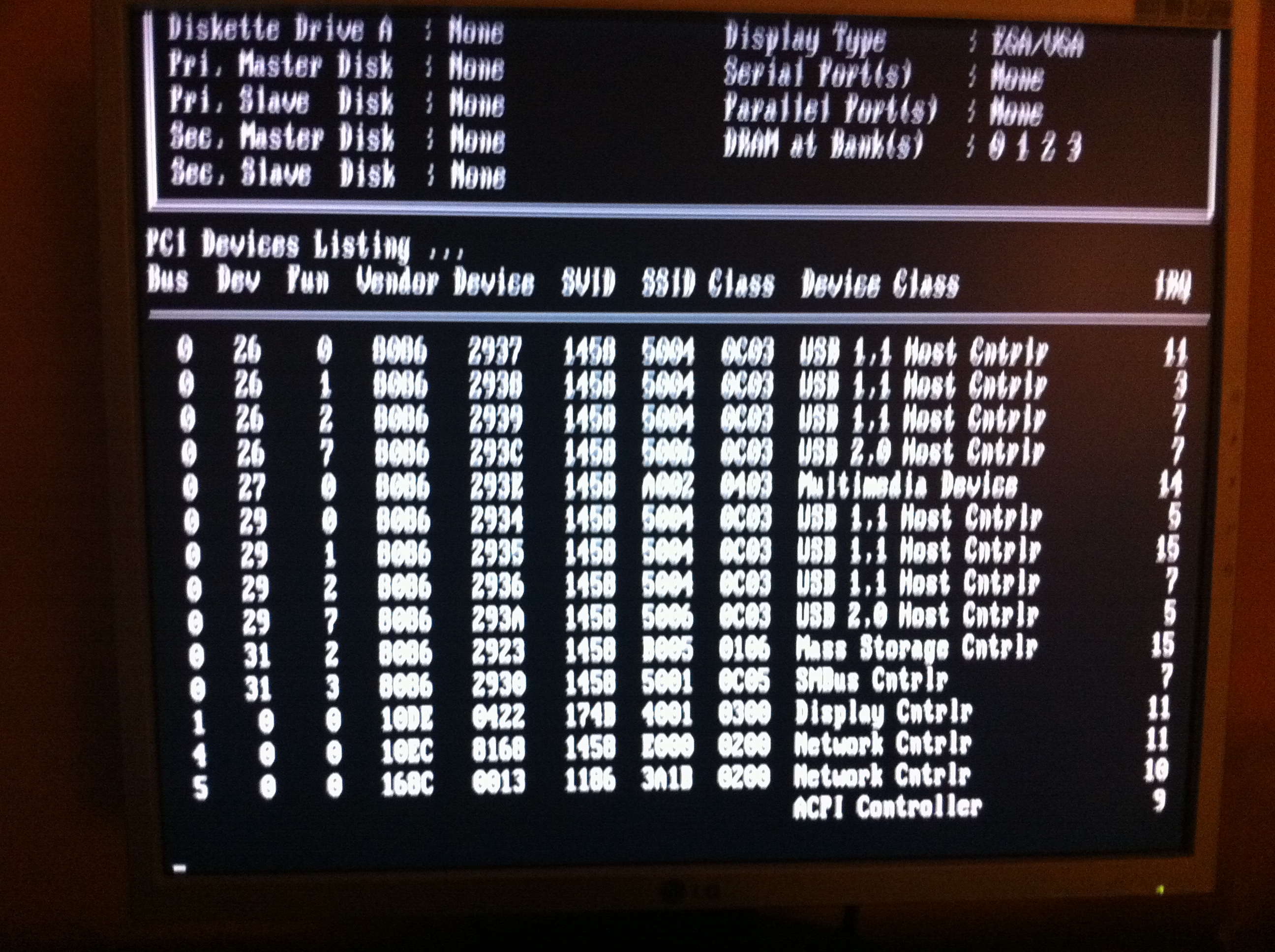

npereira Posted August 22, 2010 Share Posted August 22, 2010 Sorry, i did nit see your post. After i install chameleon, i reboot, and it goes through the post, then stops. I can send you a video of the boot process or attache a pic if you want. i changed the bios to be first boot = HDD and still, it stops after the " pci device listing" here is a pic of where it stops. Link to comment https://www.insanelymac.com/forum/topic/222316-pdf-guide-gigabyte-ga-p35-ds3l-rev-2-snow-leopard-1064-vanilla-remixed/page/2/#findComment-1534614 Share on other sites More sharing options...
thepiecesfit Posted August 22, 2010 Author Share Posted August 22, 2010 Sorry, i did nit see your post. After i install chameleon, i reboot, and it goes through the post, then stops. I can send you a video of the boot process or attache a pic if you want. Go into Advanced Bios Features, then under "Hard DIsk Boot Priority" [ Press Enter ] , make sure your sata hard drive is at the top of the list. If that doesnt help , check the physical sata plug on your motherboard make sure your sata drive is plugged into the 1st sata connector. I'm guessing something is wrong with your boot sequence thats why it hangs there. Link to comment https://www.insanelymac.com/forum/topic/222316-pdf-guide-gigabyte-ga-p35-ds3l-rev-2-snow-leopard-1064-vanilla-remixed/page/2/#findComment-1534617 Share on other sites More sharing options...
