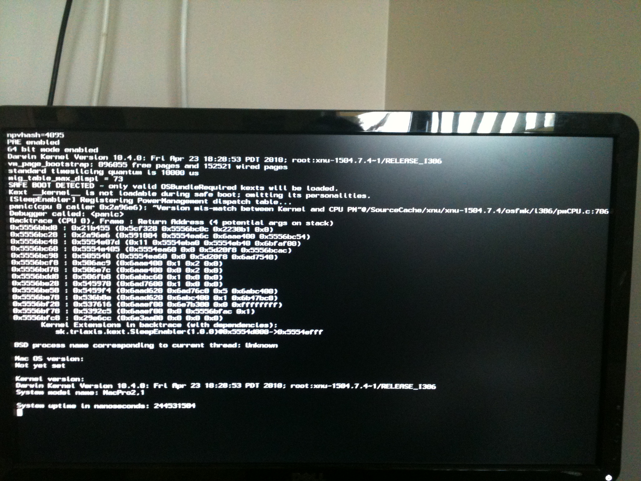

juice_e Posted September 25, 2010 Share Posted September 25, 2010 Camera or write it down. write it down? thats silly talk! here's a picture: Link to comment Share on other sites More sharing options...
thepiecesfit Posted September 25, 2010 Author Share Posted September 25, 2010 write it down? thats silly talk! here's a picture: try disabling onboard paralell and serial ports Link to comment Share on other sites More sharing options...
juice_e Posted September 26, 2010 Share Posted September 26, 2010 try disabling onboard paralell and serial ports did it but still doesnt work any other ideas? should i try loading it in safe mode and run the 10.6.4 patch or should it be functioning before i do it? Link to comment Share on other sites More sharing options...
thepiecesfit Posted September 26, 2010 Author Share Posted September 26, 2010 did it but still doesnt work any other ideas? should i try loading it in safe mode and run the 10.6.4 patch or should it be functioning before i do it? well you can go into Extra/Extensions and delete SleepEnabler.kext , also i would go over the guide and check what else you overlooked besides the paralell ports. Is your gigabyte board rev 2 with f9 bios? Link to comment Share on other sites More sharing options...

juice_e Posted September 26, 2010 Share Posted September 26, 2010 Digging around it seems your video card does not support snow leopard 64 bit mode. That is why its not loading after running my kit. It makes snow leopard run natively in 64 bit. Also, something to do with dropped support in 10.6.x updates for that particular card. What you need to do is this. Boot in safe mode using -x. Go into Extra Folder and drag com.apple.Boot.plist onto your desktop , edit it and change the following lines. <key>Kernel Flags</key> <string>arch=i386</string> Then save it and copy the file back into the Extra folder, enter password , reboot. Then proceed to follow the rest of the guide. That should fix it, will hold you over till you get a better video card. Alright!.. it boots now... thanks !!!!!!..... buuuuuut.... my wireless doesnt work. i have dlink dwa-552. i have been reading that it wont work under 64bit? ...... do you know how to resolve that now? , Link to comment Share on other sites More sharing options...
thepiecesfit Posted September 26, 2010 Author Share Posted September 26, 2010 Alright!.. it boots now... thanks !!!!!!..... buuuuuut.... my wireless doesnt work. i have dlink dwa-552. i have been reading that it wont work under 64bit? ...... do you know how to resolve that now? , try to reboot but this time use the -f flag in chameleon see if it works then Link to comment Share on other sites More sharing options...

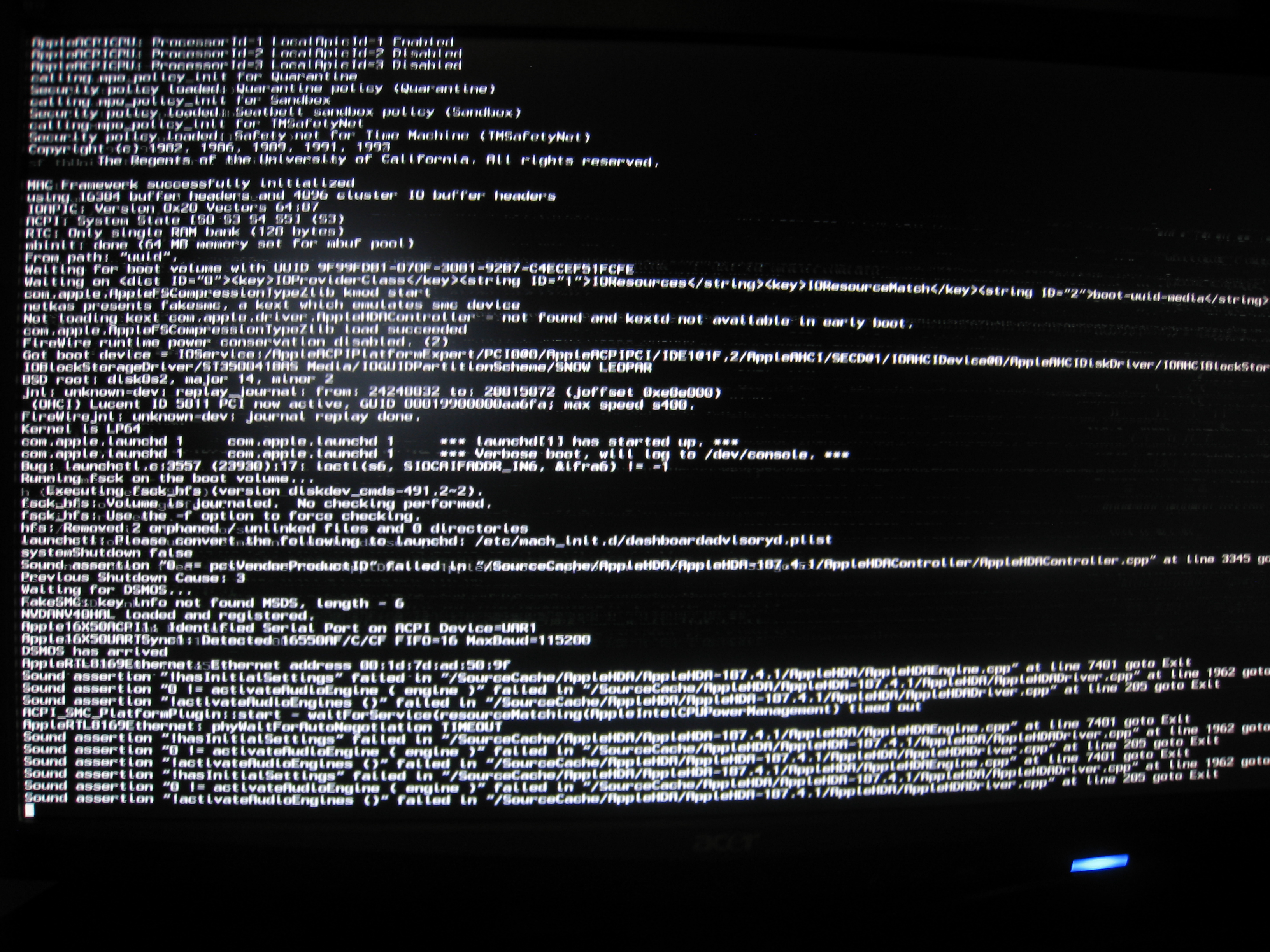

Charlie Vela Posted November 12, 2010 Share Posted November 12, 2010 Everything works just fine until i try to reboot without Slboot in my drive. I tried -f -v and it seems to hang on ACPI_SMC_PlatformPlugin: :start - waitForService(resourceMatching(AppleIntelCPUPowerManament ) timed out. Any guidance? Link to comment Share on other sites More sharing options...
MaLd0n Posted November 12, 2010 Share Posted November 12, 2010 http://www.insanelymac.com/forum/index.php?showtopic=235523 Link to comment Share on other sites More sharing options...
Charlie Vela Posted November 12, 2010 Share Posted November 12, 2010 http://www.insanelymac.com/forum/index.php?showtopic=235523 I just ran the auto patcher and copied the aml file to my extra folder.I tried booting without the disc and got the same error/hang. Did i miss something? Thank you for your help MaLd0n Link to comment Share on other sites More sharing options...
