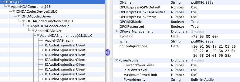

JBraddock Posted February 27, 2011 Share Posted February 27, 2011 I looked at your DSDT and you appear to have the proper notification to the HDEF device in the wake/GPE method, however I don't see a _PRW (Power Resources to Wake) in your HDEF device. Try adding this method to the HDEF device: Thank you for that. I added that code but same result. Device (HDEF) { Name (_ADR, 0x001B0000) Method (_PRW, 0, NotSerialized) { If (WKMD) { Return (Package (0x02) { 0x0D, 0x04 }) } Else { Return (Package (0x02) { 0x0D, Zero }) } } Method (_DSM, 4, NotSerialized) { Store (Package (0x0E) { "built-in", Buffer (One) { 0x01 }, "subsystem-id", Buffer (0x04) { 0x1B, 0x36, 0x00, 0x00 }, "subsystem-vendor-id", Buffer (0x04) { 0x3C, 0x10, 0x00, 0x00 }, "codec-id", Buffer (0x04) { 0xB2, 0x76, 0x1D, 0x11 }, "layout-id", Buffer (0x04) { 0x78, 0x03, 0x00, 0x00 }, "device-type", Buffer (0x10) { "IDT 92HD71B7" }, "PinConfigurations", Buffer (Zero) {} }, Local0) DTGP (Arg0, Arg1, Arg2, Arg3, RefOf (Local0)) Return (Local0) } } And finally I have the following under Scope (_GPE). Method (_L0D, 0, NotSerialized) { Notify (\_SB.PCI0.HDEF, 0x02) Notify (\_SB.PWRB, 0x02) } I don't know how related but I have noticed this. Sometimes, when I look at the ioreg, I notice that pin configuration of HDEF device takes the following values. 10 01 56 18 21 01 56 58 22 01 56 58 23 01 56 58 24 01 56 58 As a result, I have the following appear in System info. Intel High Definition Audio: Audio ID: 888 HDMI / DisplayPort Output: Connection: Display In normal times, pin configuration is the following. 10 10 21 01 20 10 a1 01 f0 00 f0 40 30 10 17 90 40 10 a1 20 50 00 f0 40 60 00 f0 40 70 00 a6 90 80 00 f0 40 a0 10 44 21 90 00 f1 40 b0 00 f1 40 c0 00 f0 40 and the result: Intel High Definition Audio: Audio ID: 888 Headphone: Connection: 1/8-Inch Jack External Microphone / iPhone Headset: Connection: 1/8-Inch Jack Speaker: Connection: Internal External Microphone / iPhone Headset: Connection: 1/8-Inch Jack Internal Microphone: Connection: Internal S/PDIF Optical Digital Audio Output: Connection: RCA But it doesn't make any difference. In both case, I have no audio after sleep. Audio is working after hibernate but not after sleep mode. If you would like to take a look at the audio files here it is. Also this is the system dumps including sound codec from linux. The problem is that I haven't come across any people using AppleHDA and still have audio issue after sleep. So I don't know where to start; if the problem is DSDT code or LegacyHDA.kext. Thank you again. Edit: if I use an usb device, audio is working then. Link to comment https://www.insanelymac.com/forum/topic/221653-guide-hp-dv8-dv7-dv6-dv5-1064-easy-comprehensive-installation/page/45/#findComment-1646271 Share on other sites More sharing options...
gsly Posted February 27, 2011 Share Posted February 27, 2011 Edit: if I use an usb device, audio is working then. Ah! That is a clue! Perhaps you need to Notify the parent device of the HDEF as well. I'd have to look again, but is this USB bus under the same root device as the audio device? Link to comment https://www.insanelymac.com/forum/topic/221653-guide-hp-dv8-dv7-dv6-dv5-1064-easy-comprehensive-installation/page/45/#findComment-1646383 Share on other sites More sharing options...
JBraddock Posted February 27, 2011 Share Posted February 27, 2011 Ah! That is a clue! Perhaps you need to Notify the parent device of the HDEF as well. I'd have to look again, but is this USB bus under the same root device as the audio device? They are under the Device PCI0. Here is the ioreg dumps w/o usb audio device being plugged in. Please let me know if you need anything else. BTW, I noticed that I'd written "when I use an usb device". I didn't mean a normal usb device but a normal headset with usb input. (Microsoft LifeChat® LX-3000). Again, thanks for your time. Really appreciated. Link to comment https://www.insanelymac.com/forum/topic/221653-guide-hp-dv8-dv7-dv6-dv5-1064-easy-comprehensive-installation/page/45/#findComment-1646396 Share on other sites More sharing options...
