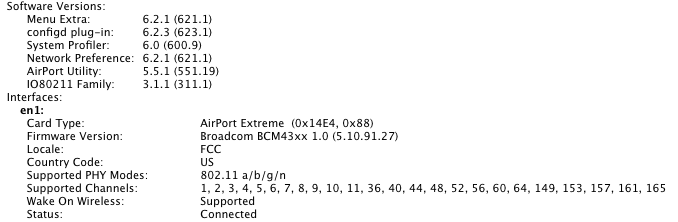

Mammoth Posted July 17, 2010 Author Share Posted July 17, 2010 Hey everyone, I have this MacBook I have to sell soon on eBay, which is the one I am borrowing the WiFi card for testing, so I dove in and completely disassembled my DV8t to investigate our possibilities for re-routing the wireless antenna wires to the lower slot. Right now, my DV8t looks like C3PO strapped to Chewy's back after being blasted to pieces by Boba Fett. I have nothing to report yet, but I am taking detailed pictures and will post later. If the rewiring is a viable solution, I may even put together a "quick" tear-down / rebuild guide... but I REALLY don't have time for this stuff... not now anyways, but... : ( I can tell you, this is NOT an easy laptop to take apart, NOT-AT-ALL! So this will not be for the timid as it literally requires taking it COMPLETELY apart, even the display must be removed. Pics and more info coming... later. Mammoth UPDATE! IT'S DOABLE!!! Pics later!!! Going to see Inception in IMAX now. Link to comment https://www.insanelymac.com/forum/topic/221653-guide-hp-dv8-dv7-dv6-dv5-1064-easy-comprehensive-installation/page/4/#findComment-1512740 Share on other sites More sharing options...
kellis Posted July 17, 2010 Share Posted July 17, 2010 Hey everyone, I have this MacBook I have to sell soon on eBay, which is the one I am borrowing the WiFi card for testing, so I dove in and completely disassembled my DV8t to investigate our possibilities for re-routing the wireless antenna wires to the lower slot. Right now, my DV8t looks like C3PO strapped to Chewy's back after being blasted to pieces by Boba Fett. I have nothing to report yet, but I am taking detailed pictures and will post later. If the rewiring is a viable solution, I may even put together a "quick" tear-down / rebuild guide... but I REALLY don't have time for this stuff... not now anyways, but... : ( I can tell you, this is NOT an easy laptop to take apart, NOT-AT-ALL! So this will not be for the timid as it literally requires taking it COMPLETELY apart, even the display must be removed. Pics and more info coming... later. Mammoth UPDATE! IT'S DOABLE!!! Pics later!!! Going to see Inception in IMAX now. I am not exactly sure what you're trying to do. but on my dv7 3180us. i bought some wires, i placed my wifi card in the 2nd slot. cut the wires from the 1st pci slot, and extended them to the 2nd card. works great, the signal is strong and fast as far as i can test. it is seen as a 3rd party, but it's ok i guess, looks to have N engaged too. Link to comment https://www.insanelymac.com/forum/topic/221653-guide-hp-dv8-dv7-dv6-dv5-1064-easy-comprehensive-installation/page/4/#findComment-1512742 Share on other sites More sharing options...

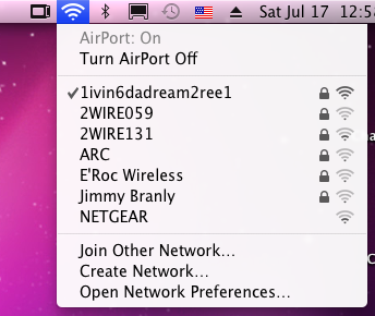

Mammoth Posted July 17, 2010 Author Share Posted July 17, 2010 Hey everyone, My WiFi antenna wire rerouting mod is complete. my machine is all back together, and with the Apple WiFi card installed in the lower slot and connected to the HP OEM antenna wires, I am able to post this message in OS X from my DV8t over wireless!!! Very happy! UPDATE: Just tested in Windows 7 and working perfectly too; adding this update from DV8t w/ wireless! If anyone wants to get one of these cards, I found a guy on eBay selling them for $19.99 with FREE shipping, and he's in Los Angeles (NOT China), so you will get it FAST! eBay seller ID: JHETech*com Apple PRO A1181 A1260 Wireless WiFi 802.11n BCM94321MC Mammoth Link to comment https://www.insanelymac.com/forum/topic/221653-guide-hp-dv8-dv7-dv6-dv5-1064-easy-comprehensive-installation/page/4/#findComment-1513237 Share on other sites More sharing options...
Mac Man 50 Posted July 17, 2010 Share Posted July 17, 2010 Hey everyone, My WiFi antenna wire rerouting mod is complete. my machine is all back together, and with the Apple WiFi card installed in the lower slot and connected to the HP OEM antenna wires, I am able to post this message in OS X from my DV8t over wireless!!! Very happy! UPDATE: Just tested in Windows 7 and working perfectly too; adding this update from DV8t w/ wireless! It might just be better to start using the new one. Is there anything that works better with the Mammoth DSDT than the new one? Mammoth Mammoth: Thats is a excellent progress!!! However, I'm bit scared to do the antenna re-routing. Can you explain me this: Does the Dell 1500 or Dell 1510 or Dell 1515 wireless PCI-e card need antenna to work? I wanted to use the available second PCI-e slot on dv8t to install the Dell Wifi card and make it work. I don't want to patch the bios or remove the stock Intel 6200N card. etc. Also, on the dsdt.aml, I was able to successfully merge HDEF from kokomal's to Mammoth Boot CD 1.10 version of dsdt.aml and all I need is just merge the PEGP and GFX0 entries and also waiting for correct NVCAP entries from kizwan to make the Graphics card use the correct configuration. Kizwan mentioned that kokomal's version may be using a different BIOS version than ours so it is always safe to keep ours but to patch it with modified entries. Btw, can you run MSR Tools in 32 bit mode (arch=i386 during Chameleon boot) and see what you get for the power usage and is Intel SpeedStep working? For me it is not and I wanted to enable it. Do you know we can do it thru DSDT patching? Thanks. Link to comment https://www.insanelymac.com/forum/topic/221653-guide-hp-dv8-dv7-dv6-dv5-1064-easy-comprehensive-installation/page/4/#findComment-1513254 Share on other sites More sharing options...
