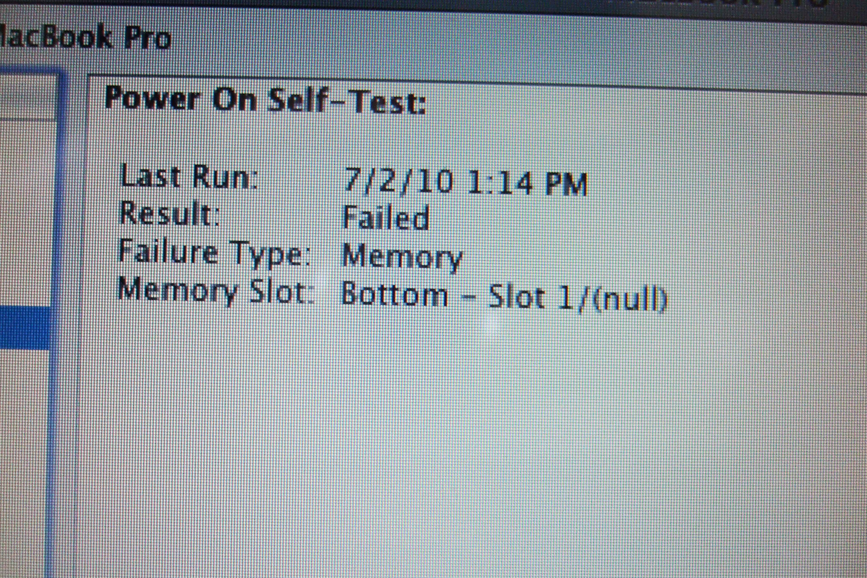

Mac Man 50 Posted July 4, 2010 Share Posted July 4, 2010 Hey man, i am in the exact same situation.1) no brightness 2) my ram diagnostic in the mac says failed just like yours 3) i can't even extract the DSDT correctly and recompile it without hundreds of errors. and if i do fix them, KP when trying. How are you guys fixing and actually getting the DSDT.aml to work fine? I would think that an extract then compilation without any edit would work, but it doesn't. Something is flawed somewhere. Hi kellis, Thanks for your reply. While I'm waiting for Mammoth's expert solutions to my issues (your issues too), I thought I can ask on how the following works for you: 1. power/battery/sleep (even with LID). Mammoth has recommended in his guides to set the Energy Saver settings "Never" both for Power and battery while he may be working on a fix. 2. Fan always running and also machine running slightly higher on the warm side. 3. SD reader 4. Audio including both speakers and internal dual mics 5. Brightness control (need it the most) 6. resolution switching - When I switch to any resolution other than the 1920x1080, I get KP. Also, USB is acting weird. After a restart, SL forgets it and I have to remove it and reinsert it. This is an issue on all USB ports. I also tried VoodooHDA.kext for audio and SD reader kexts and both give KP after few seconds. After this happens, I have to restore the cloned image as SL doesn't boot at all. Do you have working kexts for the ones mentioned above to work? Please let me know. I wanted to try them as I have already backed up a working install using Clonezilla. Thanks. Link to comment https://www.insanelymac.com/forum/topic/221653-guide-hp-dv8-dv7-dv6-dv5-1064-easy-comprehensive-installation/page/3/#findComment-1504090 Share on other sites More sharing options...

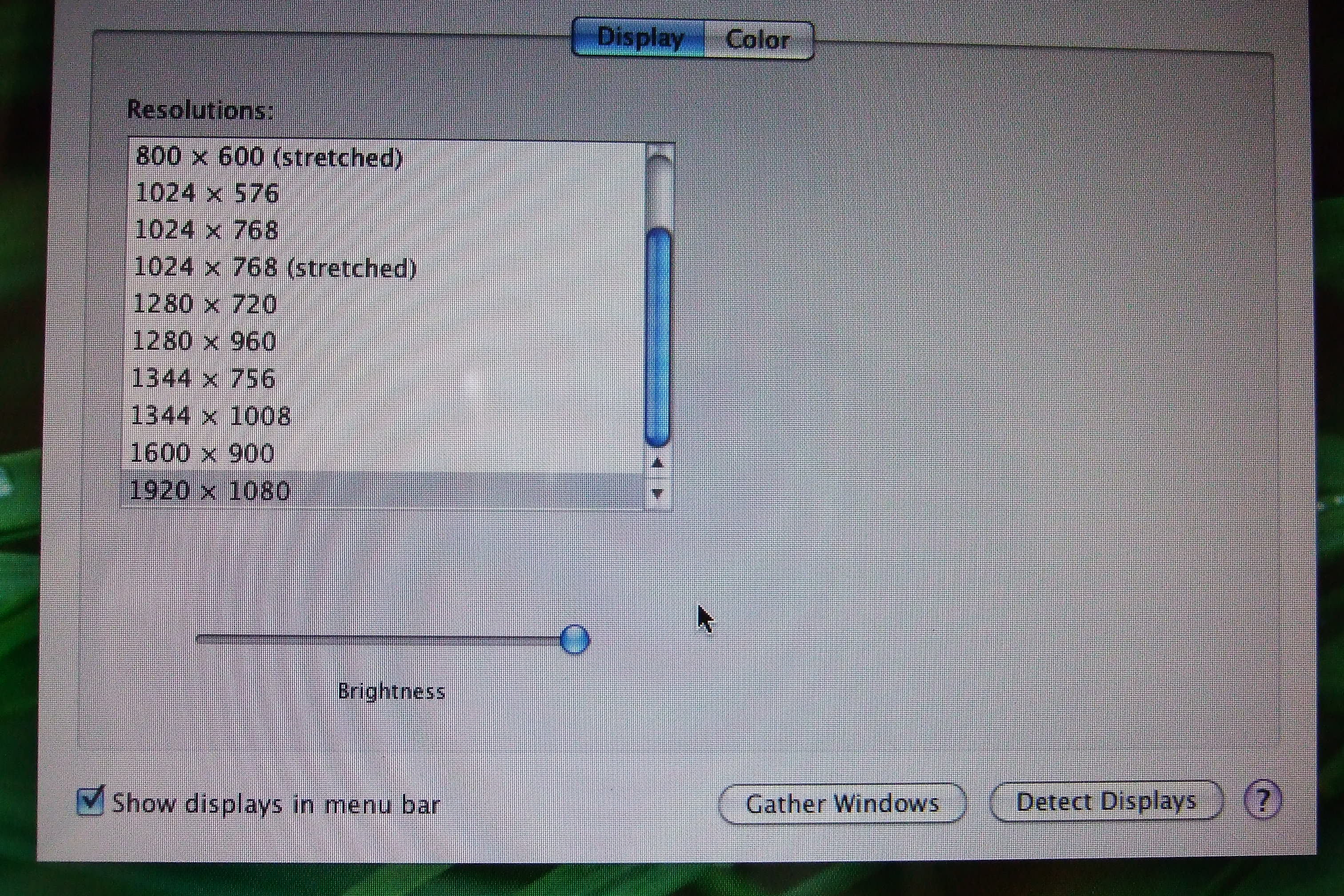

Mac Man 50 Posted July 5, 2010 Share Posted July 5, 2010 Mammoth: I was just curious to see if I can make the Brightness slider show up in the Display Preferences. And, I was successful but with issues: I added the following code to make it visible: Device (PNLF) { Name (_HID, EisaId ("APP0002")) Name (_CID, "backlight") Name (_UID, 0x0A) Name (_STA, 0x0B) } I used DSDTE to edit the dsdt.aml under the Chameleon\Extra partition by placing the above mentioned method just above Device (PWRB) as suggested here: http://www.mydellmini.com/forum/mac-os-x-d...g-audio-19.html. I then compiled and it compiled with no errors or warnings and rebooted keeping my fingers crossed and it actually worked. The Display preferences is able to show the Brightness slider. But, it is always set at maximum and there is no effect in sliding it and also even if I move the slider left or right, it moves to the maximum immediately. So, definitely, I'm missing something. Just wanted to let you know. Thanks. Link to comment https://www.insanelymac.com/forum/topic/221653-guide-hp-dv8-dv7-dv6-dv5-1064-easy-comprehensive-installation/page/3/#findComment-1505241 Share on other sites More sharing options...

kellis Posted July 6, 2010 Share Posted July 6, 2010 Mammoth: I was just curious to see if I can make the Brightness slider show up in the Display Preferences. And, I was successful but with issues: I added the following code to make it visible: Device (PNLF) { Name (_HID, EisaId ("APP0002")) Name (_CID, "backlight") Name (_UID, 0x0A) Name (_STA, 0x0B) } I used DSDTE to edit the dsdt.aml under the Chameleon\Extra partition by placing the above mentioned method just above Device (PWRB) as suggested here: http://www.mydellmini.com/forum/mac-os-x-d...g-audio-19.html. I then compiled and it compiled with no errors or warnings and rebooted keeping my fingers crossed and it actually worked. The Display preferences is able to show the Brightness slider. But, it is always set at maximum and there is no effect in sliding it and also even if I move the slider left or right, it moves to the maximum immediately. So, definitely, I'm missing something. Just wanted to let you know. Thanks. Hi, I was able to recompile my own dsdt with the help of everybody, and yes, i am in the same boat as you are. The slider shows up, but does not act. Same with the FN keys. they show the HUD, but no action. the reason is that i believe the MAX and MIN values are set to 0x00 I tried to find a way to actually set that, maybe with BCL or something in a kext, but no luck thus far. Link to comment https://www.insanelymac.com/forum/topic/221653-guide-hp-dv8-dv7-dv6-dv5-1064-easy-comprehensive-installation/page/3/#findComment-1506133 Share on other sites More sharing options...
