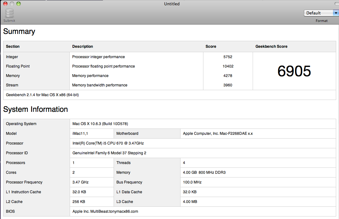

icu Posted June 15, 2010 Share Posted June 15, 2010 Just finished install snow leopard 10.6.3 on h55m-usb3, everything work out of the box. Audio, 8800GTS, NiC card. Until I update with [url="http://www.insanelymac.com/forum/topic/279450-why-insanelymac-does-not-support-tonymacx86/"]#####[/url] with legacy audio, that when my onboard audio stop working. GeekBench score 6905 (while playing slingplayer) Link to comment https://www.insanelymac.com/forum/topic/215643-possible-to-install-on-h55-chipset/#findComment-1489311 Share on other sites More sharing options...
