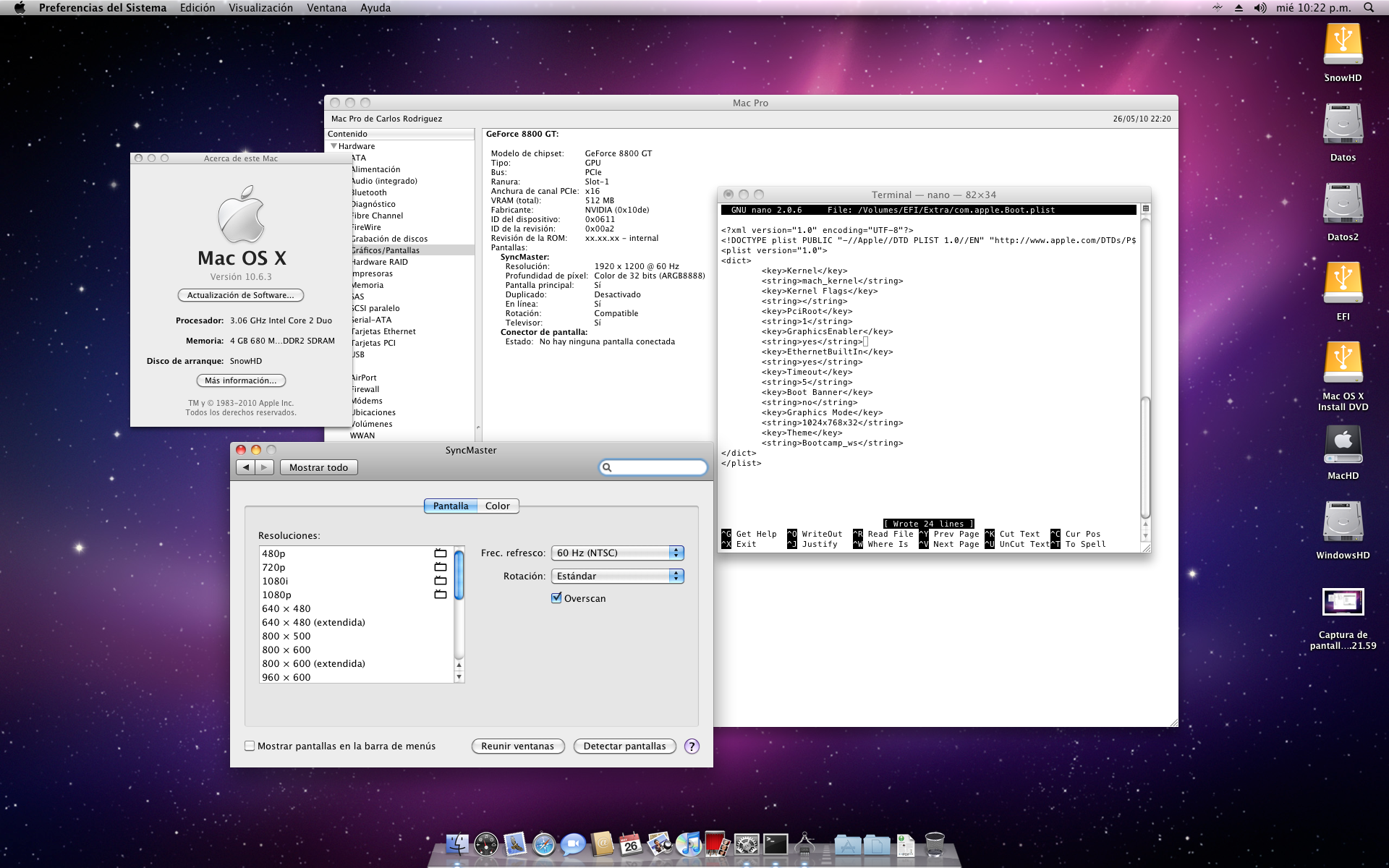

hypnotic4life Posted June 6, 2010 Share Posted June 6, 2010 Problem solved. I was apparently using another boot loader nl. AsereBLN Booter - Based on Chameleon RC4 / PCEFI10.5 which needs different parameters. 1. had to rename macpro8800gt.rom -> 10de_0614.rom and put it in /Extra 2. had to put this in boot.plist <key>UseNvidiaROM</key> <string>yes</string> <key>VBIOS</key> <string>yes</string> Now everything works! Very happy with the usb kakewalk method! Link to comment https://www.insanelymac.com/forum/topic/214129-1063-nvidia-blank-screen-issue-with-dvihdmi-on-9800gt/page/5/#findComment-1482955 Share on other sites More sharing options...
goodbye losers Posted June 6, 2010 Share Posted June 6, 2010 come to think of it, trying this rom trick, i am having the same issue getting it to actually load. it still says "internal" in there for me as well. anyone have any idea why? you must remove from the dsdt.aml and com.apple.boot.plist any graphic strings...put the rom in extra folder and copy this to the boot.plist: <key>GraphicsEnabler</key> <string>Yes</string> <key>VideoROM</key> <string>nvidia.rom</string> <key>VBIOS</key> <string>yes</string> http://www.insanelymac.com/forum/index.php?showtopic=219232 Link to comment https://www.insanelymac.com/forum/topic/214129-1063-nvidia-blank-screen-issue-with-dvihdmi-on-9800gt/page/5/#findComment-1483140 Share on other sites More sharing options...

el_charlie Posted June 7, 2010 Share Posted June 7, 2010 you must remove from the dsdt.aml and com.apple.boot.plist any graphic strings...put the rom in extra folder and copy this to the boot.plist: <key>GraphicsEnabler</key> <string>Yes</string> <key>VideoROM</key> <string>nvidia.rom</string> <key>VBIOS</key> <string>yes</string> http://www.insanelymac.com/forum/index.php?showtopic=219232 Please note that you have to rename the rom file according to the VideoROM parameter even with capital letters if they exist. In the above case the rom has to be named nvidia.rom; all letters with lower case. If on System Profiler appears "internal", the user has to try again and check. Cheers! Link to comment https://www.insanelymac.com/forum/topic/214129-1063-nvidia-blank-screen-issue-with-dvihdmi-on-9800gt/page/5/#findComment-1483820 Share on other sites More sharing options...
