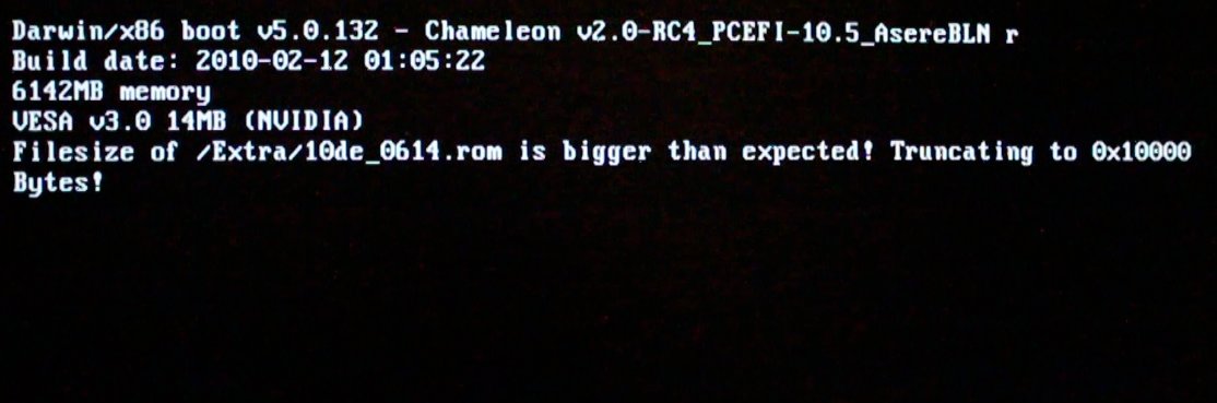

nullspot Posted June 9, 2010 Share Posted June 9, 2010 So I've had this message flash as chameleon began booting, but it always went so quick I could never read it - so I video'd it and went frame by frame... I had assumed it was complaining about my second graphics card not being properly accounted for, but to my surprise, it was complaining about the file size of the 8800GT mac .rom that has been (mostly) working for me! Now I did notice that the 8800 .rom was bigger than the .rom's I extracted for both my cards (which are under 64K). I gathered that this was normal for mac roms, but it appears that AsereBLN chameleon doesn't like mac roms (though it still allows it and uses it). I'm wondering, however, exactly what's getting thrown out in the "truncation"? Of course, you'd think that the proper method would be to use my card's own .rom file, but as I've posted earlier, when I do that, I get no benefits - the HDMI freeze problem returns... any clues? Link to comment https://www.insanelymac.com/forum/topic/214129-1063-nvidia-blank-screen-issue-with-dvihdmi-on-9800gt/page/6/#findComment-1485045 Share on other sites More sharing options...
Beerkex'd Posted June 9, 2010 Share Posted June 9, 2010 Extract the truncated ROM from ioreg and compare it with the real one. Follow the link I posted earlier (post #135) to see how. However, if everything is working why worry? Link to comment https://www.insanelymac.com/forum/topic/214129-1063-nvidia-blank-screen-issue-with-dvihdmi-on-9800gt/page/6/#findComment-1485054 Share on other sites More sharing options...
