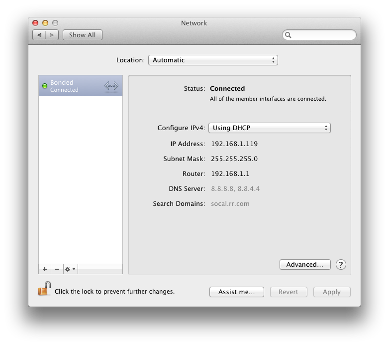

Kris404 Posted September 11, 2011 Share Posted September 11, 2011 As I have never tried link aggregation, no idea. I don't know any methods specifically defined for link aggregation in IOKit, though it may exist. If Network preference panel allows activating aggregation, it is supported by an upper layer. Just try and see what happens. .. Woohoo!! Bonding works too and with 9K Jumbo frames no less. Of course you need to create a 'Link Aggregation Group (LAG)' and enable 'Link Aggregation Control Protocol (LACP)' on the Switch supporting these features (Mine is Netgear GS108T Smart Switch) This is just the perfect setup I was looking for to stream from and backup to my Synology DS 509+ NAS (also on another LAG). Thanks hnak. Kris Link to comment https://www.insanelymac.com/forum/topic/205771-appleintele1000ekext-for-108107106105/page/6/#findComment-1747027 Share on other sites More sharing options...
hnak Posted September 11, 2011 Author Share Posted September 11, 2011 Good ! I can tell that it works when I am asked by someone, too. Link to comment https://www.insanelymac.com/forum/topic/205771-appleintele1000ekext-for-108107106105/page/6/#findComment-1747076 Share on other sites More sharing options...
