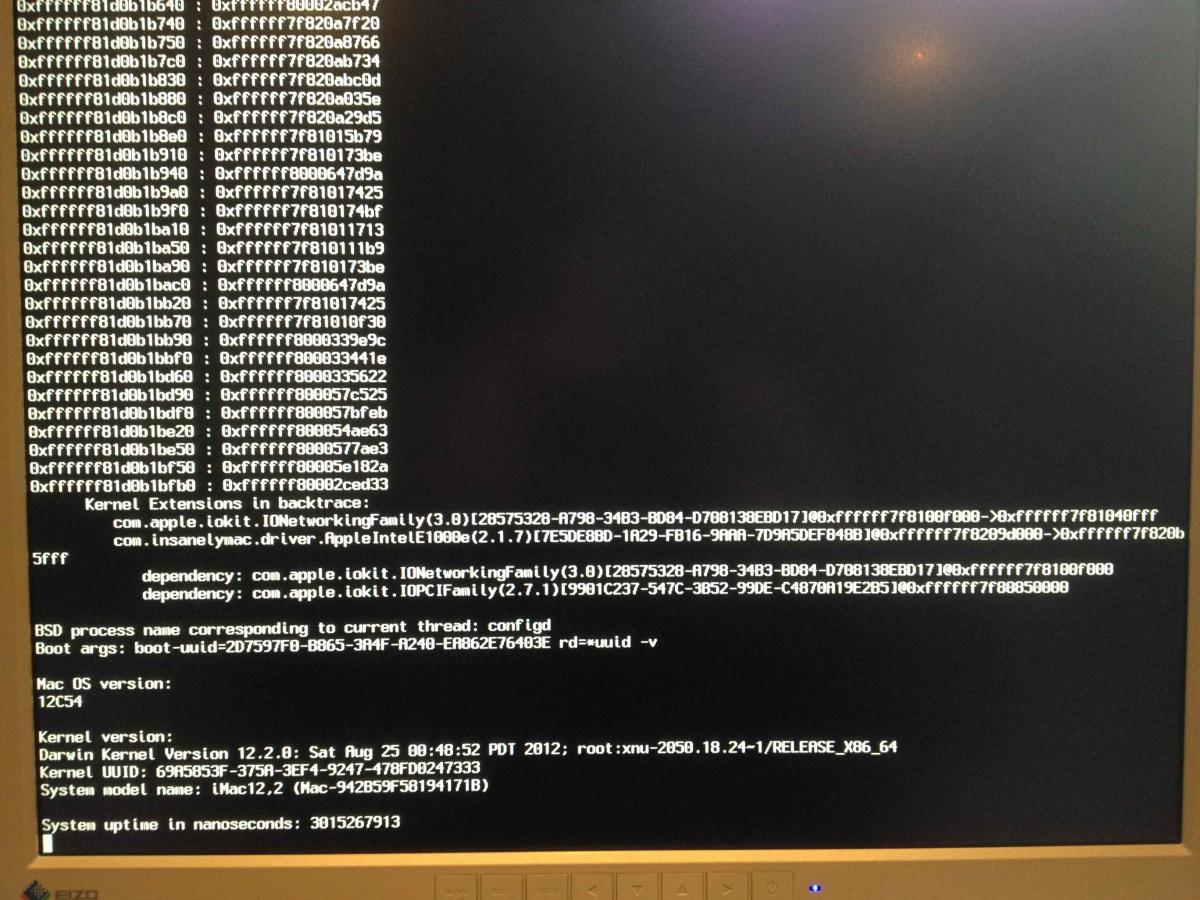

khe91 Posted September 21, 2012 Share Posted September 21, 2012 2.1.7. gives me a KP on 10.8.2. if a HP NC360T (Intel 82571EB chipset) nic is installed (this card is supported oob by Apple driver). Link to comment https://www.insanelymac.com/forum/topic/205771-appleintele1000ekext-for-108107106105/page/10/#findComment-1854469 Share on other sites More sharing options...

khe91 Posted September 22, 2012 Share Posted September 22, 2012 I did not know that the driver supports 82571, as 8254x are PCI cards. Should I remove the ID in the next release ? Yes, please. Then we will see if the HP card is the reason for the Kernel Panic in the kext. Link to comment https://www.insanelymac.com/forum/topic/205771-appleintele1000ekext-for-108107106105/page/10/#findComment-1854757 Share on other sites More sharing options...
hnak Posted September 22, 2012 Author Share Posted September 22, 2012 Yes, please. Then we will see if the HP card is the reason for the Kernel Panic in the kext. You can do it now by editing AppleIntelE1000e.kext/Contents/info.plist. Link to comment https://www.insanelymac.com/forum/topic/205771-appleintele1000ekext-for-108107106105/page/10/#findComment-1854776 Share on other sites More sharing options...
khe91 Posted September 22, 2012 Share Posted September 22, 2012 You can do it now by editing AppleIntelE1000e.kext/Contents/info.plist. I removed the 0x105e8086 from the info.plist. Repaired Disk Permissions to rebuild the kernel cache. Still the same Kernel Panic like in the screen shot of my first posting. If I remove the HP NC360T it works. If I remove the AppleIntelE1000e.kext then the NC360T works, but not my onboard Ethernet port. Link to comment https://www.insanelymac.com/forum/topic/205771-appleintele1000ekext-for-108107106105/page/10/#findComment-1854787 Share on other sites More sharing options...
hnak Posted September 22, 2012 Author Share Posted September 22, 2012 I removed the 0x105e8086 from the info.plist. Repaired Disk Permissions to rebuild the kernel cache. Still the same Kernel Panic like in the screen shot of my first posting. If I remove the HP NC360T it works. If I remove the AppleIntelE1000e.kext then the NC360T works, but not my onboard Ethernet port. If the ID ( = 0x105e8086) does not exist in Info.plist, AppleIntelE1000e.kext will never be loaded unless you have another Intel NIC - which you have onboard. What's the ID of the NIC ?Or, are they sharing the same IRQ ? Link to comment https://www.insanelymac.com/forum/topic/205771-appleintele1000ekext-for-108107106105/page/10/#findComment-1854794 Share on other sites More sharing options...
khe91 Posted September 22, 2012 Share Posted September 22, 2012 If the ID ( = 0x105e8086) does not exist in Info.plist, AppleIntelE1000e.kext will never be loaded unless you have another Intel NIC - which you have onboard. What's the ID of the NIC ? I understand this and don't understand why the KP still occurs, can you see anything from the Kernel Panic screenshoot or can I enable any more debug logs ? Link to comment https://www.insanelymac.com/forum/topic/205771-appleintele1000ekext-for-108107106105/page/10/#findComment-1854798 Share on other sites More sharing options...
hnak Posted September 22, 2012 Author Share Posted September 22, 2012 I understand and don't understand why the KP still occurs, can you see anything from the Kernel Panic screenshoot or can I enable any more debug logs ? You should build the kext from the source ( "Debug" build ) to enable verbose logging, possibly adding the hardware ID output . Link to comment https://www.insanelymac.com/forum/topic/205771-appleintele1000ekext-for-108107106105/page/10/#findComment-1854801 Share on other sites More sharing options...
