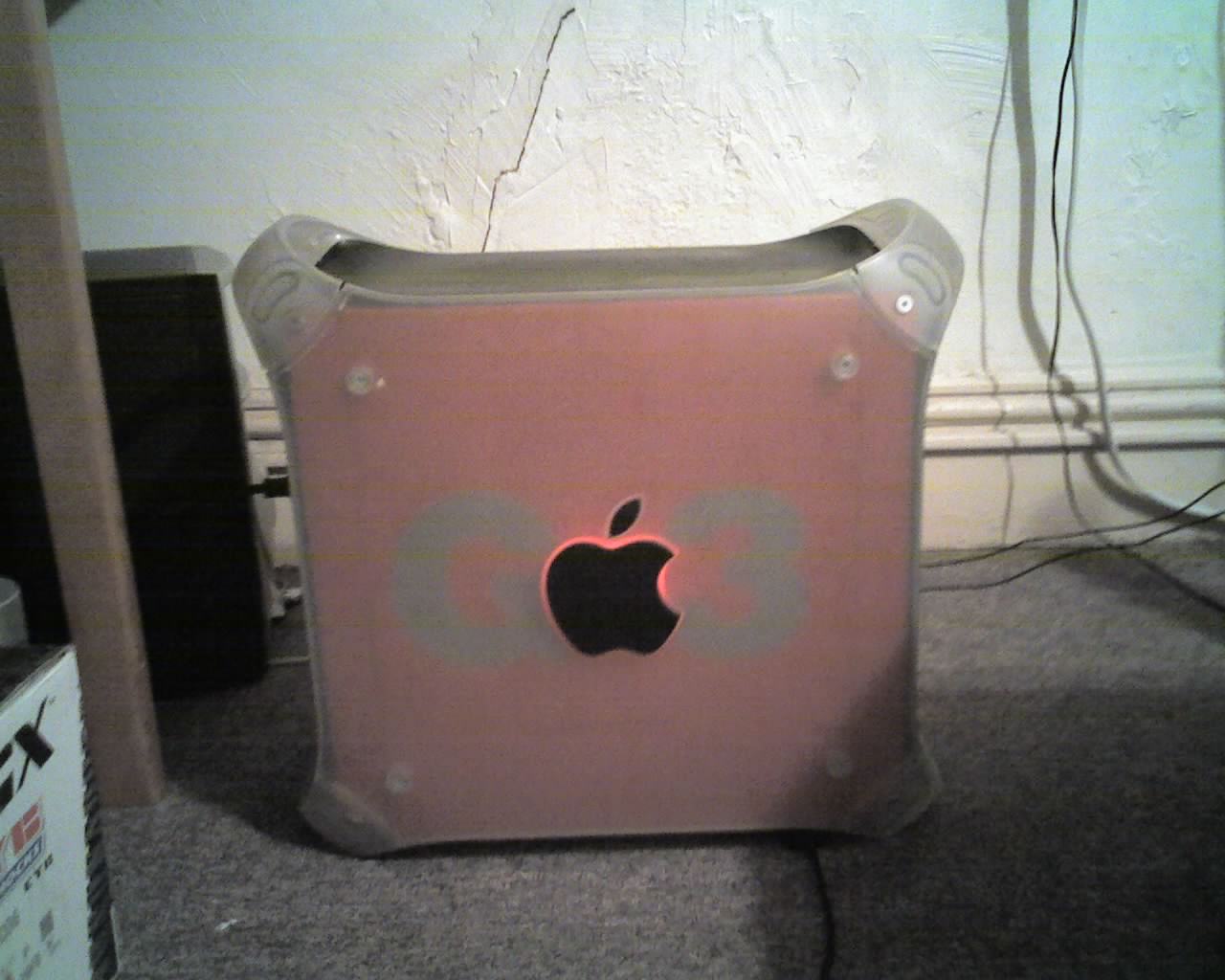

xfsasx Posted October 13, 2006 Share Posted October 13, 2006 I love the g3 mac cases! I think mine looks sweet Link to comment https://www.insanelymac.com/forum/topic/20496-is-it-possible-to-put-an-osx86-mac-into-a-powerpc-g3-blue-and-white-case/#findComment-208674 Share on other sites More sharing options...
