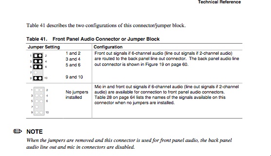

katmail Posted November 12, 2006 Share Posted November 12, 2006 Hi Guedes Jr It has been reported that the Mic i/p is possible in Intel D865perl only through the Front Panel Audio Connector I read about it ..hope it help Katmail Link to comment Share on other sites More sharing options...
gu3d3s Posted November 12, 2006 Share Posted November 12, 2006 hi katmail, thantks for you atention! i will look for this infermations, and try find a front conector for my m.board. but this pictures showed, is a jumper for D865perl. if yes, you can send to me a .pfd copy of manual. thanks fiend and forgive me for my English! []'s Link to comment Share on other sites More sharing options...

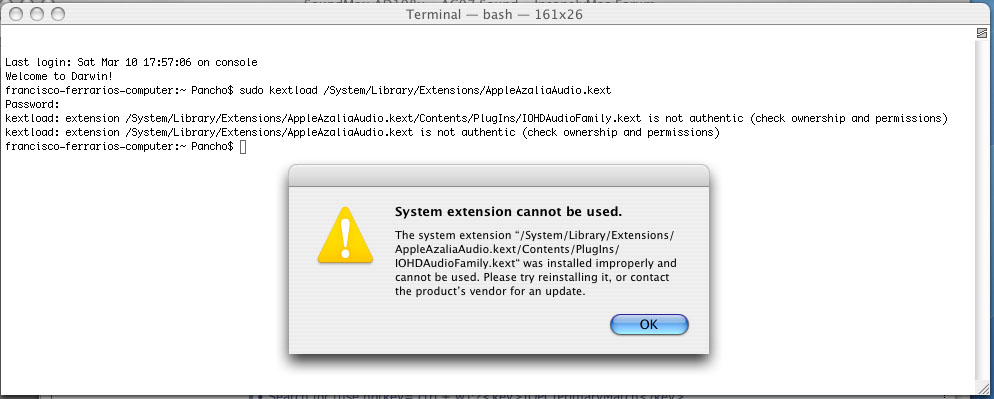

Panchus Posted March 10, 2007 Share Posted March 10, 2007 I tryed Katmail method but I get this error when I put: • sudo kextload /System/Library/Extensions/AppleAzaliaAudio.kext • kextcache -k /System/Library/Extensions/ I dont Know why.... katMail? any advice? thanks Link to comment Share on other sites More sharing options...
katmail Posted March 14, 2007 Share Posted March 14, 2007 Hi Panchus Try to refer this link http://forum.insanelymac.com/index.php?s=&...st&p=232935 refer your error Try type in Terminal for permission errors sudo chmod -R 755 /System/Library/Extensions sudo chown -R root:wheel /System/Library/Extensions sudo rm -R /System/Library/Extensions.kextcache sudo rm -R /System/Library/Extensions.mkext and do a reboot Hope it help regards Link to comment Share on other sites More sharing options...
