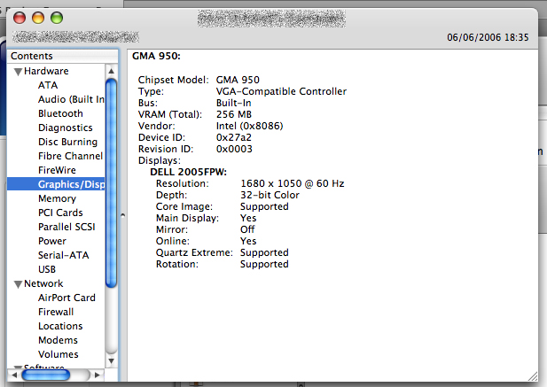

antic Posted June 5, 2006 Share Posted June 5, 2006 I think there's a bit of kidology going on here from apple. I tried the system profiler from 10.4.3 on my mac mini and it shows there is 256 mg vram available. Link to comment https://www.insanelymac.com/forum/topic/19125-any-way-to-change-vram-allocation-in-a-mac-mini/#findComment-125303 Share on other sites More sharing options...
bigboss Posted June 5, 2006 Share Posted June 5, 2006 I think there's a bit of kidology going on here from apple. I tried the system profiler from 10.4.3 on my mac mini and it shows there is 256 mg vram available. how could you try the system profiler from 10.4.3 on a mini? the first retail version of the intel tiger was 10.4.4 that is unless you are referring to your "hac mini"* and not your "mac mini" or you somehow got 10.4.3 to work on your mac (HOW?) *hac not hack!!! - it was deliberate Link to comment https://www.insanelymac.com/forum/topic/19125-any-way-to-change-vram-allocation-in-a-mac-mini/#findComment-125309 Share on other sites More sharing options...
antic Posted June 6, 2006 Share Posted June 6, 2006 I too had been trying to find out what the situation was with the graphics memory, and like most got nothing but confusion. Someone on the forum suggested I tried loading the profiler from 10.4.3 to see if there was any difference. So thats what I did and hey presto 256 meg vram! Link to comment https://www.insanelymac.com/forum/topic/19125-any-way-to-change-vram-allocation-in-a-mac-mini/#findComment-125828 Share on other sites More sharing options...
oldman1944 Posted June 6, 2006 Author Share Posted June 6, 2006 The info shown with 10.4.3 profile is not correct as there is no GMA950 driver with that version. The way the vram works is discribed in http://www.intel.com/design/chipsets/applnots/302623.htm Still looking Thanks Link to comment https://www.insanelymac.com/forum/topic/19125-any-way-to-change-vram-allocation-in-a-mac-mini/#findComment-125887 Share on other sites More sharing options...
antic Posted June 6, 2006 Share Posted June 6, 2006 To be honest I don't care whether its correct or not. Its just something I tried out. It doesn't make my system run any better and to be honest I,ve stopped worring about it. Make the most of what you've got. If you dont like it get an imac. Link to comment https://www.insanelymac.com/forum/topic/19125-any-way-to-change-vram-allocation-in-a-mac-mini/#findComment-125982 Share on other sites More sharing options...
