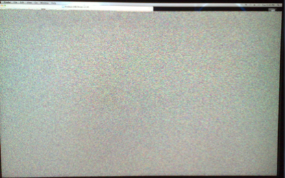

I get a garbled distortion on reboot and I have to un plug the dvi connector and plug it back in to get a normal screen.
Weird problem in my 1 year saga to get OSX working as a well on a pc. icon_e_sad.gif
Any suggestions? This is what it looks like.
