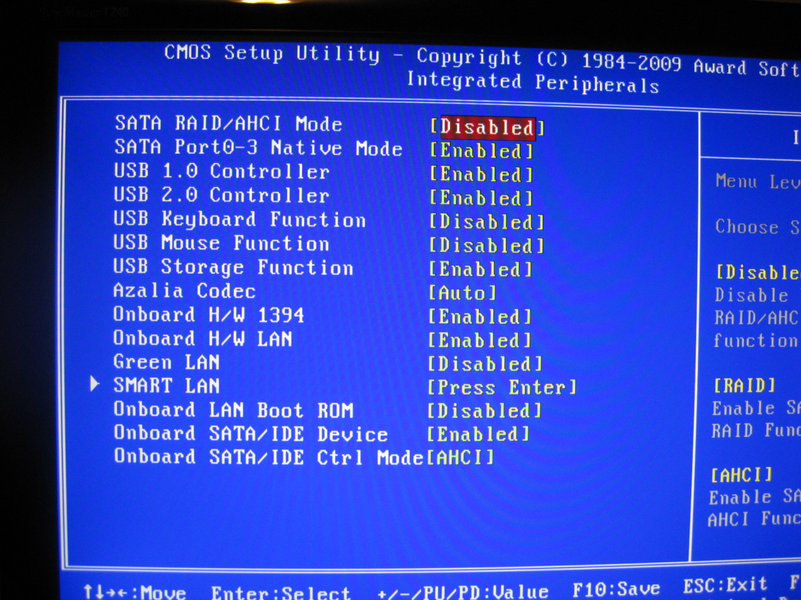

bertmannaustria Posted November 27, 2009 Author Share Posted November 27, 2009 Hi bert. Do I have to make any changes to the bios in order to get this working? For example....what do I have to pick for: - SATA Raid /ahci mode - Onboard Sata/Ide device - onboard Sata/ide ctrl mode Thank you always try ahci mode Here's how it looks when loaded correctly with an EFI string on my other partition: Chipset Model: nVidia GeForce 8800 GT Type: GPU Bus: PCIe PCIe Lane Width: x16 VRAM (Total): 512 MB Vendor: NVIDIA (0x10de) Device ID: 0x0611 Revision ID: 0x00a2 ROM Revision: nVidia GeForce 8800 GT OpenGL Engine [EFI] Displays: DELL E248WFP: Resolution: 1920 x 1200 @ 60 Hz Pixel Depth: 32-Bit Color (ARGB8888) Mirror: Off Online: Yes Rotation: Supported DELL E248WFP: Resolution: 1920 x 1200 @ 60 Hz Pixel Depth: 32-Bit Color (ARGB8888) Main Display: Yes Mirror: Off Online: Yes Rotation: Supported did you try booting with flag "-pci1"? since latest netkas pc efi boot file i have to use it, sorry i forgot Link to comment https://www.insanelymac.com/forum/topic/188663-snow-leopard-on-gigabyte-ga-ex58-ud4p-vanilla-64-bit-kernel/page/5/#findComment-1344279 Share on other sites More sharing options...

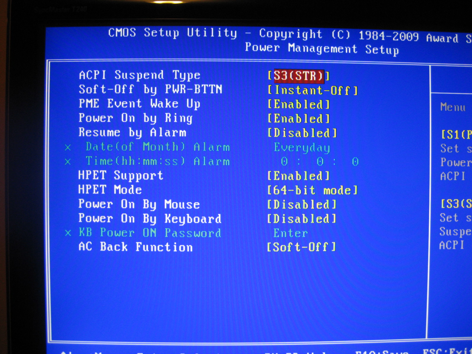

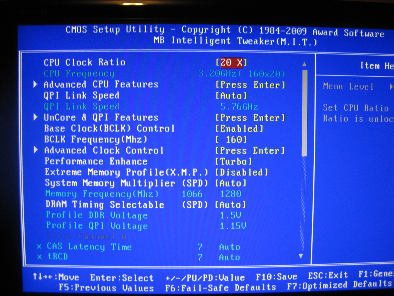

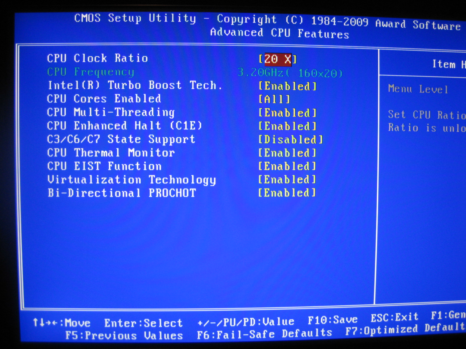

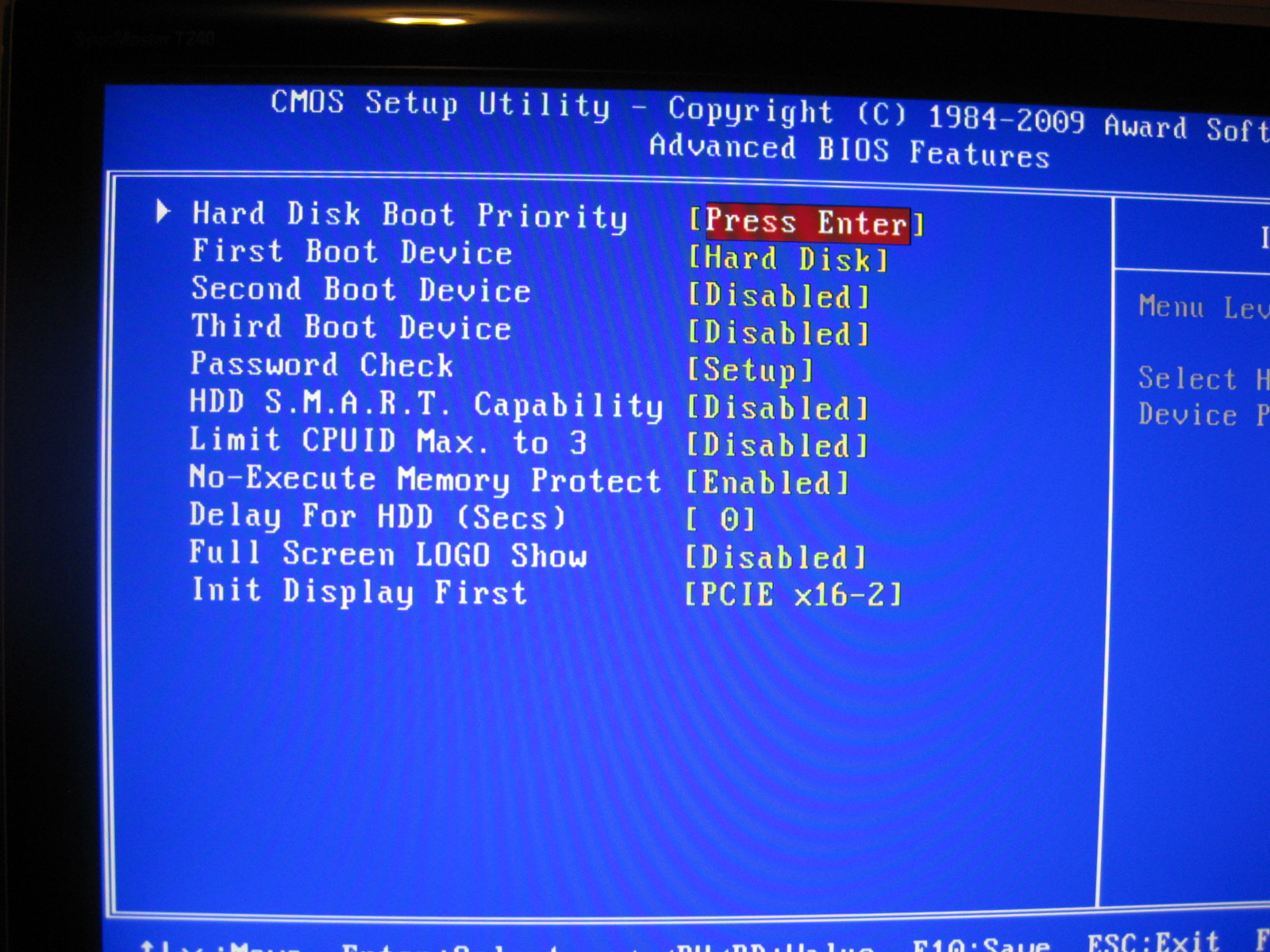

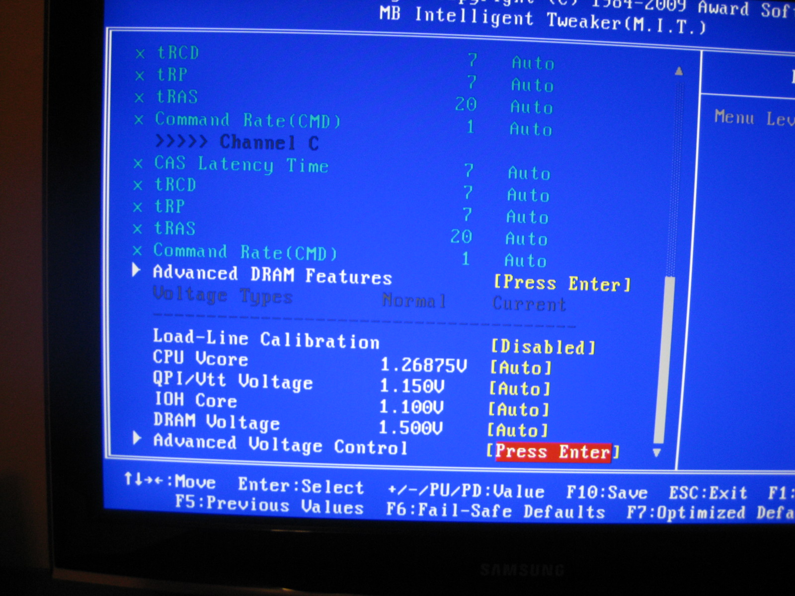

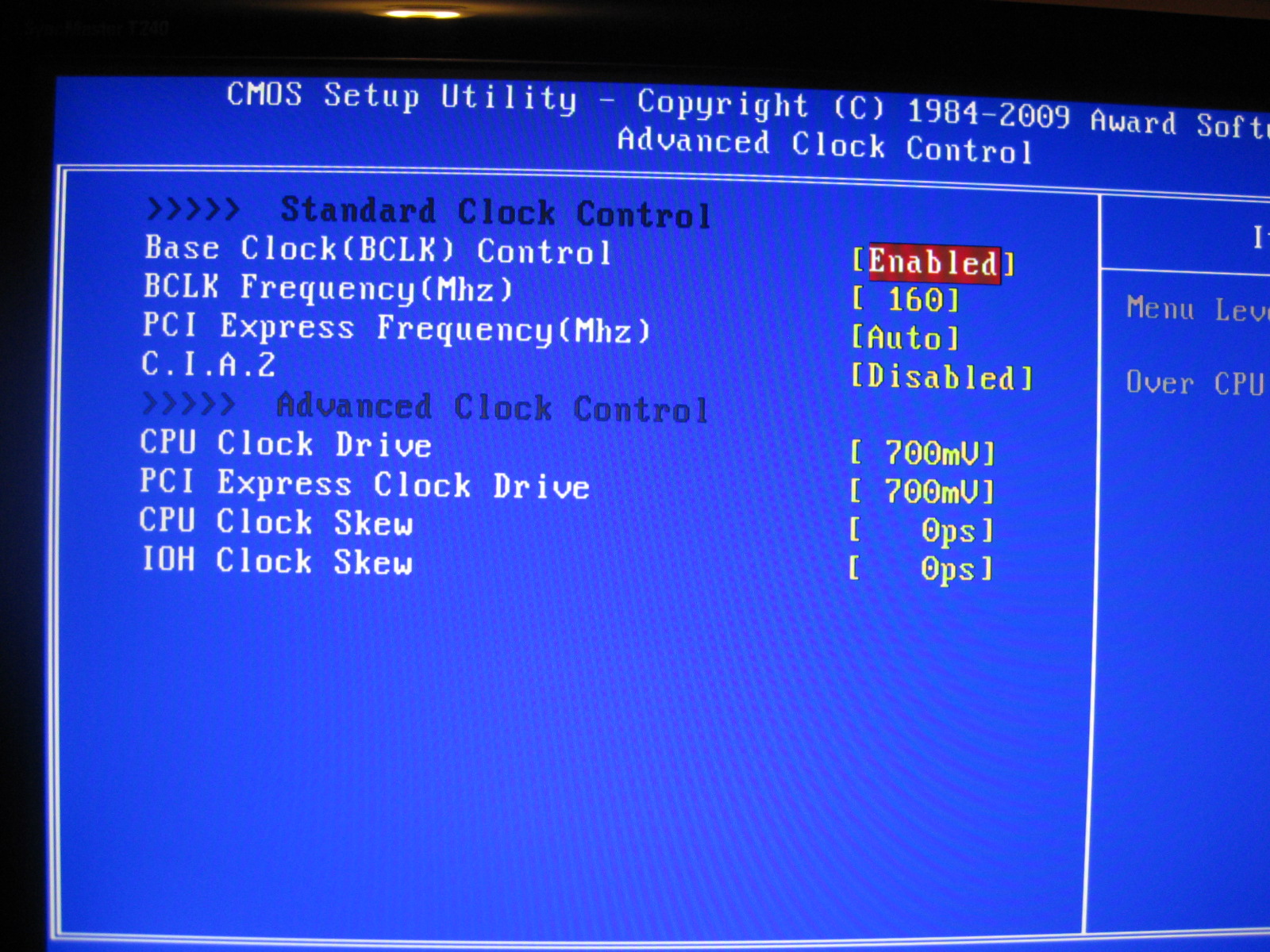

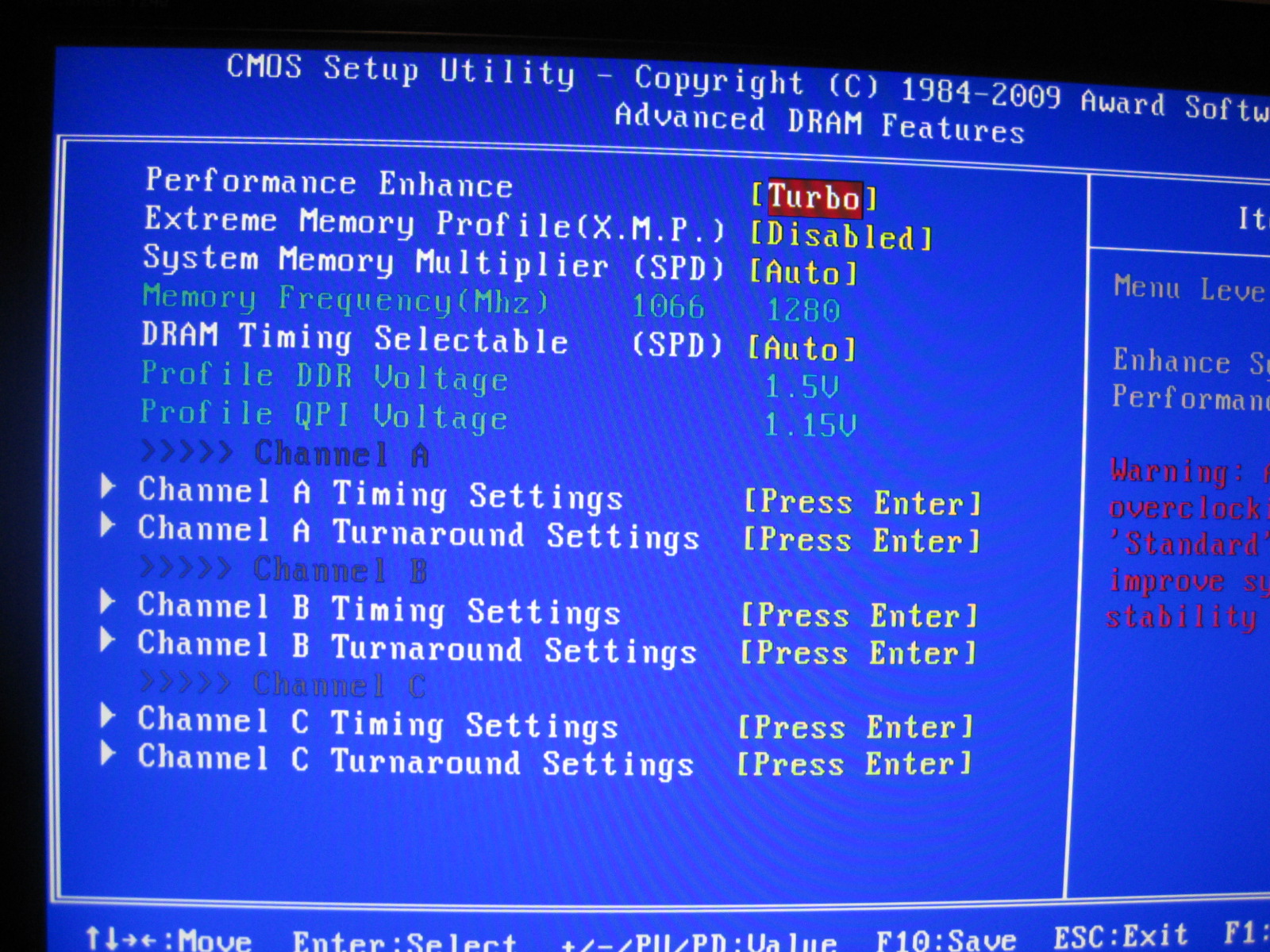

lmps56 Posted December 4, 2009 Share Posted December 4, 2009 is it a completely reset? because it seems to be a rtc problem in your dsdt, are you using my posted dsdt? It always seems to go 5 hours ahead of time. Yes I'm using your dsdt...any ideas? Also neither windows or mac displays my oc'd cpu correctly. They both still show 2.67GHz. Thank you Link to comment https://www.insanelymac.com/forum/topic/188663-snow-leopard-on-gigabyte-ga-ex58-ud4p-vanilla-64-bit-kernel/page/5/#findComment-1350692 Share on other sites More sharing options...
JustinAiken Posted December 4, 2009 Share Posted December 4, 2009 hmm sounds weird, so i can't have a look at your system from there you can start over with a fresh installation or you can post your com.apple.boot.plist and maybe a kext-list Haha, I'm back a few days later... after messing with permissions I killed my system... and kind of had to start fresh! Up and running right now though; 10.6.1 using all your updated kexts (except for the 2 made for 10.6.2), your plist but with EFI string for video, the updated 889a kext, Chameleon RC3, and the latest DSDT you posted... Everything is working well now, and it feels good to have NO kexts inside /S/L/E! Sometime soon I'll try cloning my installs and messing with 10.6.2 again, but for now I'll let things rest... Only one thing; I have a couple of programs that rely upon builtin ethernet to generate copy-protection codes; using the Apple USB ethernet adapter doesn't work, so I can't use these softwares... Is there a ethernet kext I can use that will recogize the realtek builtin to the motherboard? I don't need to actually use port, I just need it recognized so that programs can generate codes off it... Link to comment https://www.insanelymac.com/forum/topic/188663-snow-leopard-on-gigabyte-ga-ex58-ud4p-vanilla-64-bit-kernel/page/5/#findComment-1350946 Share on other sites More sharing options...

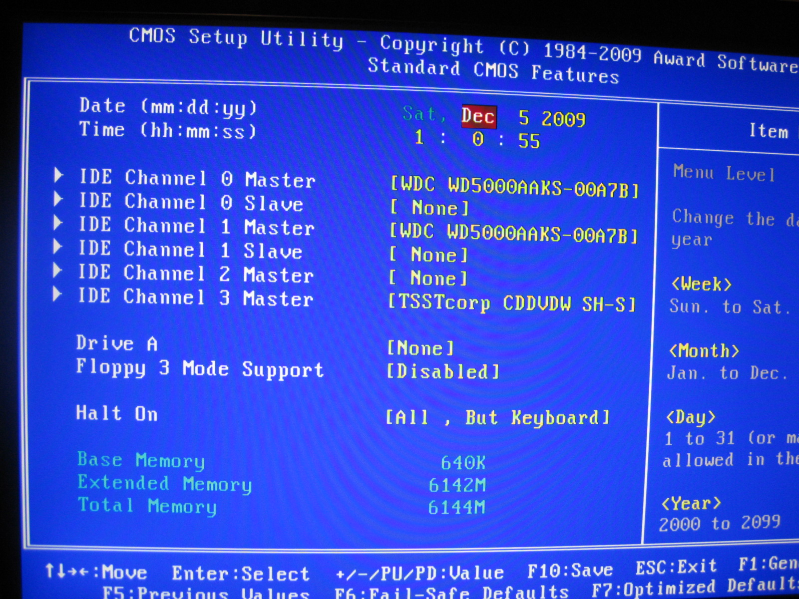

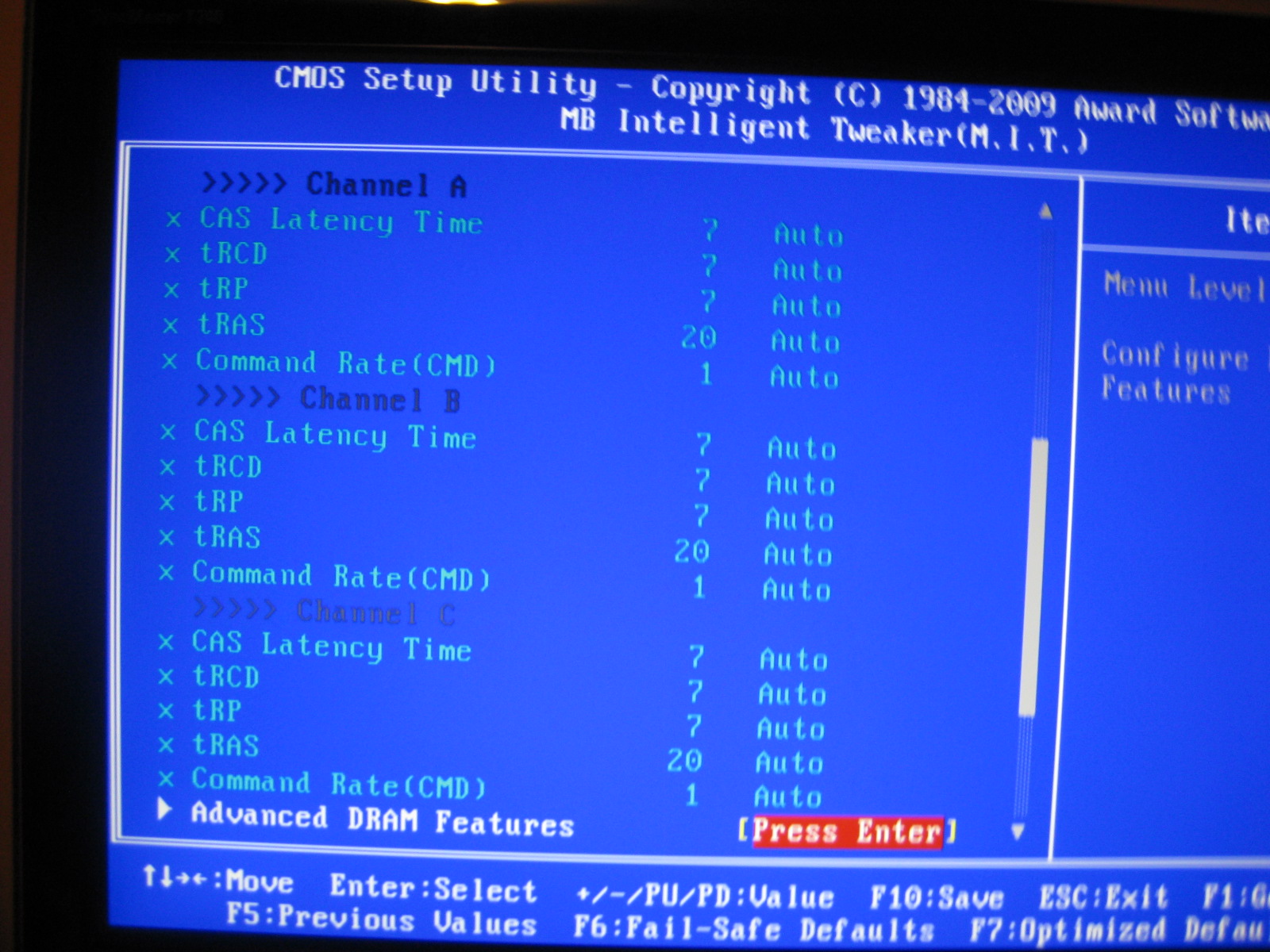

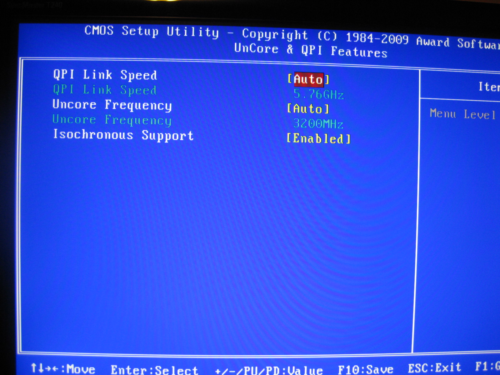

bertmannaustria Posted December 4, 2009 Author Share Posted December 4, 2009 It always seems to go 5 hours ahead of time. Yes I'm using your dsdt...any ideas?Also neither windows or mac displays my oc'd cpu correctly. They both still show 2.67GHz. Thank you hmm sounds weird i know its much to do but can you post all your bios preferences? Haha, I'm back a few days later... after messing with permissions I killed my system... and kind of had to start fresh! Up and running right now though; 10.6.1 using all your updated kexts (except for the 2 made for 10.6.2), your plist but with EFI string for video, the updated 889a kext, Chameleon RC3, and the latest DSDT you posted... Everything is working well now, and it feels good to have NO kexts inside /S/L/E! Sometime soon I'll try cloning my installs and messing with 10.6.2 again, but for now I'll let things rest... Only one thing; I have a couple of programs that rely upon builtin ethernet to generate copy-protection codes; using the Apple USB ethernet adapter doesn't work, so I can't use these softwares... Is there a ethernet kext I can use that will recogize the realtek builtin to the motherboard? I don't need to actually use port, I just need it recognized so that programs can generate codes off it... well done for me the only way to use the onboard realtek as builtin-device is using an efi string in com.apple.boot.plist or add it into the dsdt. chameleon ethernetbuiltin doesn't work at this time, but it's easy, just generate the string with efi studio. Link to comment https://www.insanelymac.com/forum/topic/188663-snow-leopard-on-gigabyte-ga-ex58-ud4p-vanilla-64-bit-kernel/page/5/#findComment-1350955 Share on other sites More sharing options...
lmps56 Posted December 5, 2009 Share Posted December 5, 2009 Here I hope this helps. It does not bother me that I can't see the correct CPU speed in about a mac or system properties. The time does bother me quite a bit though. Thank you Link to comment https://www.insanelymac.com/forum/topic/188663-snow-leopard-on-gigabyte-ga-ex58-ud4p-vanilla-64-bit-kernel/page/5/#findComment-1351066 Share on other sites More sharing options...

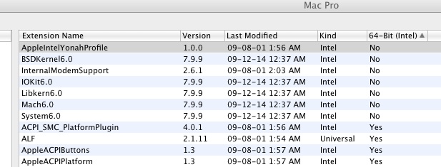

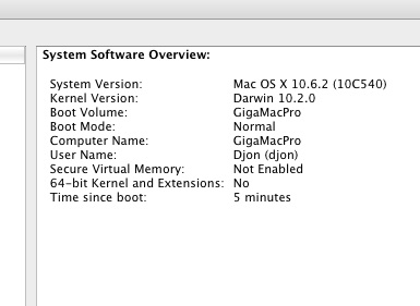

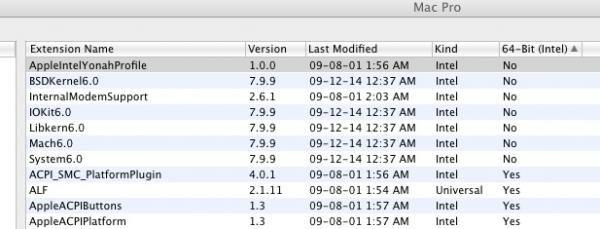

aikidoka25 Posted December 14, 2009 Share Posted December 14, 2009 thanks for you guys i managed to update until 10.6.2 however System Profiler still shows 64-bit Kernel and Extensions: No in E/E/com.apple.boot.plist I have Kernel Flags -x32 arch=x86_64 uname -a Darwin GigaMacPro.local 10.2.0 Darwin Kernel Version 10.2.0: Tue Nov 3 10:37:10 PST 2009; root:xnu-1486.2.11~1/RELEASE_I386 i386 EDIT: I have 12GB of RAM and using ATI HD4870, so I have to add ATY_init.kext in E/E to avoid KP top command results: Processes: 53 total, 3 running, 1 stuck, 49 sleeping, 234 threads 01:56:35 Load Avg: 0.05, 0.11, 0.06 CPU usage: 0.51% user, 0.30% sys, 99.18% idle SharedLibs: 9064K resident, 4096K data, 0B linkedit. MemRegions: 6546 total, 290M resident, 16M private, 143M shared. PhysMem: 861M wired, 479M active, 234M inactive, 1573M used, 11G free. VM: 131G vsize, 1037M framework vsize, 39378(71) pageins, 0(0) pageouts. Networks: packets: 216580/101M in, 330684/179M out. Disks: 26787/1381M read, 35407/1014M written. screens from profiler attached any idea where i have to look? vielen dank! Link to comment https://www.insanelymac.com/forum/topic/188663-snow-leopard-on-gigabyte-ga-ex58-ud4p-vanilla-64-bit-kernel/page/5/#findComment-1358754 Share on other sites More sharing options...
bertmannaustria Posted December 14, 2009 Author Share Posted December 14, 2009 thanks for you guys i managed to update until 10.6.2 however System Profiler still shows 64-bit Kernel and Extensions: No in E/E/com.apple.boot.plist I have Kernel Flags -x32 arch=x86_64 uname -a Darwin GigaMacPro.local 10.2.0 Darwin Kernel Version 10.2.0: Tue Nov 3 10:37:10 PST 2009; root:xnu-1486.2.11~1/RELEASE_I386 i386 EDIT: I have 12GB of RAM and using ATI HD4870, so I have to add ATY_init.kext in E/E to avoid KP top command results: Processes: 53 total, 3 running, 1 stuck, 49 sleeping, 234 threads 01:56:35 Load Avg: 0.05, 0.11, 0.06 CPU usage: 0.51% user, 0.30% sys, 99.18% idle SharedLibs: 9064K resident, 4096K data, 0B linkedit. MemRegions: 6546 total, 290M resident, 16M private, 143M shared. PhysMem: 861M wired, 479M active, 234M inactive, 1573M used, 11G free. VM: 131G vsize, 1037M framework vsize, 39378(71) pageins, 0(0) pageouts. Networks: packets: 216580/101M in, 330684/179M out. Disks: 26787/1381M read, 35407/1014M written. screens from profiler attached any idea where i have to look? vielen dank! hallo, du darfst nicht mit der kernel option "-x32" booten don't boot with kernel flag "-x32" Link to comment https://www.insanelymac.com/forum/topic/188663-snow-leopard-on-gigabyte-ga-ex58-ud4p-vanilla-64-bit-kernel/page/5/#findComment-1358866 Share on other sites More sharing options...

aikidoka25 Posted December 15, 2009 Share Posted December 15, 2009 hallo, du darfst nicht mit der kernel option "-x32" booten don't boot with kernel flag "-x32" UPDATE 4: Using TRUST Bluetooth 2 dongle allows the bluetooth devices twork after resume UPDATE 3: I nuked the installation from the orbit and start all over again. Now I have 64bits + sleep + resume Only one problem left: the bluetooth device doesn't work after resume. I am using a generic one with Cambridge Silicon Radio. Any ideas? UPDATE 2: I managed to boot with -x64 arch=x86_64 -v without KP However all indicators for 64 bits (uname -a, system profiler) still say i386. Is there any place that I could check which part prevented the system to boot into x86_64 kernel? UPDATE: using -x64 arch=x86_64 -v got KP about com.apple.ATIRadeonX2000(6.0.6) could be the display adapter? any ideas? i got KP if i removed -x32 among others the KP said about FakeSMC: key info not found MSDS, length - 6 also few lines below there was a mention about com.apple.ATIRadeonX2000(6.0.6) cheers Link to comment https://www.insanelymac.com/forum/topic/188663-snow-leopard-on-gigabyte-ga-ex58-ud4p-vanilla-64-bit-kernel/page/5/#findComment-1359670 Share on other sites More sharing options...
