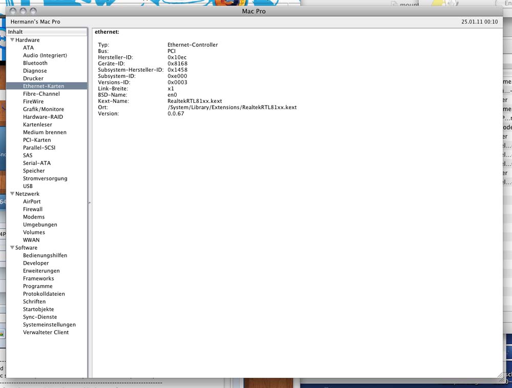

bbourizk Posted October 5, 2009 Share Posted October 5, 2009 hi! i got the sources for RealtekR1000.kext from psystar but i wasn't able to compile them for 64 bit (whitout bugs), the R1000 kext i found here at insanely work but very buggy, that's the reason why i'm using a native pci network card (but pls pm me and send me your RealtekR1000.kext, i'm gonna test it and add it to this guide if it works well) most wifi cards with broadcom chipset will work in 64 bit mode, my atheros cards only work in 32 bit mode because there are no 64 bit drivers available afaik. i choose voodoohda because for me it is the only kext which will work without patching/deleting other kexts (voodoohda is the only non apple kext i have in my /System/Library/Extensions folder), everything works except jack detection - for me it's useless because most of the time i'm using my speakers and if i'm listening over headphones, i plug them into the speakers jack). your kexts ... so if you use only kexts i provided everything should work fine in 64 bit mode. you can start in 32 bit mode, goto system profiler, open software/extension. here you can select every kext loaded into the kernel and have a look if it has 64 bit code under Architecture (Architekturen in my screenshot) no, in bios settings/integrated peripherals choose "SATA RAID/AHCI Mode" --> AHCI and "Onboard SATA/IDE Device --> Enabled "Onboard SATA/IDE Ctrl Mode --> AHCI there's no need for using AppleIntelPIIXATA.kext it's for the JMicron ATA Controller for harddisks, no need for this kext too with UD4P okay, i hope you figure out now but ask if you got more questions Gigabyte UD4P & Asus P6T are my fav boards on snow leopard thanks for the guide waiting for my UD4P to come back from gigabyte ethernet port no longer worked hopefully be here tomorrow i have a Dlink PCI ethernet card which uses Realtek RTL8139/810x family fast ethernet will that get me x64 working with internet? also i'm going to be using ATI 4870 512mb card on another install i used the ATY.init kext which if i'm not mistaken is a x32 bit only thank you Link to comment https://www.insanelymac.com/forum/topic/188663-snow-leopard-on-gigabyte-ga-ex58-ud4p-vanilla-64-bit-kernel/#findComment-1290180 Share on other sites More sharing options...

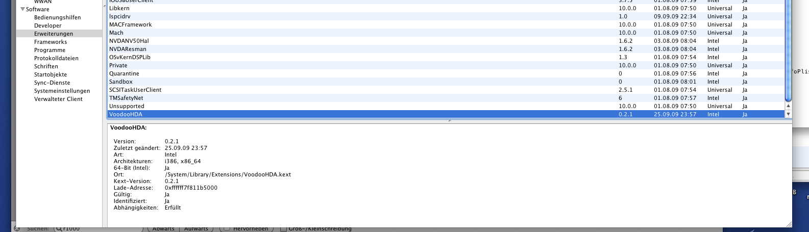

kaidogg Posted October 6, 2009 Share Posted October 6, 2009 hmm and which decryptor are you using? dsmos, appledecrypt, fakesmc? with only these 3 kext you posted it will be a miracle to even enter the snow leo desktop because the loginwindow application is a signed application btw instead AppleAzaliaAudio.kext you can try voodoohda because it is 32/64 bit an can handle most codecs Intel82566MM.kext + IONetworkingFamily.kext should be vanilla kexts, don't use kexts from Leopard 10.5-10.5.8. can you tell me what dell 755 it is, there are so many cheers Hi oh really I didn't know there are many Dell 755 ,, I though It's all same I am using the Big caseing dell 755 ... Hum .. from what I read from the driver page in dell.com .. seems that all 755 drivers fits all version 755 by the way .. since I'm still a OSx86 newbie and not english native ..... my english dictionary is a kaidogg LTD. (limited company ) Strange thing this is what I did from 10.5.8 I use OSinstall.pkg to install 10.6 then within 10.5.8 I install calerlon RC2 to 10.6 HDD copy a Boot from your page to 10.6 root I can't update to 10.6.1 within 10.5.8 cause it won't let me then I copy your extra folder to 10.6 root using DSDT patch at my 10.5.8 and place it to my 10.6 extra I then delete ATI2000x.kext from S/L/E (forgot the excelt name) edit ati4000.kext too add a string for my ATI 4850 and this BOOT up with -v -x32 arch=i386 in boot.plist now ... when I get into 10.6 ( nothing works at this momment , Display card suck at 1440x1050, no QE xx xxCL what so ever) I use kext helper to install those 3 kext up there . network , sound , and io after reboot Internet works , Sound came up .. I can use Time machine now . one last thing is my ATI 4850 I follow some guild and fail ... return to It's normal stage if I fail then one time .. i install ELFPCI 10.3 edit HEX to my boot.plist . well actually It's this post http://www.insanelymac.com/forum/index.php?showtopic=181405 I had to do Both no.1 and no.2 at the same time to get my Serphie ATI 4850 512MB to work in SL I was so happy but thn I find out my Network is gone it can get ip from dchp (router)and I can ping anywhere in the world .. I can connect to my Windows , Mac , server without anyproblem .. Just internet is not working .... STRANGE and this is what I'm up to at this momment I am still using a 10.5.8 untill I get my 10.6 working well well here's my long story I hope this Helps alot of people ,, well at least I hope it works for other dell 755 mates .. I am still not conferdent to write a guide to share it with other dell 755 or others since I learn it from you in this post .. so I share it here .. P.S. my wife is hateing me for Loveing my hardware more then her P.S.2 I do not make love to my PC as some say please don't listen to them ... hahahahahaah P.S.3 ... I've tested the same method with another 2 motherboard i got at home , a Foxconn G31-K (dell use foxconn to so i though it might work), and a gigabyte P35 DS3L .... Up untill the first boot .. everything are same ,,, you Guild WORKS BEST FOR ME ... at least I got all my 3 pc up in 10.6 (tho .. not all Driver works yet, not your or your guide's fault .. It's 64bit) I don't mind installing it within 10.5.8 sorry had to add another PS P.S.4 I just remode the whole extra folder from root and it still boot up nicely (still stuck at 1440 screen and can't connect internet from safari .. LAN works perfectly ) Link to comment https://www.insanelymac.com/forum/topic/188663-snow-leopard-on-gigabyte-ga-ex58-ud4p-vanilla-64-bit-kernel/#findComment-1291136 Share on other sites More sharing options...

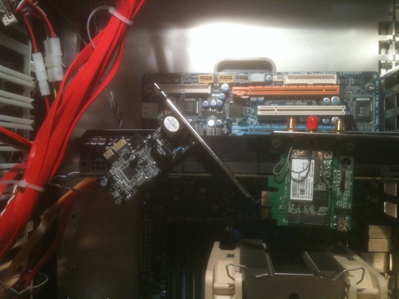

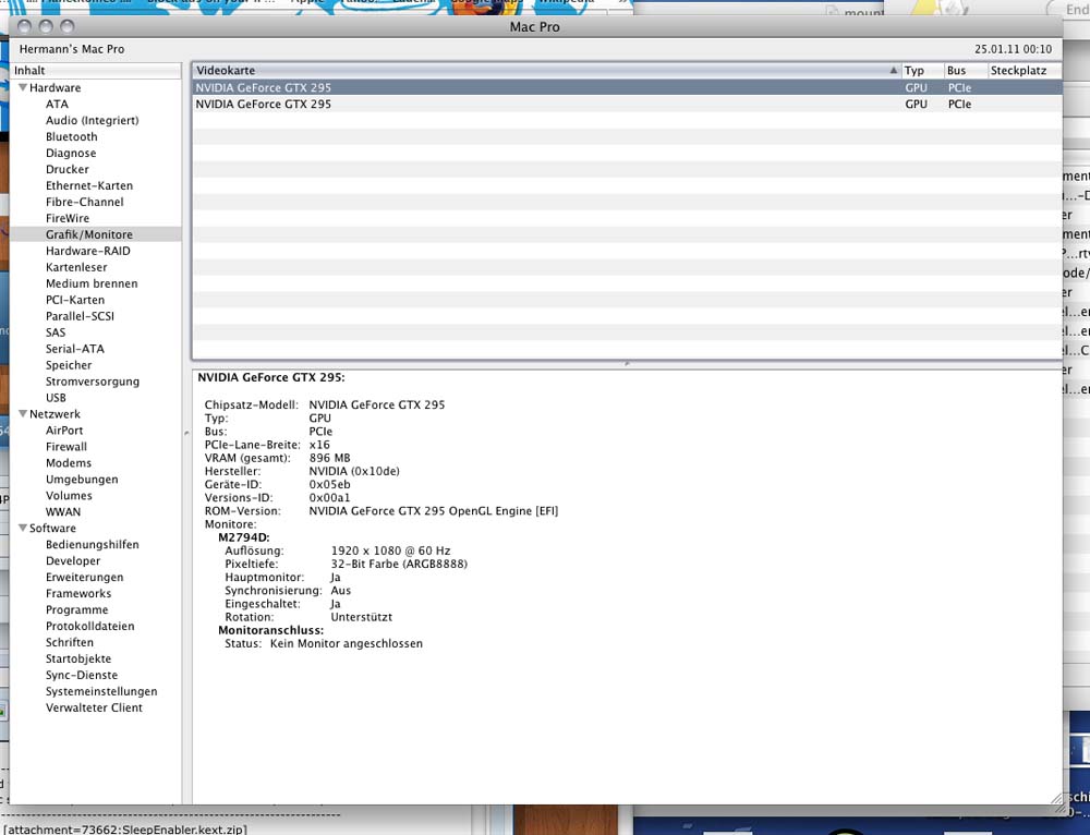

acco Posted October 7, 2009 Share Posted October 7, 2009 ok i've obtain some success... Now my hackintosh boot directlly with gtx 285, it results in the system profile, but there are no signs of QE... Other problems are: no audio and no ethernet. I've read that you don't use the builtin eth but another one, so i've plugged a nic in the last pci slot but without success. What's wrong this time?!? Link to comment https://www.insanelymac.com/forum/topic/188663-snow-leopard-on-gigabyte-ga-ex58-ud4p-vanilla-64-bit-kernel/#findComment-1292880 Share on other sites More sharing options...

acco Posted October 8, 2009 Share Posted October 8, 2009 okay, are you using the chameleon bootloader with graphicsenabler to get the gtx 285 working? if it's so, maybe you just have to edit the /System/Library/Extensions/NVDANV50HAL.kext too, i had to edit that for my gtx 295 co-op too but NOT for the gtx 260. but after i added the 0x05eb10de&0xfff8ffff string into the Info.plist, it worked. sure youre id's are different from mine. then QE/CI should work fine. audio, voodoohda has to be placed in /S/L/E, if you already did this, maybe you have to delete the applehda.kext, but backup it first. what nic is it you plug in now? ALWAYS repair permissions and rebuild Extensions.mkext First thanks for your reply and support, very appreciated! Then, yes i'm using the Chamaleon bootloader (the RC2 linked in your guide. Could i use the RC3?) with graphicsenabler. So you've added that string and after that, in system profile, you have QE/CI enabled (actually i don't see them. I've thought that if they are not supported in the system profile appear some kind of text like 'not supported')?!? Suppose that i have to add a string to my kext too. Should i use the one you write or one for my 285? Where i can find the right for me? And where should i place it in the file? Have you ever tried to install the official nvidia driver? When i try it the system stops to recognise my monitor and i can only use the 1024x768 resolution... And i have to 'force' installation (maybe cause in SL that driver are just included?!?). For audio i've follwed your guide litterally, so i've place the file in /S/L/E but when i boot the system, after a while, a popup tells me that the file can not work, to remove it and try to install it again. I've done something wrong? This evening i'll try to remove applehda to try... For nic i've used a USR based on the Realtek 8169 chip, but it doesn't appear nowhere in osx (But without driver neither Windows 7 can use this nic...). Maybe is the USR one that is not so 'friendlly'. Which one did you use (dlink, linksys or whatelse)? Some more info: - when audio works, all outputs works or just the jack 1/8'' ?!? Cause my audio system could be connected with optical cable, but i don't know if under osx that output can work. - in one last point of your guide you tell to use 'kext utility' but when i drag my 'extensions' folder on it the process end in a sec tells me that it could not create the extension.mkext and it doesnt' repair permissions too... So i've used 'mkexttool' to create the file then moved to the '/Extra' folder. could it be an alternative solution? - when you write to excute the 'chown' command the sysntax is right or did you forget to put the 'sudo' part? Cause if i try to execute without 'sudo' i receive many errors of permission denied. They disappear if i use sudo. One more thing : i've read some guide related to create a patched DSDT for my own system without the need to use kext and injectors. So, for a try, can i remove all the content in the '/Extra' folder and swap the DSDT file in the root with the one i've made (that should let me work directlly with onboard nic, audio and graphics...) or i should try this on a fresh installation?!? Link to comment https://www.insanelymac.com/forum/topic/188663-snow-leopard-on-gigabyte-ga-ex58-ud4p-vanilla-64-bit-kernel/#findComment-1293199 Share on other sites More sharing options...
bertmannaustria Posted October 8, 2009 Author Share Posted October 8, 2009 First thanks for your reply and support, very appreciated! Then, yes i'm using the Chamaleon bootloader (the RC2 linked in your guide. Could i use the RC3?) with graphicsenabler. So you've added that string and after that, in system profile, you have QE/CI enabled (actually i don't see them. I've thought that if they are not supported in the system profile appear some kind of text like 'not supported')?!? RC2 or RC3, it doesn't matter, just use boot file from netkas (copy it to your root folder) Link (read his post) strings for com.apple.boot.plist <key>GraphicsEnabler</key> <string>y</string> boot in verbose mode, if NVDANV50HAL ist beeing loaded at boot BUT your screen remains black or performance is sloppy (because QE/CI is not workin) you have to edit the plist, but just try it first that way and post again if it's not working Suppose that i have to add a string to my kext too. Should i use the one you write or one for my 285? Where i can find the right for me? And where should i place it in the file? as i say, try the other boot file first Have you ever tried to install the official nvidia driver? hell no When i try it the system stops to recognise my monitor and i can only use the 1024x768 resolution... And i have to 'force' installation (maybe cause in SL that driver are just included?!?). ya, drivers are included - when audio works, all outputs works or just the jack 1/8'' ?!? Cause my audio system could be connected with optical cable, but i don't know if under osx that output can work. what kind of audio codec do you have? - in one last point of your guide you tell to use 'kext utility' but when i drag my 'extensions' folder on it the process end in a sec tells me that it could not create the extension.mkext and it doesnt' repair permissions too... So i've used 'mkexttool' to create the file then moved to the '/Extra' folder. could it be an alternative solution? kext utility seems buggy to me, use your terminal "sudo chmod -vR 755 /Extra/Extensions" "sudo chown -vR root:wheel /Extra/Extensions" "sudo kextcache -v 1 -t -m /Extra/Extensions/Extensions.mkext /Extra/Extensions" - when you write to excute the 'chown' command the sysntax is right or did you forget to put the 'sudo' part? Cause if i try to execute without 'sudo' i receive many errors of permission denied. They disappear if i use sudo. ya, i'm sorry, sometimes i forgot the very basic things One more thing : i've read some guide related to create a patched DSDT for my own system without the need to use kext and injectors. So, for a try, can i remove all the content in the '/Extra' folder and swap the DSDT file in the root with the one i've made (that should let me work directlly with onboard nic, audio and graphics...) or i should try this on a fresh installation?!? wait wait, you should patch your dsdt in ANY way but ... you still have to use special kexts or efi-strings for most non apple hardware. do you know what i mean? example, maybe you have audio codec KKK and apple uses codec KKK too, then a patched dsdt may help, but if you have codec KKM and apple uses codec KKK you can patch your dsdt but it won't work. For audio i've follwed your guide litterally, so i've place the file in /S/L/E but when i boot the system, after a while, a popup tells me that the file can not work, to remove it and try to install it again. I've done something wrong? This evening i'll try to remove applehda to try... if you just drag and drop it as non root user inte /S/L/E sure it won't work because of wrong permissions, i think thats what the popup told you, the kext cannot be used. you can use kexthelper for installation. drag and drop the voodoohda.kext into kext helper window, enter your password and hot "EASY INSTALL", it will copy the kext to /S/L/E and set right permissions. try it before deleting applehda. For nic i've used a USR based on the Realtek 8169 chip, but it doesn't appear nowhere in osx (But without driver neither Windows 7 can use this nic...). Maybe is the USR one that is not so 'friendlly'. Which one did you use (dlink, linksys or whatelse)? i'm using 3com nic at the moment. USR is friendly, you just have to edit the info.plist in AppleRTL8169Ethernet.kext, it's locatet in IONetworkingFamily.kext/Contents/Plugins but not at this time, first: download that PCI_Tools_v3.0.0.pkg.zip install it, reboot open the terminal and type lspci -nn | grep 'Ethernet' if nothing happens type lspci -nn the point is, you have to find your Ethernet controller here's an Example (it's not a Realtek 8169 based nic but just ignore it) Ethernet controller [0200]: Marvell Technology Group Ltd. 88E8056 PCI-E Gigabit Ethernet Controller [11ab:4364] (rev 12) as you can see, the hex code of this network card is 11ab:4364 just swap it to 4364:11ab, add "0x" at the beginning and delete the colon so you have 0x436411ab so maybe your's could be 10ec:8169, change it to 0x816910ec, it's just an example, you have to add YOUR id. now open the info.plist in AppleRTL8169Ethernet.kext <key>RTL8169/RTL8110</key> <dict> <key>CFBundleIdentifier</key> <string>com.apple.driver.AppleRTL8169Ethernet</string> <key>Driver Parameters</key> <dict> <key>Checksum Offload</key> <false/> </dict> <key>IOClass</key> <string>AppleRTL8169Ethernet</string> <key>IOPCIClassMatch</key> <string>0x02000000&0xffff0000</string> <key>IOPCIPrimaryMatch</key> <string>0x436411ab 0x816910ec 0x816710ec 0x10321737</string> <key>IOProviderClass</key> <string>IOPCIDevice</string> </dict> save it (you can only save it as root user, if you open the info.plist as normal user in finder with plist edit, it won't save changes) you can edit it with plist edit pro as normal user you can edit it with nano as root user in terminal you can drag and drop it to your desktop, edit it, move it back as normal user with identification (but repair permissions afterwards) in terminal, type "sudo chmod -vR 755 /System/Library/Extensions/IONetworkingFamily.kext" and "sudo chown -vR /System/Library/Extensions/IONetworkingFamily.kext another important thing, after changing anything in /S/L/E you HAVE TO run that command "sudo kextcache -v 1 -t -m /System/Library/Caches/com.apple.kext.caches/Startup/Extensions.mkext /System/Library/Extensions" it will rebuild the kernel extension cache, you can also use "Kext Utility" it's very important to set the right permissions and rebuild caches, if a kext has incorrect permissions it will not be loaded into the kernel while booting process after reboot, your network controller should show up in the network preferences pane good luck Link to comment https://www.insanelymac.com/forum/topic/188663-snow-leopard-on-gigabyte-ga-ex58-ud4p-vanilla-64-bit-kernel/#findComment-1293689 Share on other sites More sharing options...
acco Posted October 9, 2009 Share Posted October 9, 2009 RC2 or RC3, it doesn't matter, just use boot file from netkas (copy it to your root folder) Link (read his post) strings for com.apple.boot.plist <key>GraphicsEnabler</key> <string>y</string> boot in verbose mode, if NVDANV50HAL ist beeing loaded at boot BUT your screen remains black or performance is sloppy (because QE/CI is not workin) you have to edit the plist, but just try it first that way and post again if it's not working Ok, i've done some more test and my conclusion is that QE/CI "should" be enabled cause when the initial video of wellcome is showed it's run smoothlly (in other test/installation it doesn't!). Then i've tried with 'glview' to run some test and it runs every test, except the last one, with an average of 3100 fps. So the missing part in System Profile could be a cosmetic issue? In your System Profile the QE and CI are showed and figured as enabled? what kind of audio codec do you have? I've got a 5.1 speakers system (DD, DTS and others). Anyway following your step yesterday i was able to got audio works (but not on optical output, not a big problem!). kext utility seems buggy to me, use your terminal"sudo chmod -vR 755 /Extra/Extensions" "sudo chown -vR root:wheel /Extra/Extensions" "sudo kextcache -v 1 -t -m /Extra/Extensions/Extensions.mkext /Extra/Extensions" On this point i've got some more problems. The first two commands works without warnings/errors. But the 'kextcache' returns me a lot of problems, mainlly errors on missing dependencies. So i was not able to create the 'Extensions.mkext' file. Cause i'm traying some little customizations: i've installed the chameleon, extra folder etc on an usb key instead the hard disk (doing so if i wanna try a different combinations of bootladers, kext and so on i have not to reinstall osx each time). So after the initial error caused by kextcache, that was run on my MacBook with target the usb key, i've used kext utility on the hackintosh with SL and it works fine! (i hope to have obtained the same results following this way!...). Just for my kowledge: create the extensions.mkext is mandatory or have the /Extensions folder is sufficent?!? wait wait, you should patch your dsdt in ANY way but ... you still have to use special kexts or efi-strings for most non apple hardware. do you know what i mean? example, maybe you have audio codec KKK and apple uses codec KKK too, then a patched dsdt may help, but if you have codec KKM and apple uses codec KKK you can patch your dsdt but it won't work. Ok, that's clear! if you just drag and drop it as non root user inte /S/L/E sure it won't work because of wrong permissions, i think thats what the popup told you, the kext cannot be used. you can use kexthelper for installation. drag and drop the voodoohda.kext into kext helper window, enter your password and hot "EASY INSTALL", it will copy the kext to /S/L/E and set right permissions. try it before deleting applehda. Ok, this way completed without errors! i'm using 3com nic at the moment. USR is friendly, you just have to edit the info.plist in AppleRTL8169Ethernet.kext, it's locatet in IONetworkingFamily.kext/Contents/Plugins but not at this time, first:download that PCI_Tools_v3.0.0.pkg.zip install it, reboot open the terminal and type lspci -nn | grep 'Ethernet' if nothing happens type lspci -nn the point is, you have to find your Ethernet controller here's an Example (it's not a Realtek 8169 based nic but just ignore it) Ethernet controller [0200]: Marvell Technology Group Ltd. 88E8056 PCI-E Gigabit Ethernet Controller [11ab:4364] (rev 12) as you can see, the hex code of this network card is 11ab:4364 just swap it to 4364:11ab, add "0x" at the beginning and delete the colon so you have 0x436411ab so maybe your's could be 10ec:8169, change it to 0x816910ec, it's just an example, you have to add YOUR id. now open the info.plist in AppleRTL8169Ethernet.kext <key>RTL8169/RTL8110</key> <dict> <key>CFBundleIdentifier</key> <string>com.apple.driver.AppleRTL8169Ethernet</string> <key>Driver Parameters</key> <dict> <key>Checksum Offload</key> <false/> </dict> <key>IOClass</key> <string>AppleRTL8169Ethernet</string> <key>IOPCIClassMatch</key> <string>0x02000000&0xffff0000</string> <key>IOPCIPrimaryMatch</key> <string>0x436411ab 0x816910ec 0x816710ec 0x10321737</string> <key>IOProviderClass</key> <string>IOPCIDevice</string> </dict> save it (you can only save it as root user, if you open the info.plist as normal user in finder with plist edit, it won't save changes) you can edit it with plist edit pro as normal user you can edit it with nano as root user in terminal you can drag and drop it to your desktop, edit it, move it back as normal user with identification (but repair permissions afterwards) in terminal, type "sudo chmod -vR 755 /System/Library/Extensions/IONetworkingFamily.kext" and "sudo chown -vR /System/Library/Extensions/IONetworkingFamily.kext another important thing, after changing anything in /S/L/E you HAVE TO run that command "sudo kextcache -v 1 -t -m /System/Library/Caches/com.apple.kext.caches/Startup/Extensions.mkext /System/Library/Extensions" it will rebuild the kernel extension cache, you can also use "Kext Utility" it's very important to set the right permissions and rebuild caches, if a kext has incorrect permissions it will not be loaded into the kernel while booting process after reboot, your network controller should show up in the network preferences pane good luck Mmmmm....now that i've read this passage again i've noticed that i do some steps wrong! It was 1,15 AM and the bed was call me! So before tell you i was unable to do this i'll try again this evening! Anyway for this step the PCI Tools, after installed and rebooted, doesn't work. If i remeber the error message was some like this: 'No access method'. So i've looked for an alternative to find id of pci devices finding the 'DPCIManager' tool that has founded my USR nic. Using this tool should not be a problem, right? Ok, now some other things, sorry if i 'abuse' of your patience but i wanna know and understand to be able to do it myself! How can i fix how the system see the processor? I not mean just in the System Profile that it's only a cosmetic thing, but have osx to know and use alle available cores! Thanks again for everything! Link to comment https://www.insanelymac.com/forum/topic/188663-snow-leopard-on-gigabyte-ga-ex58-ud4p-vanilla-64-bit-kernel/#findComment-1294157 Share on other sites More sharing options...
bertmannaustria Posted October 9, 2009 Author Share Posted October 9, 2009 Ok, i've done some more test and my conclusion is that QE/CI "should" be enabled cause when the initial video of wellcome is showed it's run smoothlly (in other test/installation it doesn't!). Then i've tried with 'glview' to run some test and it runs every test, except the last one, with an average of 3100 fps.So the missing part in System Profile could be a cosmetic issue? In your System Profile the QE and CI are showed and figured as enabled? no, QE/CI status will not show up on a real mac too since snow leopard. but as you can see, everything runs smooth, if QE/CI is not working, you feel and see it anyway I've got a 5.1 speakers system (DD, DTS and others). Anyway following your step yesterday i was able to got audio works (but not on optical output, not a big problem!). VoodooHDA is under heavy development, you should take a look at their forum from time to time. On this point i've got some more problems. The first two commands works without warnings/errors. But the 'kextcache' returns me a lot of problems, mainlly errors on missing dependencies. So i was not able to create the 'Extensions.mkext' file. Cause i'm traying some little customizations: i've installed the chameleon, extra folder etc on an usb key instead the hard disk (doing so if i wanna try a different combinations of bootladers, kext and so on i have not to reinstall osx each time). So after the initial error caused by kextcache, that was run on my MacBook with target the usb key, i've used kext utility on the hackintosh with SL and it works fine! (i hope to have obtained the same results following this way!...).Just for my kowledge: create the extensions.mkext is mandatory or have the /Extensions folder is sufficent?!? Extension.mkext is just for better boot performance but Extensions folder is essential Mmmmm....now that i've read this passage again i've noticed that i do some steps wrong! It was 1,15 AM and the bed was call me! So before tell you i was unable to do this i'll try again this evening! Anyway for this step the PCI Tools, after installed and rebooted, doesn't work. If i remeber the error message was some like this: 'No access method'. So i've looked for an alternative to find id of pci devices finding the 'DPCIManager' tool that has founded my USR nic. Using this tool should not be a problem, right? haha i know that you mean, sometimes i fall asleep while typing some code sure you can use DPCIManager too Ok, now some other things, sorry if i 'abuse' of your patience but i wanna know and understand to be able to do it myself! How can i fix how the system see the processor? I not mean just in the System Profile that it's only a cosmetic thing, but have osx to know and use alle available cores! no prob just goto activity monitor, it will show you alle available cores, if not, your dsdt needs more paching, in systemprofiler it's a cosmetic thing Thanks again for everything! you're welcome Link to comment https://www.insanelymac.com/forum/topic/188663-snow-leopard-on-gigabyte-ga-ex58-ud4p-vanilla-64-bit-kernel/#findComment-1294456 Share on other sites More sharing options...
acco Posted October 9, 2009 Share Posted October 9, 2009 Hi again, so... i've repeated the instructions to make my USR nic fully work and... YES i've do!! The only thing to adjust is the link speed: if i left it on automatically the nic acts like an Ethernet nic, so i have to force it in the advanced preferences to acts like a Gigabit nic! For the QE/CI that are not more showed in the System Profile i didn't know that, i was conviced that there were some more problems to resolve! For the audio i can use the builtin audio with the 1/8'' jacks (the only thing that appear to me is that the bass signal is, in some ways, redirected to frontal and rear speakers too! mmm... i've just tested it and this impression is the same under windows7... i think my 'old' Audigy was better in the audio managment ). For the moulti cores of my i7 920, in activity monitor i see just one core... Do you got 4 or 8 cores there?!? If you do, and you tell me that are problem related to 'dsdt.aml' i'm missing something cause i'm using the dsdt file that you've provided in your guide! Have a nice evening/nite! PS: did you know if there are some ways to got my SB Audigy to works properlly under OSX?!? Link to comment https://www.insanelymac.com/forum/topic/188663-snow-leopard-on-gigabyte-ga-ex58-ud4p-vanilla-64-bit-kernel/#findComment-1294636 Share on other sites More sharing options...

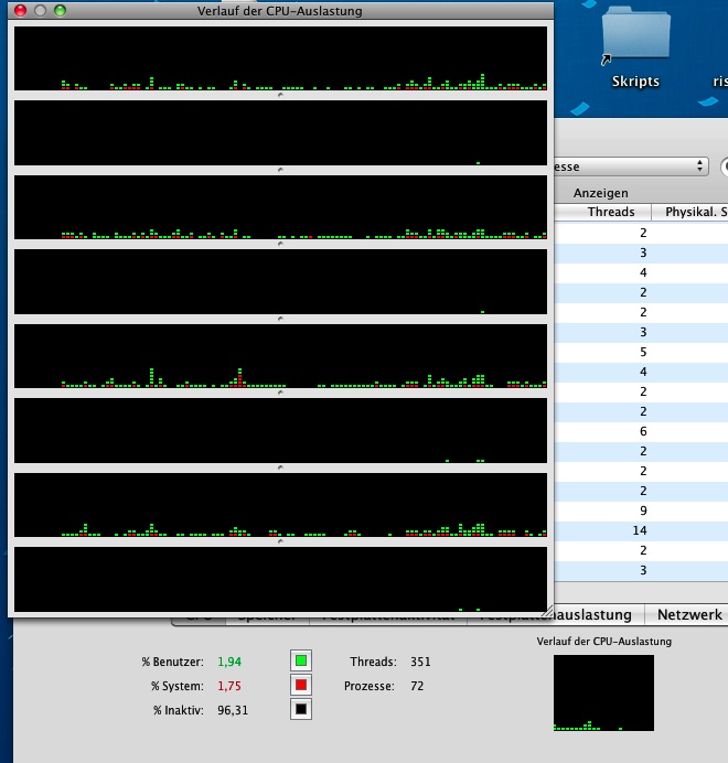

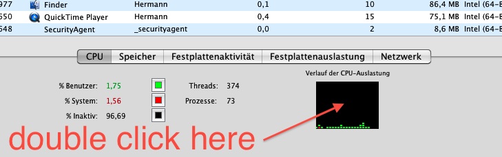

bertmannaustria Posted October 10, 2009 Author Share Posted October 10, 2009 Hi again, so... i've repeated the instructions to make my USR nic fully work and... YES i've do!! The only thing to adjust is the link speed: if i left it on automatically the nic acts like an Ethernet nic, so i have to force it in the advanced preferences to acts like a Gigabit nic! For the QE/CI that are not more showed in the System Profile i didn't know that, i was conviced that there were some more problems to resolve! For the audio i can use the builtin audio with the 1/8'' jacks (the only thing that appear to me is that the bass signal is, in some ways, redirected to frontal and rear speakers too! mmm... i've just tested it and this impression is the same under windows7... i think my 'old' Audigy was better in the audio managment ). For the moulti cores of my i7 920, in activity monitor i see just one core... Do you got 4 or 8 cores there?!? If you do, and you tell me that are problem related to 'dsdt.aml' i'm missing something cause i'm using the dsdt file that you've provided in your guide! Have a nice evening/nite! PS: did you know if there are some ways to got my SB Audigy to works properlly under OSX?!? hi, you just see only "one core" because 8 are too much to display what SB Audigy do you have? Link to comment https://www.insanelymac.com/forum/topic/188663-snow-leopard-on-gigabyte-ga-ex58-ud4p-vanilla-64-bit-kernel/#findComment-1295282 Share on other sites More sharing options...
acco Posted October 10, 2009 Share Posted October 10, 2009 Ah ok, now it's clear! In fact i've noticed that in System Profiler it says that there is 1 processor and 4 cores! Ok they became 8 logical cores thanks to HT but i didn't understand way on my Macbook, that has 2 cores, in activity monitor are both displayed and here they don't. But 8 cores are too much to stay in the same little windows! What string should i use to swap the "unknow" with "Core i7 920" in 'info about this system'? Should i change strings in the smbios.plist file? About the sound card i was wrong, or better i got an Audigy and an Audigy2 too, but my last sound card is an SB X-Fi Fatality (with the front panel) but i don't think there is kext to use this card, i'll do some searches!... Why do you copy your 'com.apple.Boot.plist' in /Library/Preferences/SystemConfiguration? It's not sufficent in the /Extra folder? Link to comment https://www.insanelymac.com/forum/topic/188663-snow-leopard-on-gigabyte-ga-ex58-ud4p-vanilla-64-bit-kernel/#findComment-1295302 Share on other sites More sharing options...
