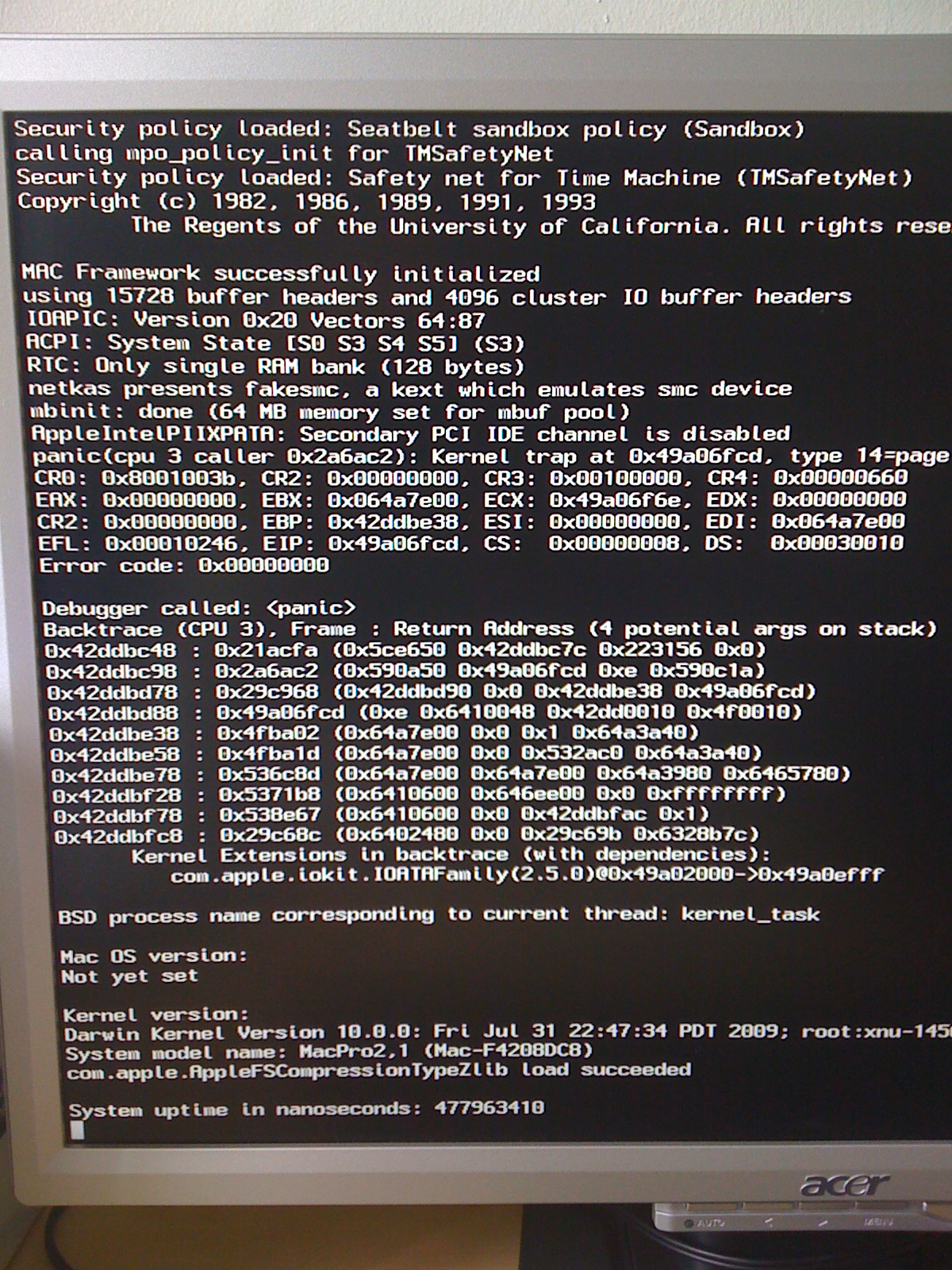

sigmaris Posted September 15, 2009 Share Posted September 15, 2009 For people having panics caused by AppleIntelPIIXATA.kext on Snow Leopard (e.g. on Intel BadAxe or BadAxe2 mobo) this kext may provide a solution. AppleIntelPIIXATA loading on a system with the secondary PCI IDE channel disabled seems to trigger a bug in IOATAFamily causing a NULL pointer dereference. I have patched the source of IOATAFamily from Snow Leopard to avoid the bug and recompiled it. If you are having panics looking like this, try replacing your IOATAFamily.kext with the attached one, and let me know if it fixes the panic. I have gotten access to my PATA drives on a BadAxe 1 board using this kext. Note that this is not the IOATAFamily from 10.5.8 as described here, it is compiled from patched Snow Leopard source code. The source is available from Apple here and the small patch I used is also attached to this post. The AppleIntelPIIXATA.kext is also included in the PlugIns folder of the attached kext, but it is unmodified. Edit: replaced the suspect .tar.gz with a .zip file Edit 2/4/10: Apple have fixed the bug in 10.6.3, so this patch isn't needed/useful anymore for 10.6.3+ systems. IOATAFamily_panic_fix.patch.zip IOATAFamily.kext.zip 1 Link to comment https://www.insanelymac.com/forum/topic/186609-fix-for-ioatafamily-appleintelpiixata-panic-in-snow-leopard/ Share on other sites More sharing options...

sigmaris Posted September 15, 2009 Author Share Posted September 15, 2009 It does not with Boot-132 or BootCD. Did you only test your patch by copying it over Snow Leopard's IOATAFamily.kext (inside Snow Leopard's dmg file)? I haven't tested it with the boot-132 / cdboot as I can't get the CD to boot on my system. It just resets as soon as it it loads off the CD after the BIOS screen. From what I know, it should theoretically work when loaded from boot-132 or /Extra/Extensions, though, as it will load first and override the vanilla IOATAFamily. Link to comment https://www.insanelymac.com/forum/topic/186609-fix-for-ioatafamily-appleintelpiixata-panic-in-snow-leopard/#findComment-1266791 Share on other sites More sharing options...

el_charlie Posted September 16, 2009 Share Posted September 16, 2009 Ok, my impressions about the kext. It DOES work on 32/64 bits on my motherboard Foxconn G31MV-K with the ICH7 southbridge. However, on 64bits, my SATA hard drive is not recognized. The system boots fine (my Snow Leopard installation is on my 80GB IDE HD) but the 2 partitions of my SATA drive (Windows 7 and Data) doesn't show up. Now I will test the kext, leaving untouched the vanilla on S/L/E and try this on EFI/Extra/Extensions to see if it works. EDIT: It works fu***ng great! I mean, in my case it doesn't work on EFI/Extra/Extensions (the vanilla still loads and KPs). But it works great on 64 bits on /System/Library/Extensions. When I said it didn't recognize my SATA drive, I was wrong. NTFS-3G doesn't work on 64 bits. Therefore, my 2 partitions on the SATA drive didn't mount. But the SATA drive appears fine on System profiler. Thanks for this AMAZING kext. Thank you, thank you, thank you!!!! Cheers!! Link to comment https://www.insanelymac.com/forum/topic/186609-fix-for-ioatafamily-appleintelpiixata-panic-in-snow-leopard/#findComment-1267997 Share on other sites More sharing options...

VIP-death Posted September 16, 2009 Share Posted September 16, 2009 I have ICH-7-R and this patched kext works for me in x32 Snow.I put this pathed kext in Extra/Extentions and leaving untouchable the vanilla kext in /System/Library/Extentions and everything works great, no more kernel panic. Link to comment https://www.insanelymac.com/forum/topic/186609-fix-for-ioatafamily-appleintelpiixata-panic-in-snow-leopard/#findComment-1268071 Share on other sites More sharing options...

timewise Posted September 16, 2009 Share Posted September 16, 2009 Nice patch! I am now booting my bad axe 2 in ide mode I was also able to remove AHCIPortInjector.kext, ATAPortInjector.kext and IOAHCIBlockStorageInjector.kext THX Link to comment https://www.insanelymac.com/forum/topic/186609-fix-for-ioatafamily-appleintelpiixata-panic-in-snow-leopard/#findComment-1268108 Share on other sites More sharing options...

sigmaris Posted September 16, 2009 Author Share Posted September 16, 2009 As far as chipset goes, this patch doesn't add support for any more ICH chipsets than what the standard AppleIntelPIIXATA supports, it just fixes the kernel panic in IOATAFamily that's triggered by AppleIntelPIIXATA. I believe -DuNe- is working on support for additional chipsets in AppleIntelPIIXATA under Snow Leo, see this thread Link to comment https://www.insanelymac.com/forum/topic/186609-fix-for-ioatafamily-appleintelpiixata-panic-in-snow-leopard/#findComment-1268439 Share on other sites More sharing options...
