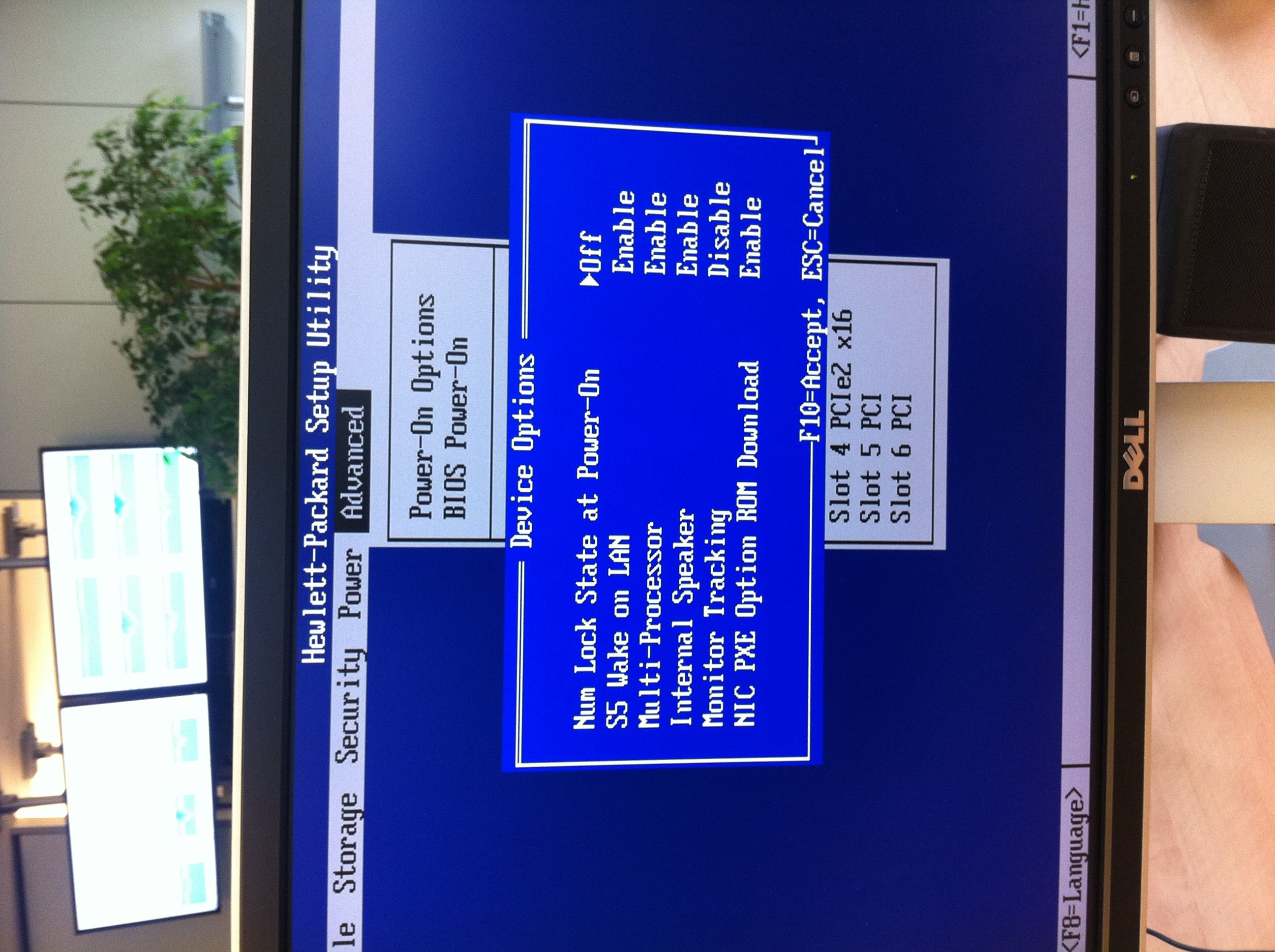

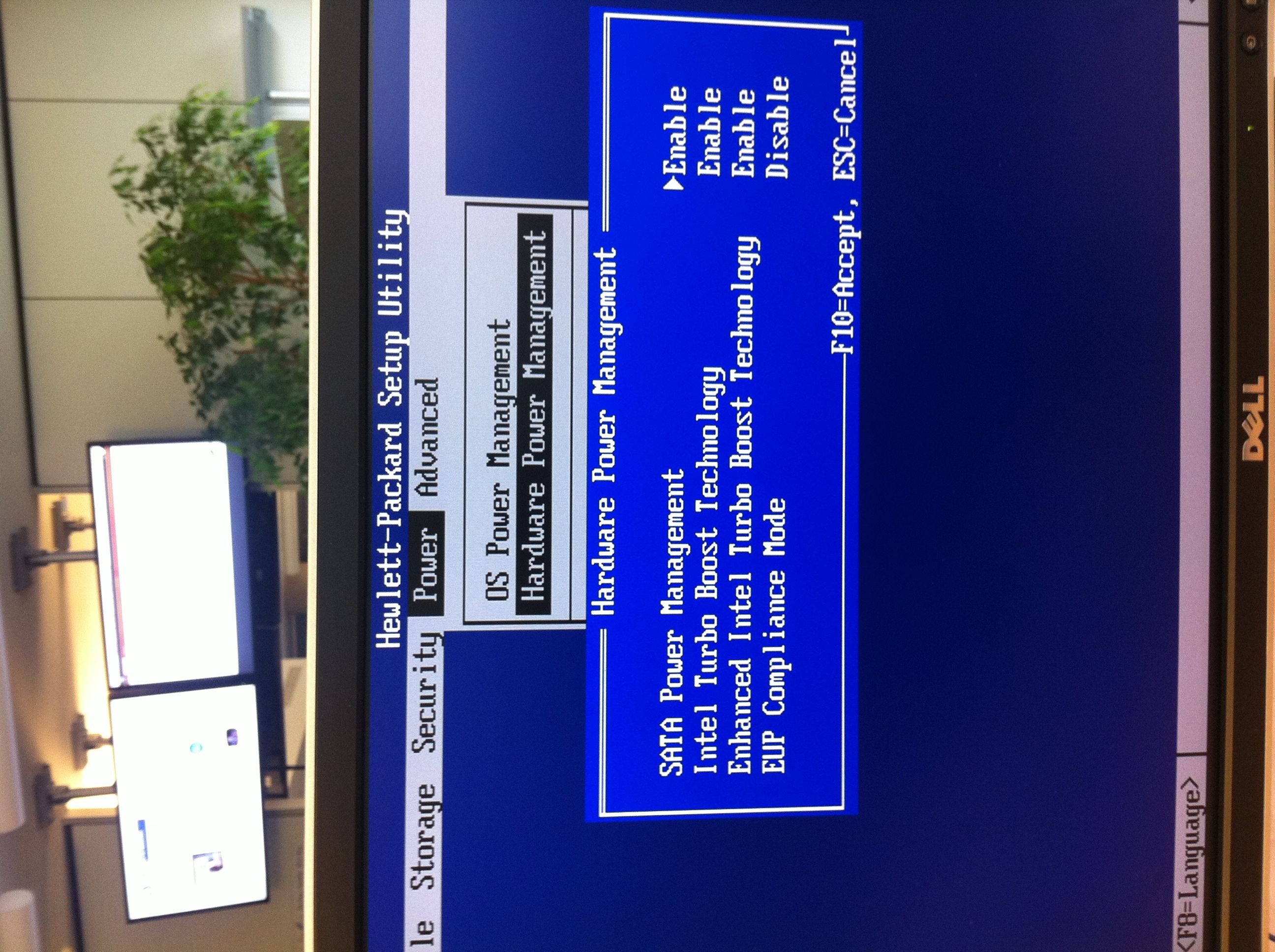

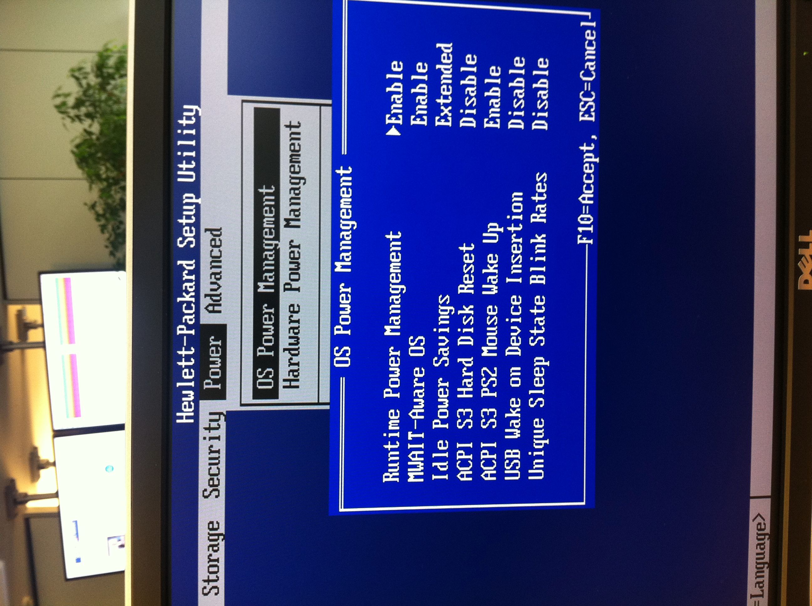

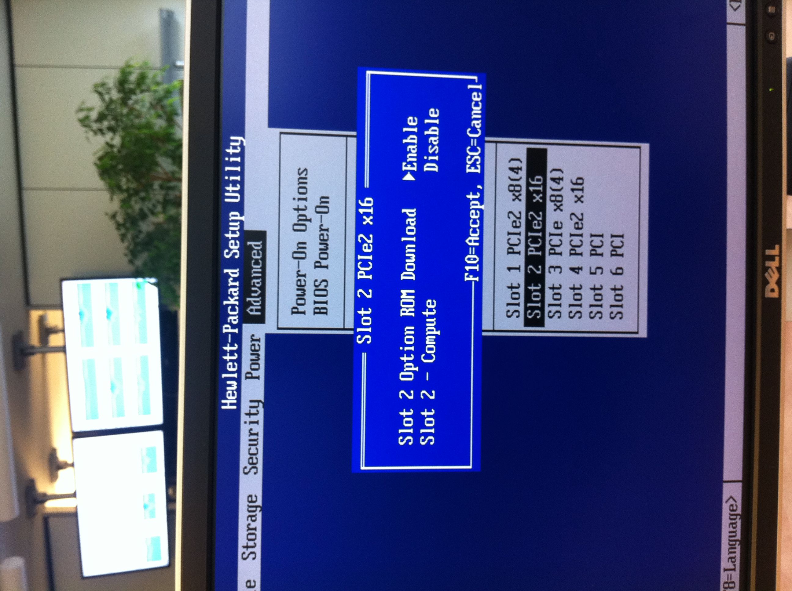

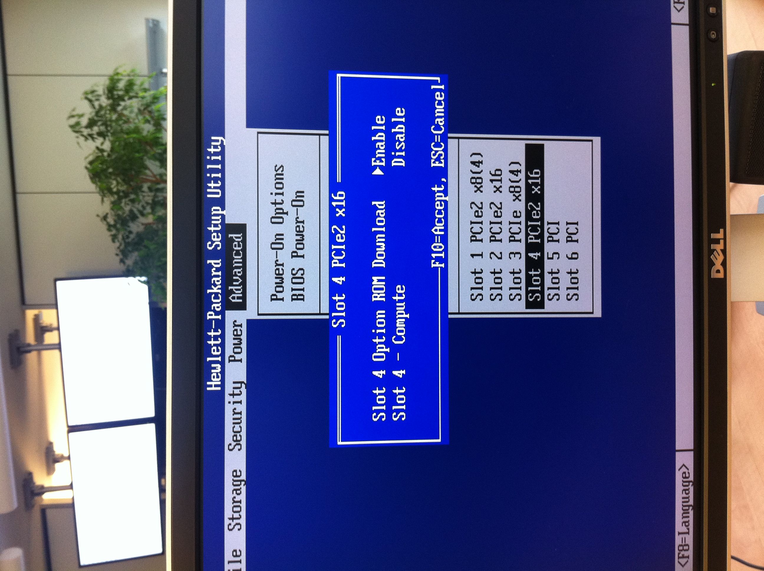

Hello,
i used this technique on my Gigabyte Board and also used PEG2.
So now I have a new machine HP Z400 and this machine has no PEG2.
But if 2 Cards in the PC I can use the 1st or 2nd slot as the primary.
So I switched to 2nd slot primary.
I used the tutorial here and from aquamac (same way as the Gigabyte machine).
So everything works fine I do the stuff boot the machine with both cards in it and 3 monitors with 2 cards works well.
BUT I have NO QE/CI enabled on the HP machine. On the Gigabyte machine I have also 3 monitors + 2 cards with QE/CI.
So maybe someone can help me with my problem. Do I maybe need any settings in the BIOS => Power Management to geht QE/CI working??
Here are some photos I made this days.
Thanks a lot!
Greetings
Unisex
