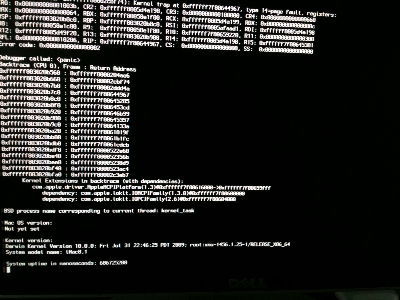

I'm trying to install SL on my Asus P5KPL-AM SE (G31 Chipset) with a HD4850 512MB.
I've tried to bind in some kexts, but i always get:
AppleACPIPlatform
Kernel Panics upon first boot.
Any suggestions?

Thanks for the howto, tho i didn't worked for me.
AppleACPIPlatform
Any suggestions?
Thanks

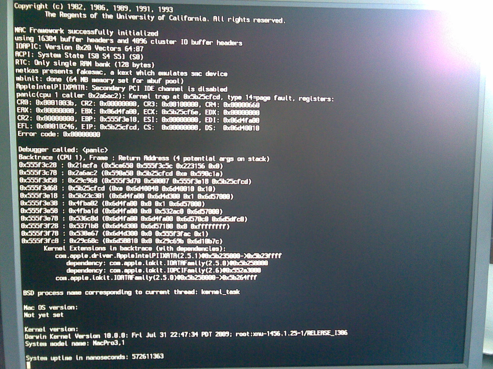

Hi, I decided to try Snow Leopard and I thought it would be easy, but it was not...
I used efi string for graphic card so there should not be a problem.
Maybe I am missing some kext, so I came here where someone can help me with kext and kp.

When booted with -v and this is the error i got
Thank you for any kind of answer.
JMicron + appleintelpiixata.kext with dev ID's check kexts in guide

The question is what those "Needed Kexts" might be. Even with AHCIPortInjector, the updated AppleIntelPIIXATA and the EVOenabler, I get the white striped black screen.
Starting the installer with -x -v works fine and after completed installation, I can start the OS with -x -v (ofc in 1024x768 only).
Don't know if it matters but when starting the installer with no options at all I just get an empty gray screen and no mouse cursor.
I'm in the same boat as you are. I reckon it's the display drivers that is the problem.
Thanks for fast reply, and again no need for apologies. We all need good and well deserved sleep :)
It seems I was using right kexts...
chameleon usb bootloader works, but when I select Snow Leopard Installer partition the same kernel panic appears. (screenshot posted in the first post on this page)
Update
Solved (-bios settings-)
-this motherboard is incredible complicated to setup
-SATA must be set as IDE with COMBINED (if I didnt accidentally clicked that, I would never have figure it out)

the needed kexts are fakesmc.kext, openhaltrestart.kext, and nullcpupowermanagement.kext, check the graphics card section of these forums and see if you can find a solution to your card.
If you are still KP, try changing the bios set up for your IDE/AHCI/SATA cards to get it to boot.
Unfortunately, I already have those kexts, so it seems to be the driver that need some manipulation.
But thanks for your effort to help anyhow!
For some reason i keep getting the error below when trying to boot the installer from a dvd, not sure what else i need to add or change? Any help would be appreciated:
you have retail 10.5 kexts loading over the snow leopard kexts

List all the kexts you have in your extra/extensions folder. i'll tell you which ones to take out.
Thank You. I have fakesmc.kext, OpenHaltRestart.kext, and NullCpuPowermangement.kext in extra/extensions.
In my Extra folder i have a DSDT.aml that worked with my 10.5 install and i modified to fix the cmos snow leopard bug, i also have a com.apple.boot.plist from and an extensions.mkext that i took from another snow leopard pack.
the extensions.mkext has some bad kexts in it. post your LSPCI please.
