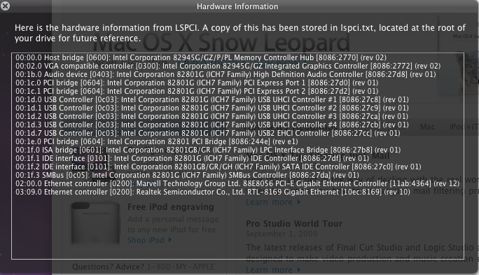

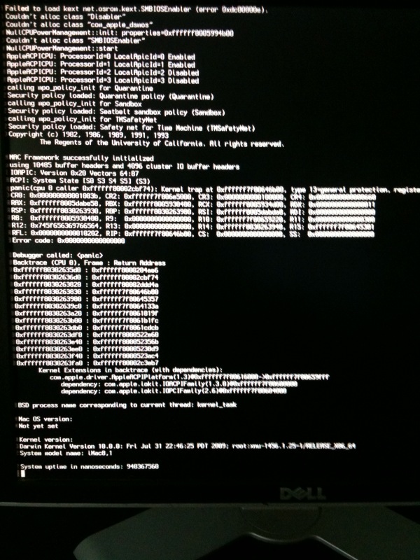

hashholly Posted September 6, 2009 Share Posted September 6, 2009 the extensions.mkext has some bad kexts in it. post your LSPCI please. Here you go, i wasnt sure how to create my own mkext for use for the snow leopard installer: Link to comment Share on other sites More sharing options...
noob766 Posted September 6, 2009 Author Share Posted September 6, 2009 Here you go, i wasnt sure how to create my own mkext for use for the snow leopard installer: just the needed kexts and GMA950.zip You can try without the GMA950 kexts if you have an external Monitor. Link to comment Share on other sites More sharing options...
hashholly Posted September 6, 2009 Share Posted September 6, 2009 just the needed kexts and GMA950.zip You can try without the GMA950 kexts if you have an external Monitor. Thanks. Deleted the mkext, and added those two kexts to the extensions folder and im still getting that same error as before, not sure why? Hmm seems like its also looking for some kext files not present: Link to comment Share on other sites More sharing options...

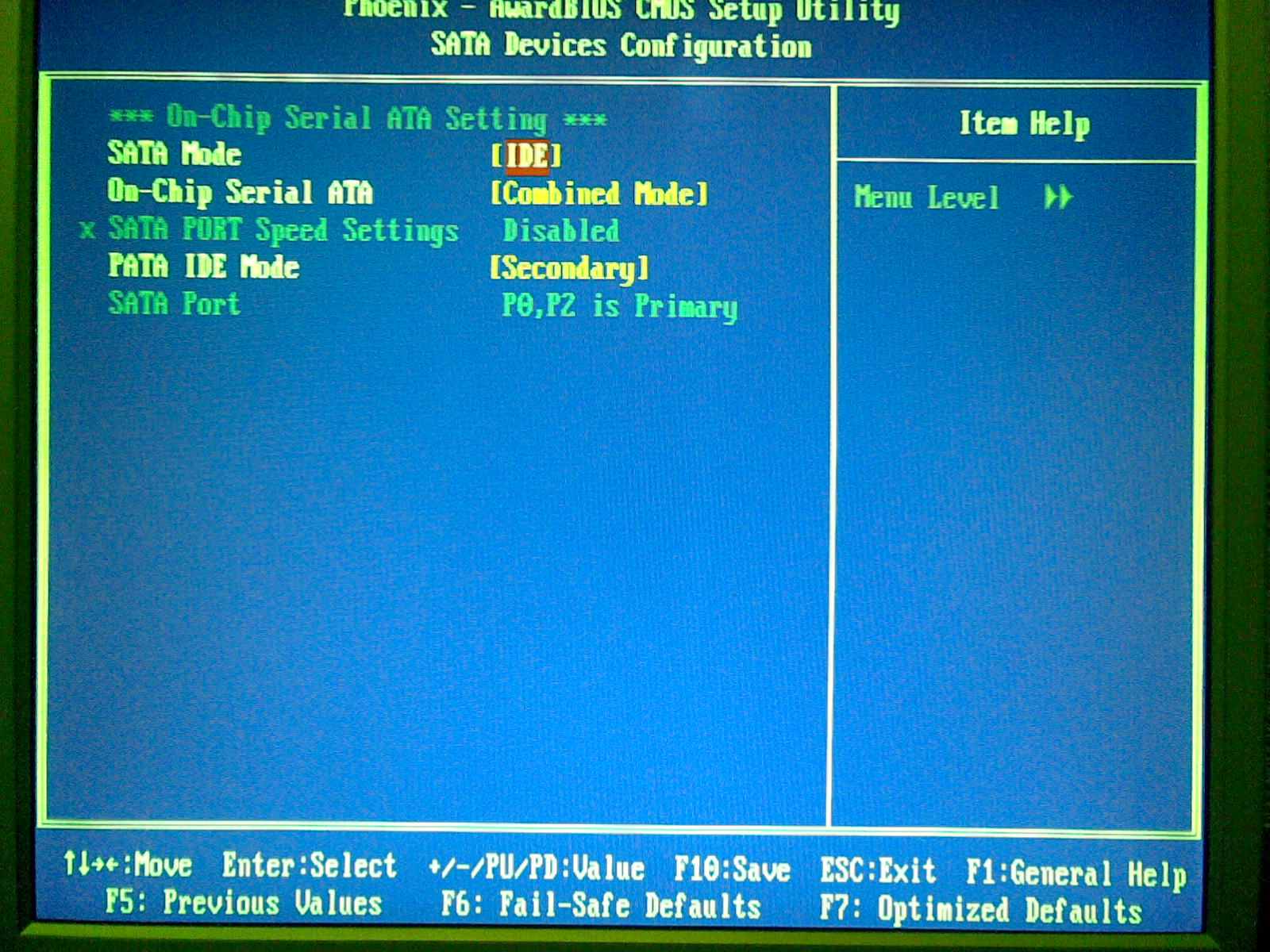

bas007 Posted September 6, 2009 Share Posted September 6, 2009 Thank you very much noob766! You deserve a beer. I got it all, managed to install it on pata drive (it is much easier on sata), graphic card works wit full hardware acceleration (used only EFI strings) erm except sound (forgot to put kext for that) And I have to see if my wireless netgear wg111v3 works with Snow Kitten. It was all in correct bios settings. -this motherboard is incredible complicated to setup -SATA must be set as IDE with COMBINED (if I didnt accidentally clicked that, I would have never figure it out) I will post a screenshot of those bios settings in case someone pops in with the same motherboard. One thing I also tried is Chameleon cdboot (boot132) for 10.6 and I can say it does not work at least not for my configuration. Constant rebooting... Link to comment Share on other sites More sharing options...

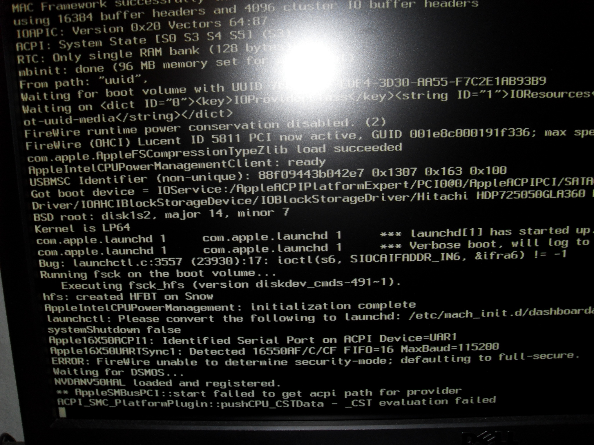

snifferpro Posted September 6, 2009 Share Posted September 6, 2009 I installed Sl using the Chameleon V2 RC1 USB Bootloader method and the install completed successfully. When I boot to my new SL volume I get the error shown in image. Any help or suggestions appreciated. Thanks Link to comment Share on other sites More sharing options...
noob766 Posted September 6, 2009 Author Share Posted September 6, 2009 I installed Sl using the Chameleon V2 RC1 USB Bootloader method and the install completed successfully. When I boot to my new SL volume I get the error shown in image. Any help or suggestions appreciated. Thanks You graphics card isn't working properly Thanks. Deleted the mkext, and added those two kexts to the extensions folder and im still getting that same error as before, not sure why? Hmm seems like its also looking for some kext files not present: set your bios to sata mode. Link to comment Share on other sites More sharing options...

snifferpro Posted September 6, 2009 Share Posted September 6, 2009 You graphics card isn't working properly set your bios to sata mode. Not sure which reply apples to me noob except that my bios is set to AHCI if that is what you mean. If it's my graphics card, is there a fix for it? Link to comment Share on other sites More sharing options...
noob766 Posted September 7, 2009 Author Share Posted September 7, 2009 Not sure which reply apples to me noob except that my bios is set to AHCI if thatis what you mean. If it's my graphics card, is there a fix for it? read the guide. Here is your efi string, add it to com.apple.boot.plist <key>device-properties</key> <string>cb0300000100000001000000bf0300001500000002010c00d041030a000000000101060000027 fff04003a000000400032002c0068007700730065006e0073006f0072002d0070006100720061006d 0073002d00760065007200730069006f006e000000080000000000000222000000400032002c00640 0650076006900630065005f0074007900700065000000120000004e5644412c6770752d64696f6465 0e0000004e00560050004d00000020000000010000000000000000000000000000000000000000000 000000000001e00000072006f006d002d007200650076006900730069006f006e0000000900000033 31373261100000004e00560043004100500000001800000004000000000003000c000000000000070 000000022000000400032002c002300730069007a0065002d00630065006c006c0073000000080000 000000000022000000400030002c006400650076006900630065005f00740079007000650000000b0 00000646973706c6179100000006d006f00640065006c0000001e0000004e5649444941204765466f 72636520393830302047542045464914000000400030002c006e0061006d0065000000120000004e5 644412c446973706c61792d4120000000400032002c0063006f006d00700061007400690062006c00 65000000160000004e5644412c73656e736f722d706172656e7414000000400031002c006e0061006 d0065000000120000004e5644412c446973706c61792d4212000000400032002c0072006500670000 0008000000000000021c0000006400650076006900630065005f00740079007000650000001000000 04e5644412c4765466f72636520000000400031002c0063006f006d00700061007400690062006c00 650000000e0000004e5644412c4e564d616326000000400032002c002300610064007200650073007 3002d00630065006c006c007300000008000000000000010e0000006e0061006d00650000000f0000 004e5644412c506172656e7422000000400031002c006400650076006900630065005f00740079007 000650000000b000000646973706c617920000000400030002c0063006f006d007000610074006900 62006c00650000000e0000004e5644412c4e564d6163220000005600520041004d002c0074006f007 40061006c00730069007a0065000000080000000000004036000000400032002c0068007700630074 0072006c002d0070006100720061006d0073002d00760065007200730069006f006e0000000800000 00000000214000000400032002c006e0061006d00650000001100000073656e736f722d706172656e 74</string> Link to comment Share on other sites More sharing options...

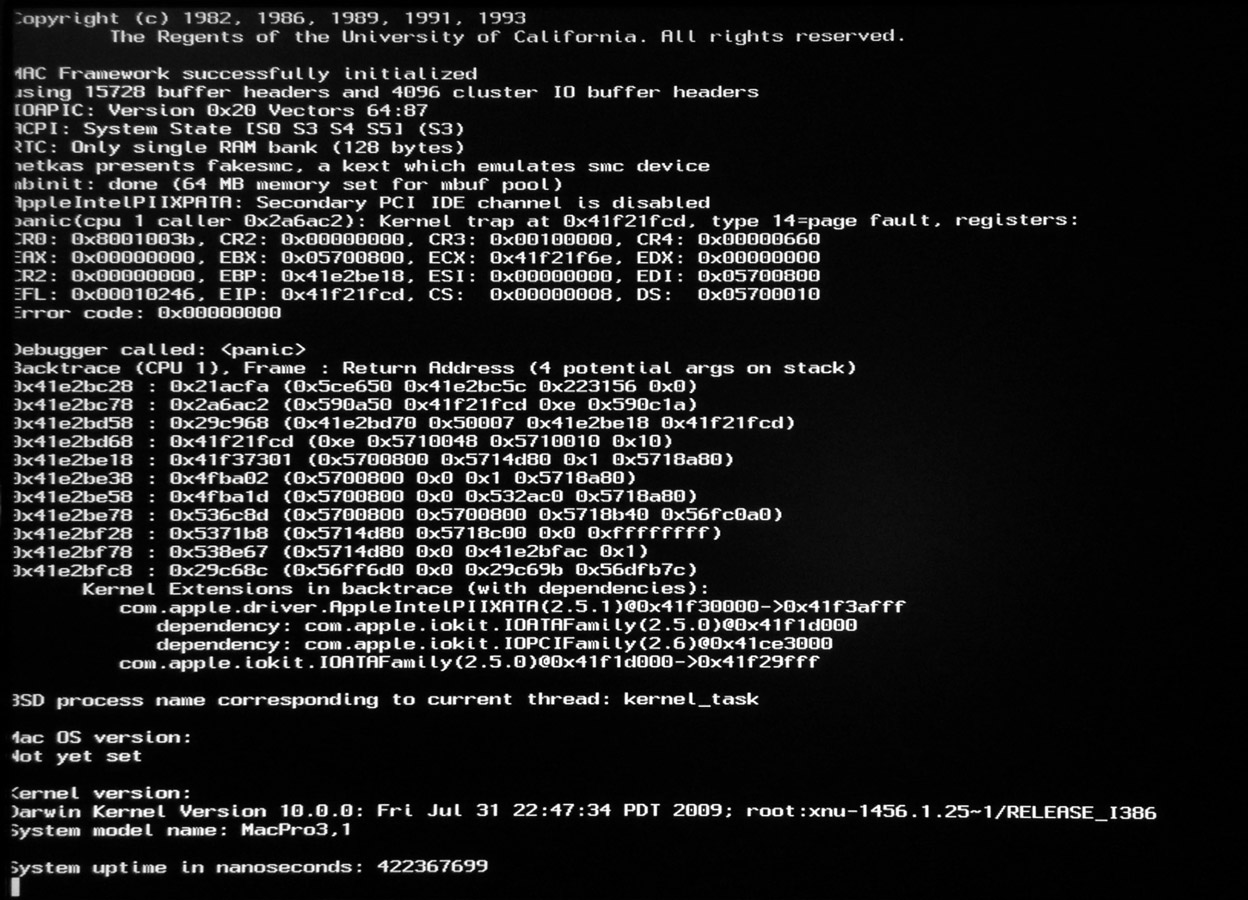

Squirrelf Posted September 7, 2009 Share Posted September 7, 2009 Hope you can help me please this is for a shuttle k45 GMA950 and ich7, E6600 in Leopard the minimum kext required to boot is ATAPortInjector, Disabler, dsmos, IOAHCIBlockStorageInjector so I tried to match that list of kext for Snow Leopard for SL I have fakesmc, NullCPUPowerManagement, openhaltrestart ,AppleIntelPIIATA, IOAHCIBlockStorageInjector.kext but I get the following KP during boot I know the dsdt works in Leo, it has a GMA950 fix for video, I just added the rtc fix this computer ran Leopard without trouble, using the retail dvd it also didn't need ahci mode, I can easily install Leo on ide or sata, now running a single sata drive... thanks Link to comment Share on other sites More sharing options...
noob766 Posted September 7, 2009 Author Share Posted September 7, 2009 Hope you can help me please I know the dsdt works in Leo, it has a GMA950 fix for video, I just added the rtc fix I had fakesmc, NullCPUPowerManagement, openhaltrestart : KP during boot I added AppleIntelPIIATA..., again a KP during boot this computer ran Leopard without trouble, using the retail dvd this computer also didn't need ahci mode, I cn easily instal Leo on ide or sata, now running a single sata drive the chip is an intel ich7 thanks Change the mode of your drives in your bios. if that doesn't work add the appleintelpixxata with dev id's add AHCIPortInjector.kext Link to comment Share on other sites More sharing options...
Squirrelf Posted September 7, 2009 Share Posted September 7, 2009 Change the mode of your drives in your bios.if that doesn't work add the appleintelpixxata with dev id's add AHCIPortInjector.kext well actually that bios doesn't have an option for sata ahci... I tried both appleintelpixxata, same KP with or without IOAHCIBlockStorageInjector same KP I tried AHCIPortInjectorwith and appleintelpixxata with dev id's: same KP I tried AHCIPortInjectorwith and appleintelpixxata with dev id's and IOAHCIBlockStorageInjector: same KP any ideas thanks Link to comment Share on other sites More sharing options...
noob766 Posted September 7, 2009 Author Share Posted September 7, 2009 well actually that bios doesn't have an option for sata ahci... I tried both appleintelpixxata, same KP with or without IOAHCIBlockStorageInjector same KP I'll try AHCIPortInjector now any ideas thanks well its definitely a problem with appleintelpixxata.kext. Link to comment Share on other sites More sharing options...
Squirrelf Posted September 7, 2009 Share Posted September 7, 2009 well its definitely a problem with appleintelpixxata.kext. what is appleintelpixxata related to ? Sata amd ATA drives ? Link to comment Share on other sites More sharing options...
noob766 Posted September 7, 2009 Author Share Posted September 7, 2009 what is appleintelpixxata related to ? Sata amd ATA drives ? yep. you shouldn't be having trouble on an ich7 though can you post your LSPCI? Link to comment Share on other sites More sharing options...

Squirrelf Posted September 7, 2009 Share Posted September 7, 2009 "If you want me to help you with what kexts you need, Download OSx86 Tools and click on View PCI Device/Vendor ID and post the output here." Sorry I should of added a tag line that the output is called an lspci ok I see now, thanks I'll do that right away 00:00.0 Host bridge [0600]: Intel Corporation 82945G/GZ/P/PL Memory Controller Hub [8086:2770] (rev 02) 00:02.0 VGA compatible controller [0300]: Intel Corporation 82945G/GZ Integrated Graphics Controller [8086:2772] (rev 02) 00:1b.0 Audio device [0403]: Intel Corporation 82801G (ICH7 Family) High Definition Audio Controller [8086:27d8] (rev 01) 00:1c.0 PCI bridge [0604]: Intel Corporation 82801G (ICH7 Family) PCI Express Port 1 [8086:27d0] (rev 01) 00:1c.1 PCI bridge [0604]: Intel Corporation 82801G (ICH7 Family) PCI Express Port 2 [8086:27d2] (rev 01) 00:1d.0 USB Controller [0c03]: Intel Corporation 82801G (ICH7 Family) USB UHCI Controller #1 [8086:27c8] (rev 01) 00:1d.1 USB Controller [0c03]: Intel Corporation 82801G (ICH7 Family) USB UHCI Controller #2 [8086:27c9] (rev 01) 00:1d.2 USB Controller [0c03]: Intel Corporation 82801G (ICH7 Family) USB UHCI Controller #3 [8086:27ca] (rev 01) 00:1d.3 USB Controller [0c03]: Intel Corporation 82801G (ICH7 Family) USB UHCI Controller #4 [8086:27cb] (rev 01) 00:1d.7 USB Controller [0c03]: Intel Corporation 82801G (ICH7 Family) USB2 EHCI Controller [8086:27cc] (rev 01) 00:1e.0 PCI bridge [0604]: Intel Corporation 82801 PCI Bridge [8086:244e] (rev e1) 00:1f.0 ISA bridge [0601]: Intel Corporation 82801GB/GR (ICH7 Family) LPC Interface Bridge [8086:27b8] (rev 01) 00:1f.1 IDE interface [0101]: Intel Corporation 82801G (ICH7 Family) IDE Controller [8086:27df] (rev 01) 00:1f.2 IDE interface [0101]: Intel Corporation 82801GB/GR/GH (ICH7 Family) SATA IDE Controller [8086:27c0] (rev 01) 00:1f.3 SMBus [0c05]: Intel Corporation 82801G (ICH7 Family) SMBus Controller [8086:27da] (rev 01) 02:00.0 Ethernet controller [0200]: Marvell Technology Group Ltd. 88E8056 PCI-E Gigabit Ethernet Controller [11ab:4364] (rev 12) Link to comment Share on other sites More sharing options...
noob766 Posted September 7, 2009 Author Share Posted September 7, 2009 ok I see now, thanks I'll do that right away 00:00.0 Host bridge [0600]: Intel Corporation 82945G/GZ/P/PL Memory Controller Hub [8086:2770] (rev 02) 00:02.0 VGA compatible controller [0300]: Intel Corporation 82945G/GZ Integrated Graphics Controller [8086:2772] (rev 02) 00:1b.0 Audio device [0403]: Intel Corporation 82801G (ICH7 Family) High Definition Audio Controller [8086:27d8] (rev 01) 00:1c.0 PCI bridge [0604]: Intel Corporation 82801G (ICH7 Family) PCI Express Port 1 [8086:27d0] (rev 01) 00:1c.1 PCI bridge [0604]: Intel Corporation 82801G (ICH7 Family) PCI Express Port 2 [8086:27d2] (rev 01) 00:1d.0 USB Controller [0c03]: Intel Corporation 82801G (ICH7 Family) USB UHCI Controller #1 [8086:27c8] (rev 01) 00:1d.1 USB Controller [0c03]: Intel Corporation 82801G (ICH7 Family) USB UHCI Controller #2 [8086:27c9] (rev 01) 00:1d.2 USB Controller [0c03]: Intel Corporation 82801G (ICH7 Family) USB UHCI Controller #3 [8086:27ca] (rev 01) 00:1d.3 USB Controller [0c03]: Intel Corporation 82801G (ICH7 Family) USB UHCI Controller #4 [8086:27cb] (rev 01) 00:1d.7 USB Controller [0c03]: Intel Corporation 82801G (ICH7 Family) USB2 EHCI Controller [8086:27cc] (rev 01) 00:1e.0 PCI bridge [0604]: Intel Corporation 82801 PCI Bridge [8086:244e] (rev e1) 00:1f.0 ISA bridge [0601]: Intel Corporation 82801GB/GR (ICH7 Family) LPC Interface Bridge [8086:27b8] (rev 01) 00:1f.1 IDE interface [0101]: Intel Corporation 82801G (ICH7 Family) IDE Controller [8086:27df] (rev 01) 00:1f.2 IDE interface [0101]: Intel Corporation 82801GB/GR/GH (ICH7 Family) SATA IDE Controller [8086:27c0] (rev 01) 00:1f.3 SMBus [0c05]: Intel Corporation 82801G (ICH7 Family) SMBus Controller [8086:27da] (rev 01) 02:00.0 Ethernet controller [0200]: Marvell Technology Group Ltd. 88E8056 PCI-E Gigabit Ethernet Controller [11ab:4364] (rev 12) ah i think i know the problem. try this kext AppleIntelPIIXATA.kext.zip its the same as the one before except it has boot on root. which might be why you were having issues, Link to comment Share on other sites More sharing options...
Squirrelf Posted September 7, 2009 Share Posted September 7, 2009 ah i think i know the problem. try this kextAppleIntelPIIXATA.kext.zip its the same as the one before except it has boot on root. which might be why you were having issues, no that didn't do it I had this new kext along with fakesmc, Nullcpupowermanagement and openhaltrestart , that's it (all these three have boot on Root) exact same KP Link to comment Share on other sites More sharing options...
noob766 Posted September 7, 2009 Author Share Posted September 7, 2009 no that didn't do it I had this new kext along with fakesmc, Nullcpupowermanagement and openhaltrestart , that's it exact same KP hmmmm. in you dsdt.aml you might have something in there to do with your hard drives that it doesn't like. try loading without it Link to comment Share on other sites More sharing options...
Squirrelf Posted September 7, 2009 Share Posted September 7, 2009 hmmmm. in you dsdt.aml you might have something in there to do with your hard drives that it doesn't like. try loading without it without the dsdt I have the same KP again Link to comment Share on other sites More sharing options...
noob766 Posted September 7, 2009 Author Share Posted September 7, 2009 without the dsdt I have the same KP again there is no reason for you to be getting this error, which is strange all i can guess is that go through your bios again and see if you can change the set up. or take your IOATAFamily.kext from leopard and use that. Link to comment Share on other sites More sharing options...
