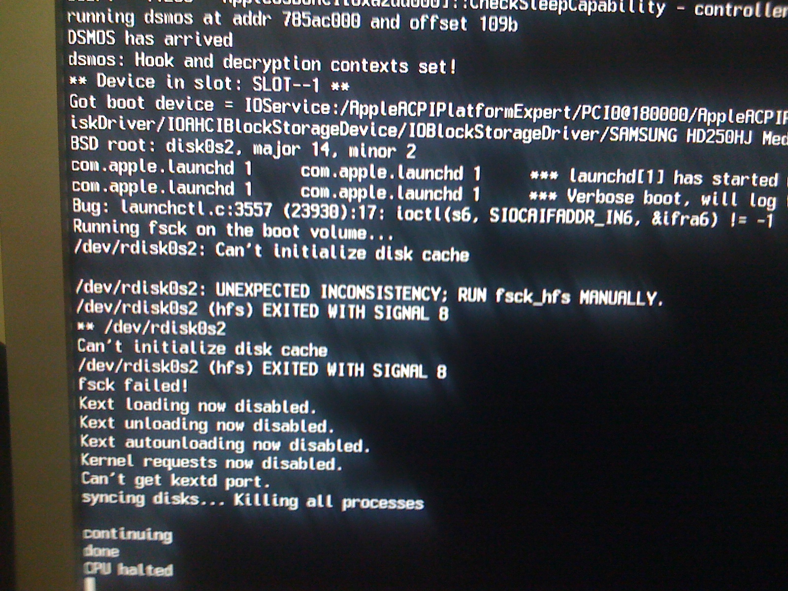

majinvegeta Posted September 7, 2009 Share Posted September 7, 2009 I'm getting this "can't initialize disk cache" than shutdown... any help please? Link to comment https://www.insanelymac.com/forum/topic/181876-amd-installing-snow-leopard-10a432-on-amd-system/page/4/#findComment-1256388 Share on other sites More sharing options...
majinvegeta Posted September 8, 2009 Share Posted September 8, 2009 This is the screenshot of my problem.. then pc shutdown.. someone can help me on this? Thanks Link to comment https://www.insanelymac.com/forum/topic/181876-amd-installing-snow-leopard-10a432-on-amd-system/page/4/#findComment-1256843 Share on other sites More sharing options...
andrewq2 Posted September 8, 2009 Share Posted September 8, 2009 This is the screenshot of my problem.. then pc shutdown.. someone can help me on this? Thanks looks like an disk error if possible go into leopard and verify disk/permissions Link to comment https://www.insanelymac.com/forum/topic/181876-amd-installing-snow-leopard-10a432-on-amd-system/page/4/#findComment-1256969 Share on other sites More sharing options...

gorg Posted September 8, 2009 Share Posted September 8, 2009 NoGo on an Asus M2A32-MVP.Hi - did the installation on a clean disk (with chameleon RC2.640, replaced "boot", and test7-kernel). Very early I get: **/dev/rdisk0s3 Can't initialize disk cache /dev/rdisk0s3 (hfs) EXITED WITH SIGNAL 8 I get the same error when I boot into single user and do a "fsck". Mobo: Asus M2A32-MVP de luxe (SB600) 10.5.6 is running fine here..... any idea - apart from "switch to Intel" (which I might do sooner or later..) G.H. I get "Can't initialize disk cache" and "EXITED WITH SIGNAL 8" when booting with "-s -x32". Same motherboard. You can google around only to arrive to this thread. No answers here either (yet). Link to comment https://www.insanelymac.com/forum/topic/181876-amd-installing-snow-leopard-10a432-on-amd-system/page/4/#findComment-1257856 Share on other sites More sharing options...
mnfesq Posted September 9, 2009 Share Posted September 9, 2009 well i just force compiled it and going to try booting again I ended up deleting my dsdt.aml file and Snow booted up. Now that I have Snow running, I'll try to create a dsdt.aml file within Snow. My system just halts at AppleIntelCPUPowerManagement timed out no matter what I try. Tried different kexts and have put my patched dsdt.aml in the root of my drive but all I get is that god damn time out. And no, it does not boot in to Snow after a couple of minutes, it just halts right there. Try deleting your dsdt.aml file and see if it will boot. Mine did. Mine was hanging just like yours and it turned out it was the dsdt.aml file I had force compiled. Link to comment https://www.insanelymac.com/forum/topic/181876-amd-installing-snow-leopard-10a432-on-amd-system/page/4/#findComment-1258220 Share on other sites More sharing options...
majinvegeta Posted September 9, 2009 Share Posted September 9, 2009 I get "Can't initialize disk cache" and "EXITED WITH SIGNAL 8" when booting with "-s -x32". Same motherboard. You can google around only to arrive to this thread. No answers here either (yet). try to start in maxmem=1024 or maxmem=2048 and see. Link to comment https://www.insanelymac.com/forum/topic/181876-amd-installing-snow-leopard-10a432-on-amd-system/page/4/#findComment-1258515 Share on other sites More sharing options...
virtudude Posted September 10, 2009 Share Posted September 10, 2009 try to start in maxmem=1024 or maxmem=2048 and see. Weird. This fixed it for me. What's the bug this is a workaround for? I have 8GBs of RAM. Is that too much? :-) Link to comment https://www.insanelymac.com/forum/topic/181876-amd-installing-snow-leopard-10a432-on-amd-system/page/4/#findComment-1259580 Share on other sites More sharing options...
majinvegeta Posted September 10, 2009 Share Posted September 10, 2009 it's a problem trusting over 4gb ram. you can set manually the maxmem flag step by step 1024 - 2048 - 3072 ecc ecc as soon as the error return for adjust your sistem at maximum stable performance. Example I've 6gb and run at 5gb ... better than nothing Link to comment https://www.insanelymac.com/forum/topic/181876-amd-installing-snow-leopard-10a432-on-amd-system/page/4/#findComment-1259771 Share on other sites More sharing options...
