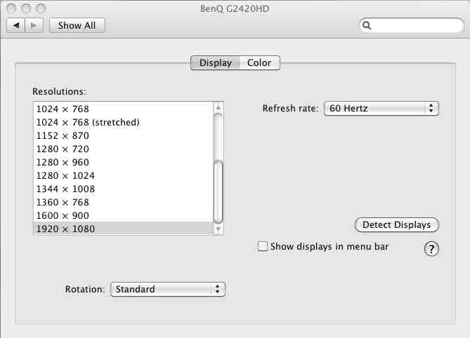

X!N Posted March 13, 2010 Share Posted March 13, 2010 Ok I too am trying to get my Powercolor HD4850 running in SL 10.6.2 <string>"Graphics Mode"="1920x1080x32"</string> This I think should be: <key>Graphics Mode</key> <string>1280x1024x32</string> I could be wrong as I'm new to all this anyway but it may work for you. Different systems and all that. I found a workaround for installing Logic 9 which is why I needed QI/CE recognised in the first place. I still don't have QI/CE working but it don't matter as long as I can make music. Now the only hassle I have is having to type in "Graphics Mode"="1280x1024x32" at every boot. Edit: Looks like I had a small typo and it now boots at 1280x1024. Make sure you leave a gap between "Graphics Mode" My com.apple.boot.plist : <key>EthernetBuiltIn</key> <string>y</string> <key>GraphicsEnabler</key> <string>y</string> <key>Graphics Mode</key> <string>1280x1024x32</string> <key>Kernel</key> <string>chocolate_kernel</string> <key>PciRoot</key> <string>1</string> <key>Timeout</key> <string>5</string> Link to comment https://www.insanelymac.com/forum/topic/181405-how-to-ati-4850-working-on-sl/page/7/#findComment-1428220 Share on other sites More sharing options...
Richdave Posted March 14, 2010 Share Posted March 14, 2010 This I think should be: <key>Graphics Mode</key> <string>1280x1024x32</string> I could be wrong as I'm new to all this anyway but it may work for you. Different systems and all that. I found a workaround for installing Logic 9 which is why I needed QI/CE recognised in the first place. I still don't have QI/CE working but it don't matter as long as I can make music. Now the only hassle I have is having to type in "Graphics Mode"="1280x1024x32" at every boot. Edit: Looks like I had a small typo and it now boots at 1280x1024. Make sure you leave a gap between "Graphics Mode" My com.apple.boot.plist : <key>EthernetBuiltIn</key> <string>y</string> <key>GraphicsEnabler</key> <string>y</string> <key>Graphics Mode</key> <string>1280x1024x32</string> <key>Kernel</key> <string>chocolate_kernel</string> <key>PciRoot</key> <string>1</string> <key>Timeout</key> <string>5</string> IIRC either format "should" work but there have been reports of success either method but not necessarily both on a specific system. I removed the string from my plist and now my Chameleon boot screen is at a lower default res so it was at least setting the res for the chameleon boot screen... Just curious, What is the "chocolate_kernel" string for? and also the PciRoot key and string? BTW I am using the top (furthermost from mobo) DVI o/p via a DVI>VGA adaptor. My Screen has DVI in but I run a KVM box that only supports VGA. I'll test direct DVI out and also see what if any o/p I get from the second (lower) o/p Oh and I can confirm QI/CE is functional as I have the transparent menu bar (or what ever Mac call it) and I get the funky ripple effect when I add a widget to the dashboard Link to comment https://www.insanelymac.com/forum/topic/181405-how-to-ati-4850-working-on-sl/page/7/#findComment-1428428 Share on other sites More sharing options...

Richdave Posted March 19, 2010 Share Posted March 19, 2010 Hi, Richdave, did you ever try to launch iMovie? I have a PowerColor HD4850 too. I followed your procedure and got working screen res. as yours. Except one thing, when I launched iMovie, I got an error that indicated my card lacked QE support. What a pity.... been away so sorry for late reply. I'll check this and post result Link to comment https://www.insanelymac.com/forum/topic/181405-how-to-ati-4850-working-on-sl/page/7/#findComment-1431502 Share on other sites More sharing options...
Richdave Posted March 20, 2010 Share Posted March 20, 2010 I don't seem to have iMovie installed?? is this parts of a standard install or is it an option at installation? I did not install ANY extras when I installed my SL. Never mind... it's an additional software suite that I don't own... Link to comment https://www.insanelymac.com/forum/topic/181405-how-to-ati-4850-working-on-sl/page/7/#findComment-1431849 Share on other sites More sharing options...
