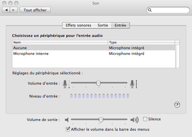

Boombeng Posted November 9, 2009 Share Posted November 9, 2009 Let me know if you guys figure out gain control for the mics. Hard issue, it seems related to MuteGPIO missing under mic in Layouts but i'm not sure , I cant' figure out which value to put. When I try wrong value all the input and ouputs are broken. And thx for bluetooth pkg cheers Link to comment https://www.insanelymac.com/forum/topic/181293-dell-xps-1340-under-osx-106-including-boot-132-install-cd/page/13/#findComment-1324486 Share on other sites More sharing options...
bcc9 Posted November 9, 2009 Author Share Posted November 9, 2009 Hard issue, it seems related to MuteGPIO missing under mic in Layouts but i'm not sure , I cant' figure out which value to put. When I try wrong value all the input and ouputs are broken.Yes, I tried the config changes that seemed to be working with other platforms but couldn't get anything working, and also never got the analog mic-in jack to work with applehda either. And thx for bluetooth pkgThanks, I'm starting to get down the under-documented & quirky OSX packaging system Should save some newbie questions.Maybe you could update post #1 in the bluetooth thread to point to the package as the preferred solution. Newbies are still asking about sleepwatcher which should be unnecessary if only they were using the kext. Link to comment https://www.insanelymac.com/forum/topic/181293-dell-xps-1340-under-osx-106-including-boot-132-install-cd/page/13/#findComment-1324853 Share on other sites More sharing options...

Boombeng Posted November 10, 2009 Share Posted November 10, 2009 Yes, I tried the config changes that seemed to be working with other platforms but couldn't get anything working, and also never got the analog mic-in jack to work with applehda either. In the old patched applehda the anlog Mic in worked with Nodes 26 32 29 41 14 in pathmap, but when I try to put this nodes in the legacy it doesn't work, even if a second mic device appears in sound PrefPan... and what is interesting with this new device = it has gain controle. So I guess Mic Gain controle is related to Nodes 29 41 cause the Internal Mic uses only 3 nodes 27 33 19 In linux codec dump we can see : 27 33 = Audio Input + Audio selector 26 32 = idem 14 = Pin complex 19 = idem 29 41 = Mixer + Audio selector When I try to use 29 41 nodes with those related to Internal mic (26 32 29 41 19 or other trials mixing nodes) it doesn't work Also what I noticed in Codec Dump = Node 29 has a connection with nodes 40 41 42 43 and 18 so it uses node 41 connection because Node 41 has a connection with node 14 but any of 5 nodes connected to 29 has a connection with Node 19 = maybe a missing connection is the cause of lack of gain controle for Internal Mic (?) I also tried this with several changes for node 19 verbs like Port and location but no go [Edit] I also tried all this after adding ExtMic in Layout and under Inputs in layout Thanks, I'm starting to get down the under-documented & quirky OSX packaging system Should save some newbie questions.Maybe you could update post #1 in the bluetooth thread to point to the package as the preferred solution. Newbies are still asking about sleepwatcher which should be unnecessary if only they were using the kext. Done cheers Link to comment https://www.insanelymac.com/forum/topic/181293-dell-xps-1340-under-osx-106-including-boot-132-install-cd/page/13/#findComment-1325476 Share on other sites More sharing options...
