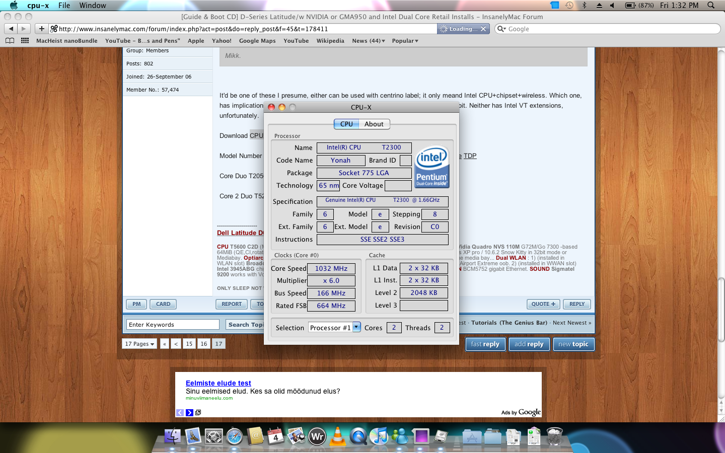

consolation Posted December 4, 2009 Share Posted December 4, 2009 Hello, youtube HD and Vimeo HD lagging like hell...even in quartz enabled mode.Also, has anyone gotten the mic input or onboard mic to work? Mikk. I have no issues with playback all the way to 720p I get a very occasional skip at 1080p, T5600 C2D @1.8GHz. Mikk are you sure you have a C2D? The model T250 in your profile doesn't exist, but T2*** are all CDs. Link to comment Share on other sites More sharing options...
Mikkp Posted December 4, 2009 Share Posted December 4, 2009 Im pretty sure that i have a C2D but i got the T250 from my windows 7 profiler. It might be wrong about the make tho but im sure it is a C2D @ 1.63 GHz. I even have a sticker on that says "Inter Centrino Duo" Mikk. Link to comment Share on other sites More sharing options...
mac-es Posted December 4, 2009 Share Posted December 4, 2009 Im pretty sure that i have a C2D but i got the T250 from my windows 7 profiler. It might be wrong about the make tho but im sure it is a C2D @ 1.63 GHz. I even have a sticker on that says "Inter Centrino Duo" Mikk. Seems that you have a Core Duo, not Core 2 Duo. Link to comment Share on other sites More sharing options...
consolation Posted December 4, 2009 Share Posted December 4, 2009 Im pretty sure that i have a C2D but i got the T250 from my windows 7 profiler. It might be wrong about the make tho but im sure it is a C2D @ 1.63 GHz. I even have a sticker on that says "Inter Centrino Duo" Mikk. It'd be one of these I presume, either can be used with centrino label; it only meand Intel CPU+chipset+wireless. Which one, has implications on the type of power management used and your ability to run 64bit. Neither has Intel VT extensions, unfortunately. Download CPUX (osx) or CPUZ (win) to get your cpu easily identified. Model Number sSpec Number(s) Frequency L2-Cache Front Side Bus Mult Voltage TDP Core Duo T2050 SL9BN 1.6 GHz 2 MiB 533 MT/s 12x 0.762 - 1.3 V 31 W Core 2 Duo T5200 SL9VP (B2) 1.6 GHz 2 MB 533 MT/s 12x 1.0375 - 1.3 V 34 W Link to comment Share on other sites More sharing options...
Mikkp Posted December 4, 2009 Share Posted December 4, 2009 Neither, its a T2300 Dual Core. Running at 1.66 GHz. Mikk. Link to comment Share on other sites More sharing options...

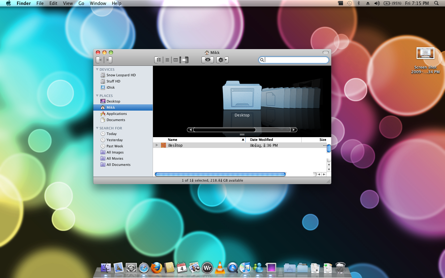

Mikkp Posted December 4, 2009 Share Posted December 4, 2009 Mayor artifacting going on with the New com.apple.boot.plis file. Also Youtube HD and Vimeo HD lagg like hell for some odd reason, probably going to reinstall Snow. Link to comment Share on other sites More sharing options...
consolation Posted December 4, 2009 Share Posted December 4, 2009 On the up side, you've got VT extensions; but the artefacting is weird. I'd download the new fakeblahblah kext of netkas' site and set up iStat or Temp monitor to keep an eye on your temperatures. Are you sure you have the string set up correctly? The fact that it's a CD not C2D, could explain some skipping. BUT, the CD HP that I setup using this method has no major issues, except for 1080p - where it skips like buggery. Link to comment Share on other sites More sharing options...

Mikkp Posted December 4, 2009 Share Posted December 4, 2009 On the up side, you've got VT extensions; but the artefacting is weird. I'd download the new fakeblahblah kext of netkas' site and set up iStat or Temp monitor to keep an eye on your temperatures. Are you sure you have the string set up correctly? The fact that it's a CD not C2D, could explain some skipping. BUT, the CD HP that I setup using this method has no major issues, except for 1080p - where it skips like buggery. Now i see, didn't know there was a Core Duo and a Core 2 Duo. That might really explain why im not getting the most power out of my computer as i want to. Mikk. Link to comment Share on other sites More sharing options...
leppy700m Posted December 5, 2009 Author Share Posted December 5, 2009 Now i see, didn't know there was a Core Duo and a Core 2 Duo. That might really explain why im not getting the most power out of my computer as i want to. Mikk. The cpu is upgradeable, if you can find a compatible one. On the up side, you've got VT extensions; but the artefacting is weird. I'd download the new fakeblahblah kext of netkas' site and set up iStat or Temp monitor to keep an eye on your temperatures. Are you sure you have the string set up correctly? The fact that it's a CD not C2D, could explain some skipping. BUT, the CD HP that I setup using this method has no major issues, except for 1080p - where it skips like buggery. That was a good catch about the CPU. Also, it doesn't help that the video ram in OS X on any D620 is limited to 64 mb. Link to comment Share on other sites More sharing options...
